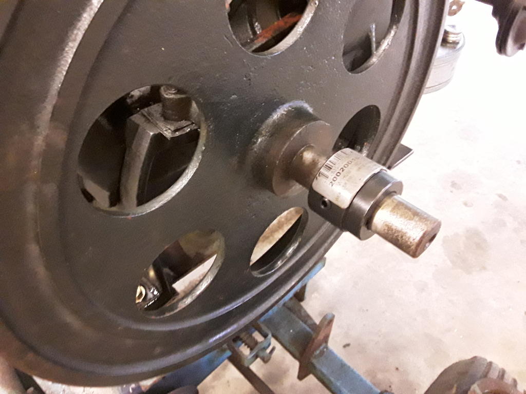

Machineguy
@mhlmeader
You might try 50/50 Acetone and Trans fluid to loosen it. I’ve found this mixture in a spray bottle far better than over the counter penetrating oils. Patience is a key with it though.
AN oxy/acytlyene rosebud would put enough heat with the gear puller. That’s just not a tool most have though. Could be worth taking the Stover to a shop with those capabilities just for that.

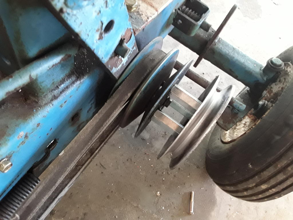

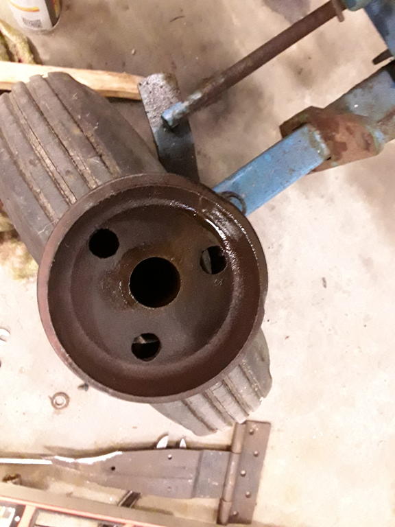

mhlmeader

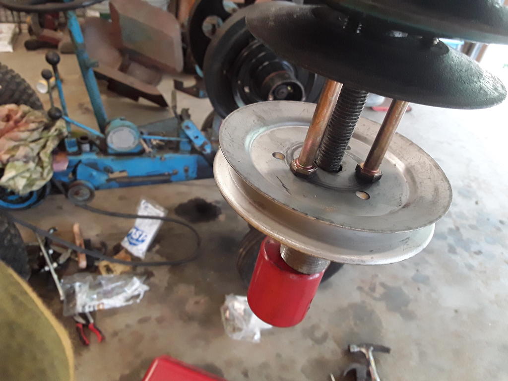

Bolt a v belt pulley to the belt pulley....slide it on, and be done........
This is one of those weld a pulley deals....i dont need the center part, but got it anyway to help line up my holes i drilled....
The 1/2 " bolts are way overkill, but were the size already in the belt pulley....so i figured using that size bolt would help in getting it centered up a hillbilly possible.  There is a little bit of outta center wobble in it, when i ran the engine....but not terrible, certainly workable.....i think......i hope
End result was i had approx a 2" difference in alignment between the pulleys i have to belt up.....planning on getting about a 4" pulley, and bolting it up to the existing, using some spacers as necessary....jesus take the wheel, and the creek dont rise....i think that might work....i hope that might work.

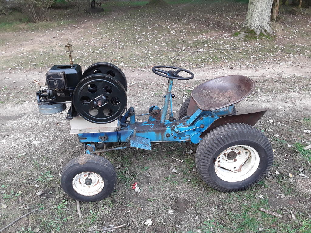

Just a small isue, i think i saw:
In you last video, it seems to me, that the engine rotating is counterclockwise.
as far as i know, the kohler engines run in clockwise rotation.
Maybe there is an idea, to rotate the engine itself at 180 deg. The right sided shaft looks much smaller (flat).
also the rotation runs then right.
no doubt about it will be working, with reversal shifting, if it is an mechanic gear as far as i see.
Additionally you have it easier by adapting a pulley.
but i am not sure, if i see it right in the video.
Regards

  Thanks Stefan.
Yes, the kohlers turn clockwise, fortunately so does the Stover...it can be misleading sometimes, cause after they "hit" and start to slow down, they can appear to be spinning the opposite direction.
And adapting a pulley has turned out to be waaaaay easier.  :)

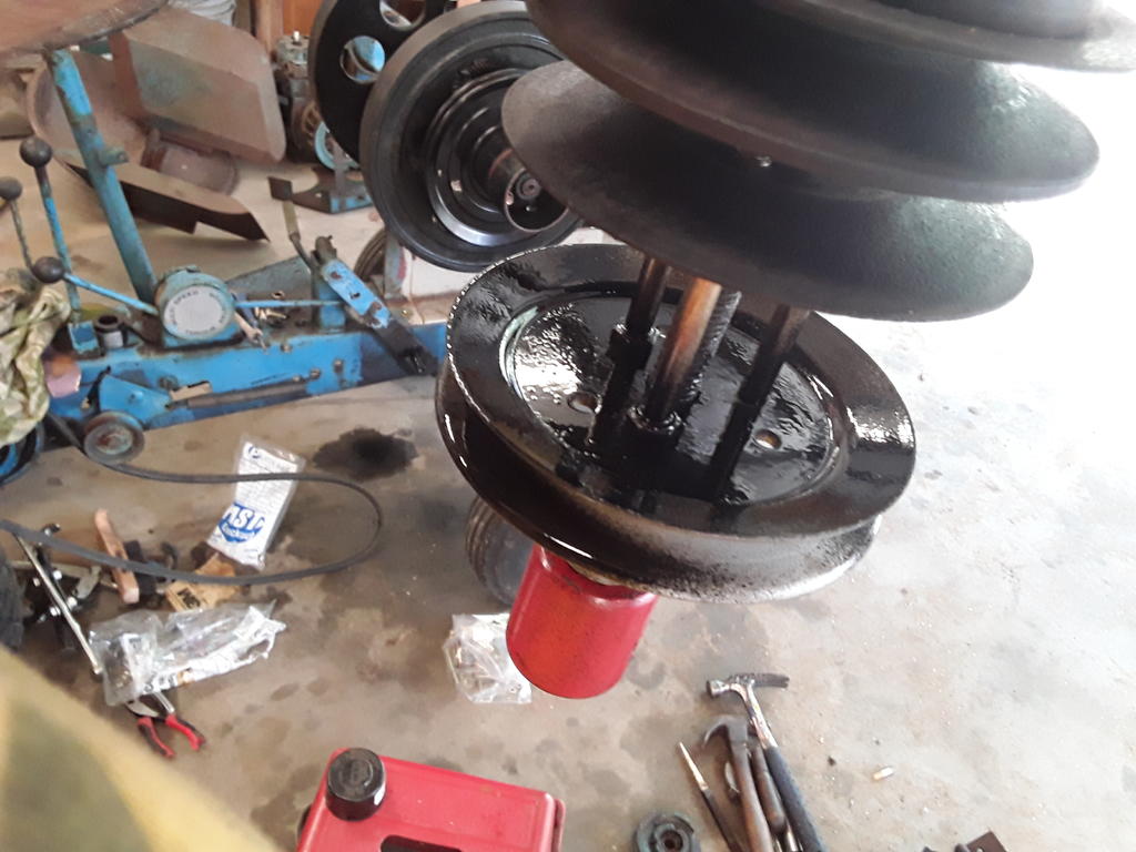

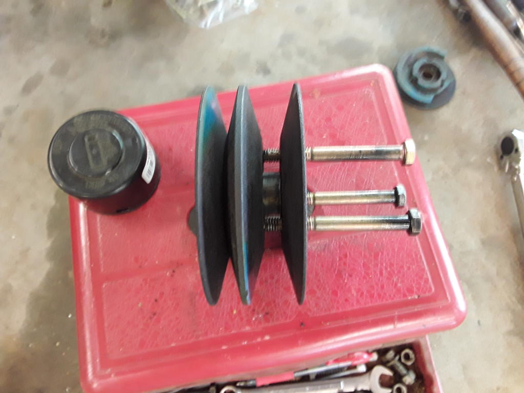

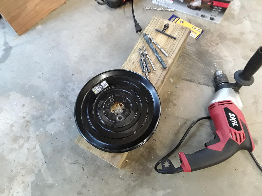

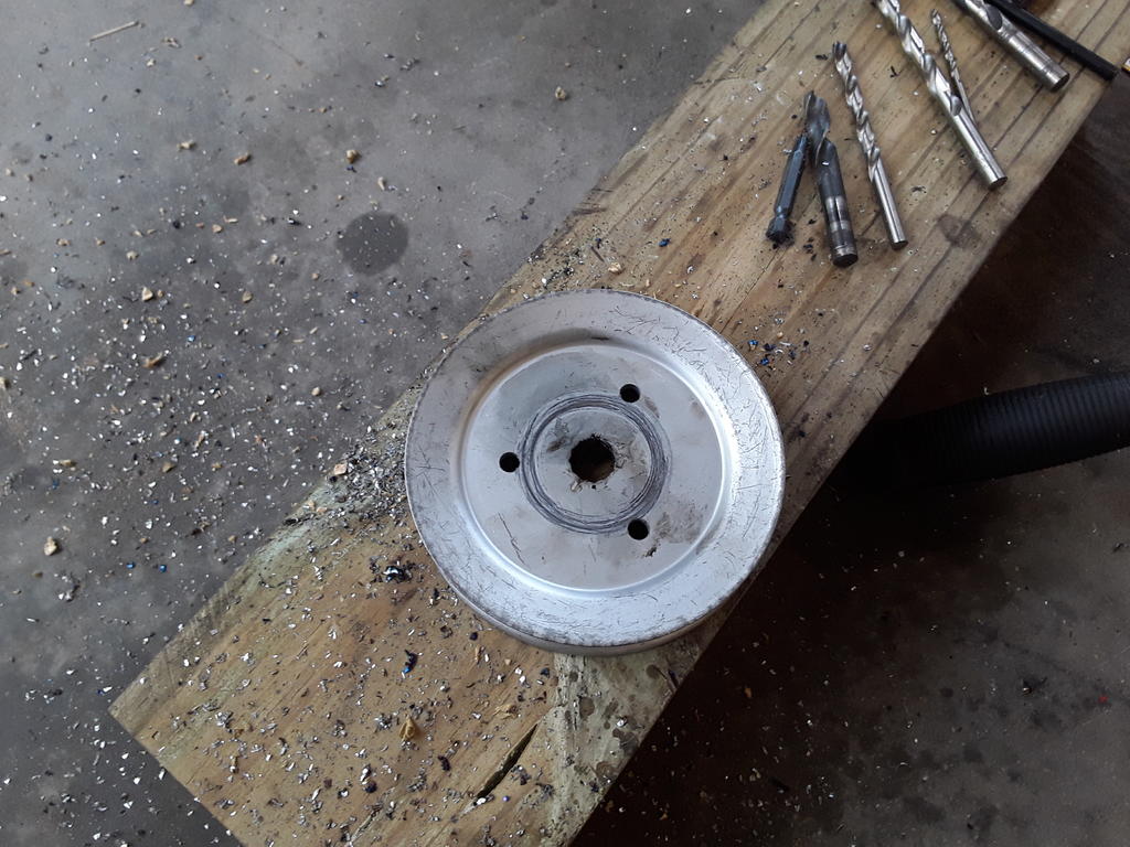

mhlmeader

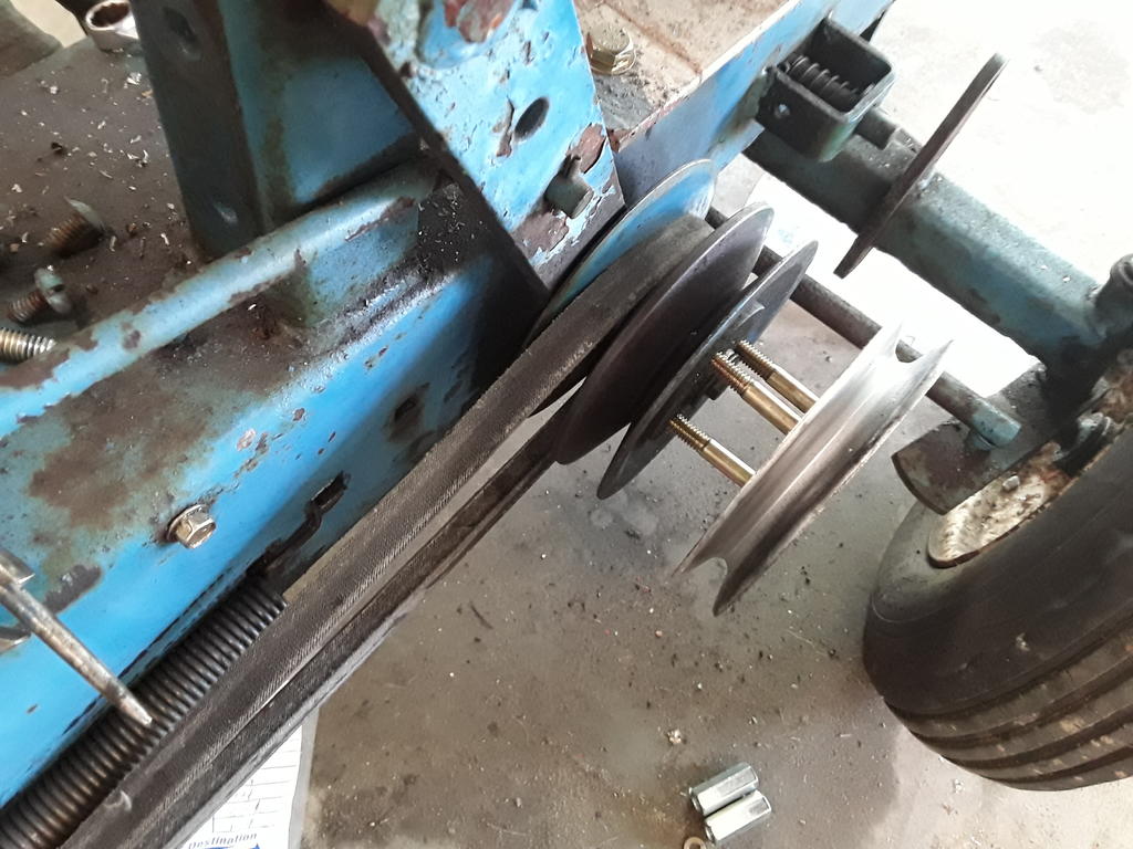

Ok....sooooo i "engineered"  my clutch pulley.....
Got a 5" pulley from my local small engine shop, i wanted a 4 ".. but all he had was 5....looked good and stout to drill some holes in, so i went with it.
Put my bolts in existing pulley, and was trying to figure out how to transfer bolt hole alignment from one to the other......it aint rocket science, and im suuuuure there had to be an easier way but i did it this way.....
First got cheapo bead buster from corner, just happens to be approx same size bore of the pulleys.......
Set the pulley i needed to drill holes in on top, and rotated it around the heads of the bolts, scratching a circle into the pulley.......

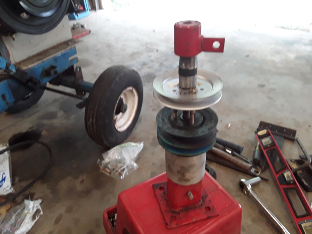

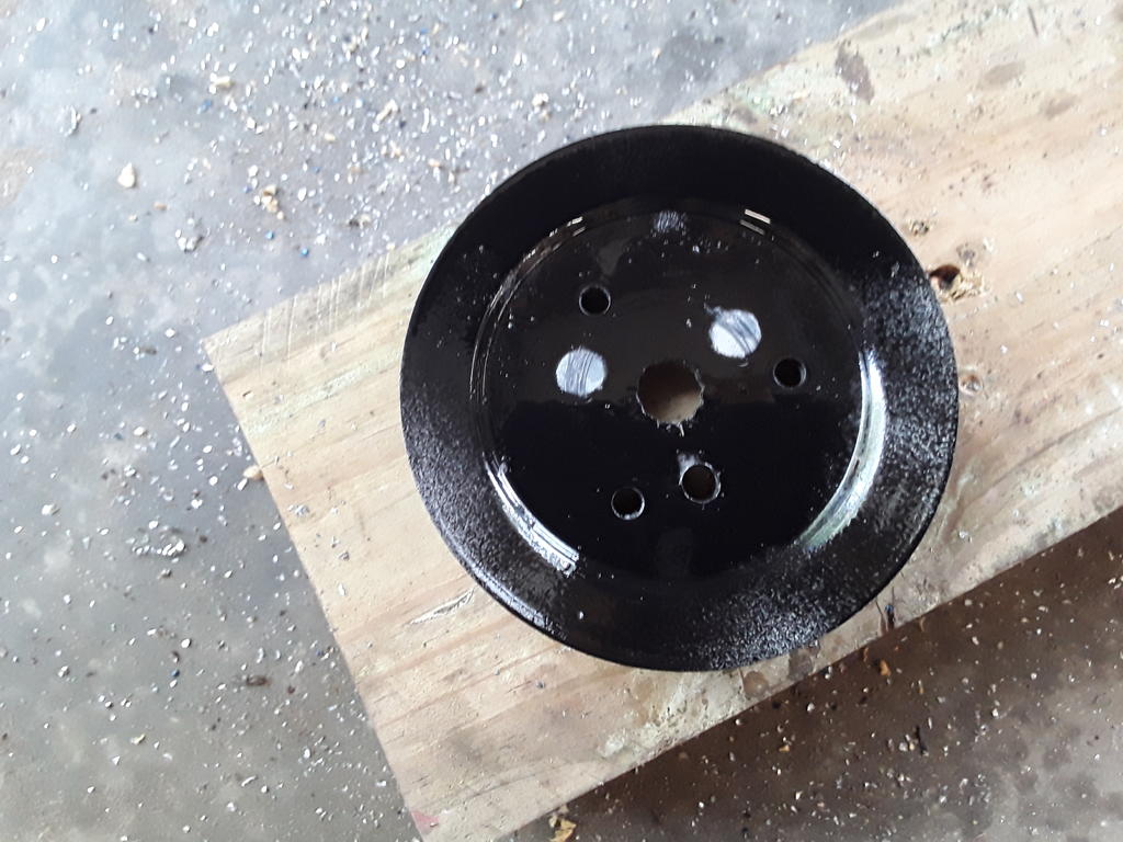

mhlmeader
After i got the circle scribed in, i picked one spot to drill, basically in the center of the little band .   I did not drill dead nuts between two existing holes...just incase my alignment was waaaay off and i had to DO OVER...LOL, i wanted to leave a second chance location...  sorry forgot to take a pictire of that....
After i drilled one hole, my intention was to install one bolt, let the pulley sit on the other two, reach underneath with a sharpie marker and trace the other two bolts....figured that was fool proof.....but it wasnt....way too hard to acurately trace the bolt heads....looked like crayola crayon .......tooooooo slllooopppppy......

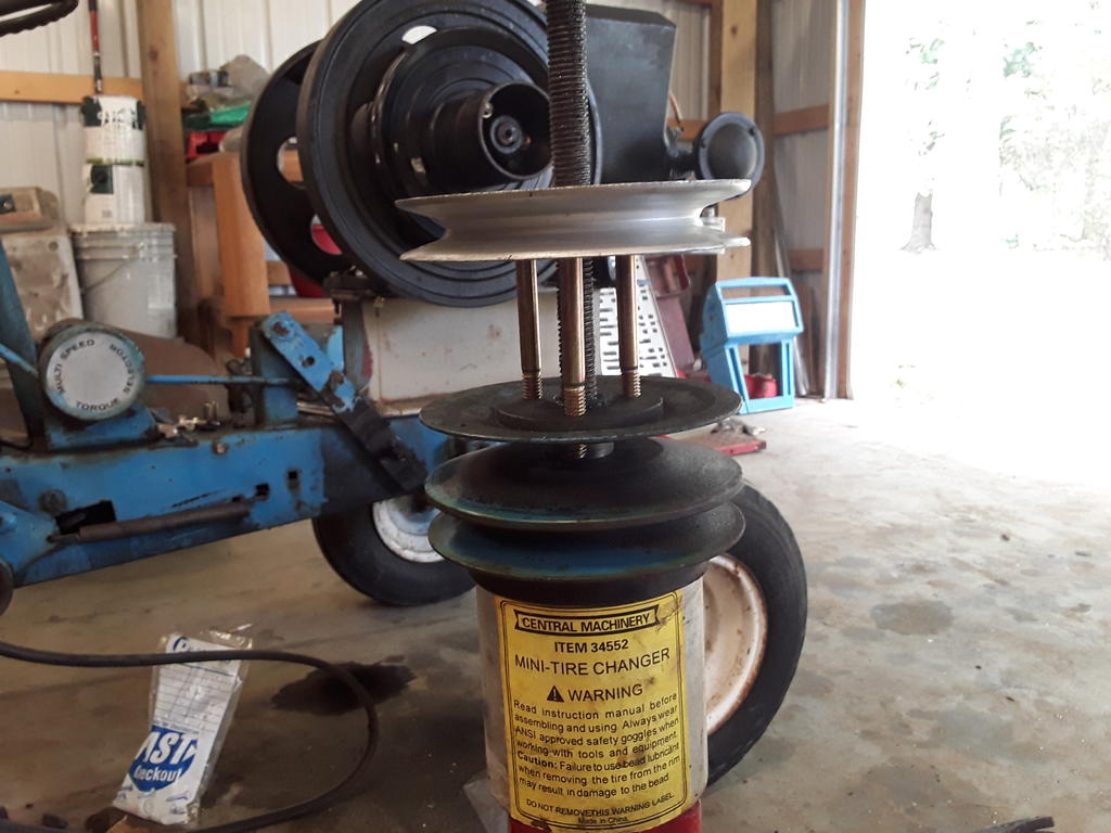

Soooooo, i grabbed the other bits and pieces of the bead buster and put it together like so......
mhlmeader
While taking into consideration of windage and dew point.....i painted the one side of the pulley......
X marks the spot, or something like that......wish i had thought of it in the first place

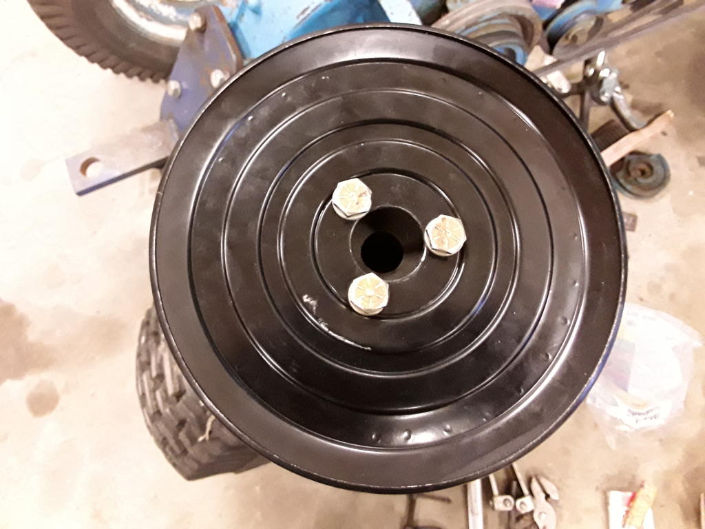

mhlmeader
Dry fit....was a litttle tight, so i did wobble out my holes just a tad bit for a liithe more play....

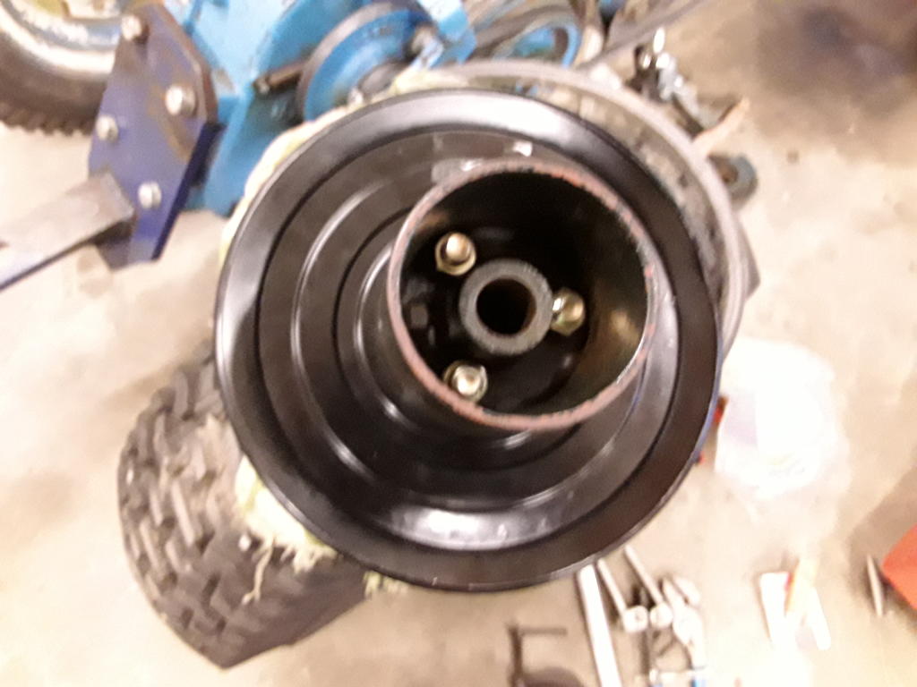

mhlmeader

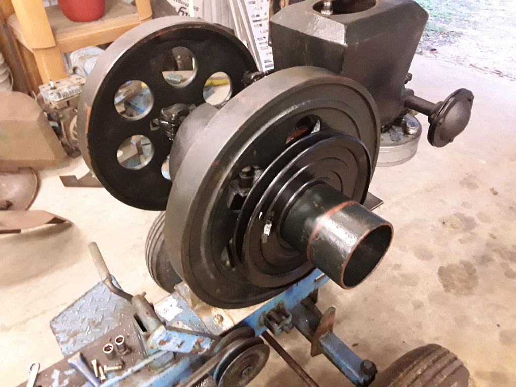

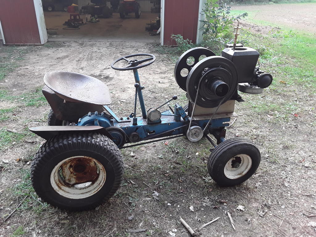

Final widget.....i looked high and low for a ridgid conduit coupling or small scrap piece of rigig conduit, black pipe to use as a spacer....it had to be aprox 2 1/2 outside diameter to go past the lip of the original pulley, no supply houses or lowes had that size instock.....ended up using rod couplings to slip over the bolts....lined up the pulleys good enough...
mhlmeader
Belted up.....
