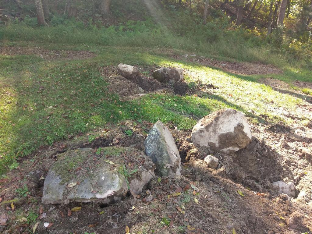

WVHillbilly520H 10,379 #10 Posted October 3, 2018 1 hour ago, pullstart said: I typically find a good patch of stones, and let them true themselves up.... Sounds like back home in WV I whooped a bunch o' blades back then...pics from last weekend I loosened them up with the Kioti and FEL instead of your method Kevin 1 1 Share this post Link to post Share on other sites
stevasaurus 23,857 #11 Posted October 3, 2018 I use the 4" grinder and a long heavy file with the blade in a vise. As for balancing, I hang them on a 16 penny nail. Share this post Link to post Share on other sites
Pullstart 71,382 #12 Posted October 3, 2018 You got stones alright... 2 Share this post Link to post Share on other sites
Tractorhead 9,217 #13 Posted October 3, 2018 @wvhillbilly520H looklike you have some "rolling stones" sorry... a small angle grinder with an 80 flap disc to sharpen in vice and a simple a nail for centering. if blades has light rips or damages (Impacts more as 1mm) - just exchange, no mess... I Think about, to rework my mower Deck with Butterfly knifes with quick changable blades... like the drum blades on huger Drum mower Systems. Ended to bottom with a Slip plate as cup-spring. 1 Share this post Link to post Share on other sites
