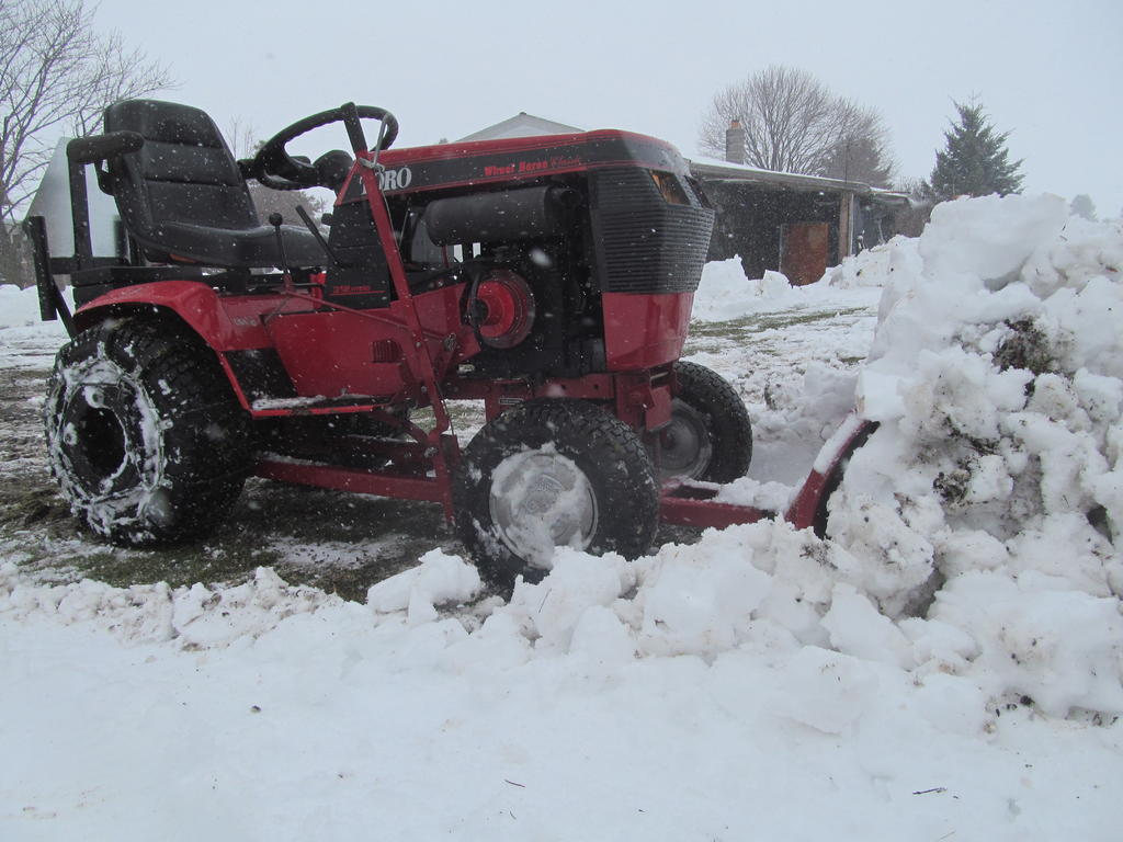

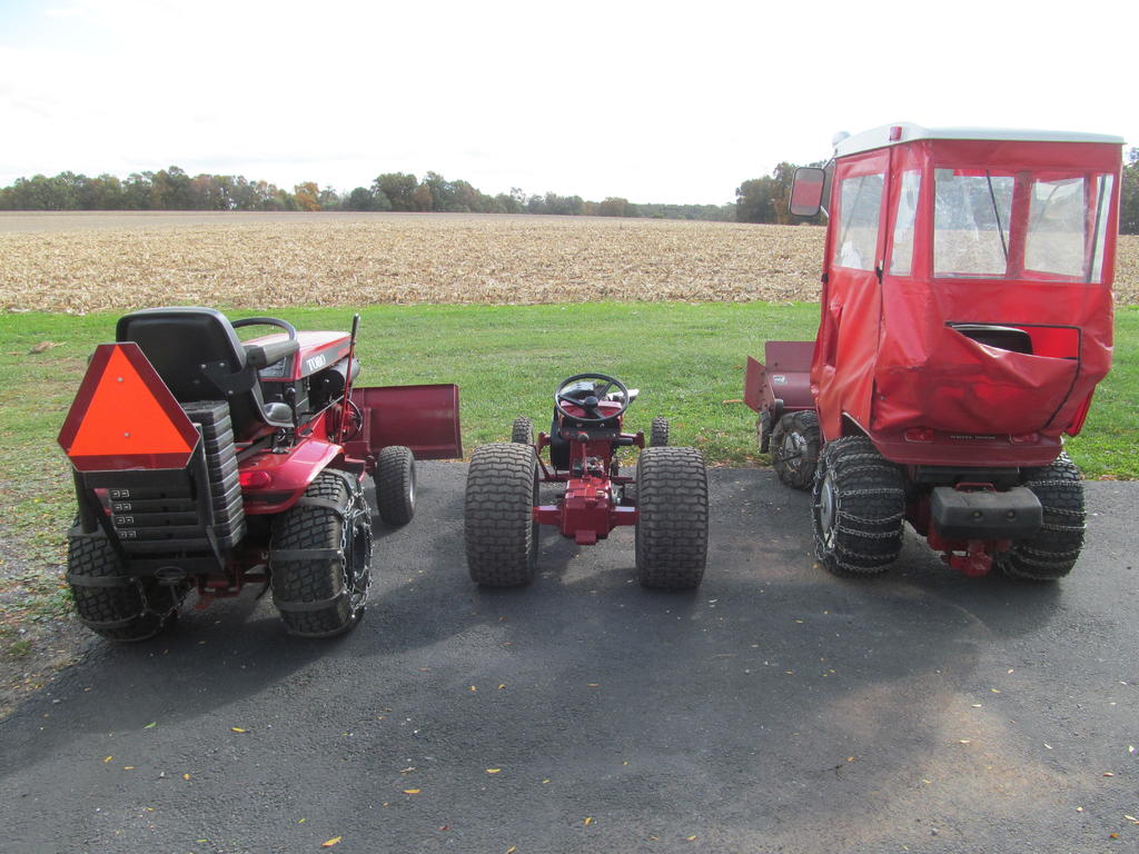

ebinmaine 77,530 #8 Posted October 2, 2018 24 minutes ago, Torrence20 said: So you have duals on the back of yours? Did you fab a different hitch for it or do you use the standard drawbar it came with? I would be concerned that kind of weight on mine would lead to a drawbar failure I haven’t looked really close at it but I think it’s just a pin that goes thru a cast parts of the axle Not duals, no. I didn't clarify that. What I have is four tires all the way around that are larger than stock and all are fluid-filled. On my tractor there is 255 pounds of fluid weight, alone. I do have the type of receiver hitch that bolts to the square 2 inch axle tubes. There is a vendor here on redsquare that sells an extremely heavy duty version of a hitch that does both. It goes through the Cross Pin that you're talking about and also bolts to the 2-inch Square tubes as mine does. ************* Please pay very special attention to this next piece. Your your concern with that tractor is not how much you can pull. It is how much you can STOP. There is only one little brake drum on these tractors. That's not enough to be going downhill or losing control going uphill while Towing something extremely heavy. I limited myself to a certain size of trailer for that very reason. I feel comfortable on my tractor, on my land, with me driving, with the way that I've built things. You have to be certain that you feel the same way with your own situation. 2 2 Share this post Link to post Share on other sites
