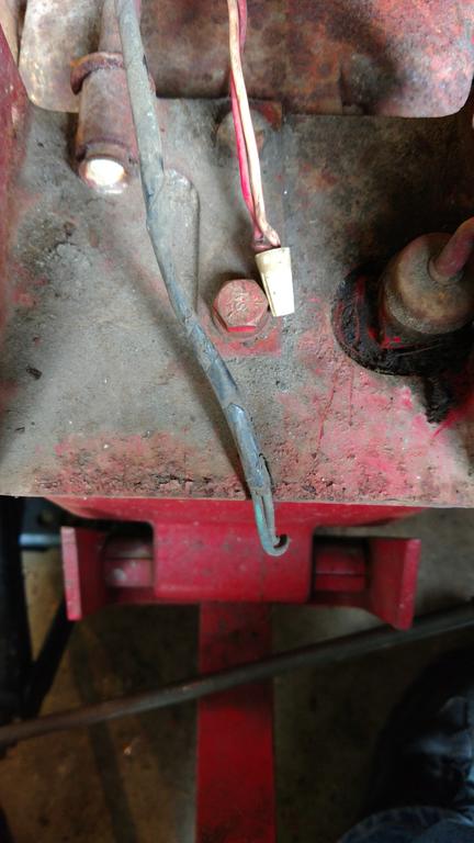

CountryRock 199 #1 Posted October 1, 2018 (edited) Took the fender pan off to clean around the transmission and found these wires just sitting there twisted together. Red and white with a nut, and two greens just twisted. What are they supposed to be for? Edited October 1, 2018 by CountryRock Share this post Link to post Share on other sites

CountryRock 199 #4 Posted October 1, 2018 Seat switch on schematic shows two black wires. Maybe the green ones are black further back. 2 Share this post Link to post Share on other sites
CountryRock 199 #5 Posted October 1, 2018 They look black further back. Gonna say those are seat switch then. 1 Share this post Link to post Share on other sites

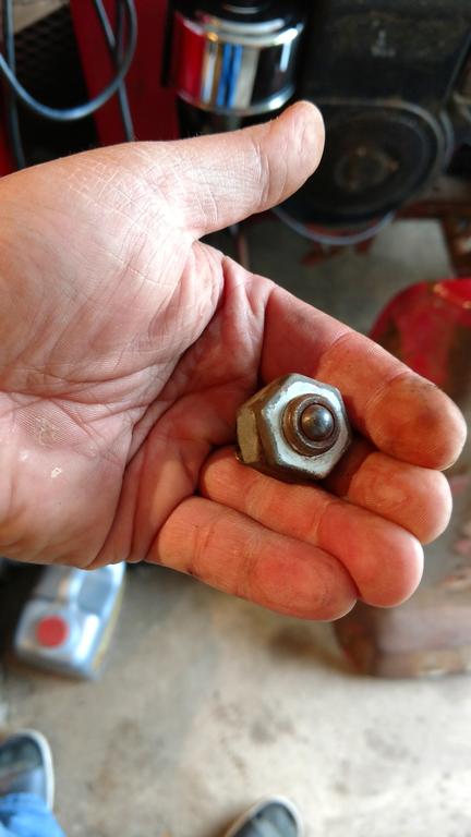

CountryRock 199 #6 Posted October 1, 2018 (edited) I think the other two might be the clutch interlock switch, now that I've studied the schematic more. EDIT: They are. I can see that switch is disconnected up inside. Edited October 1, 2018 by CountryRock 2 Share this post Link to post Share on other sites

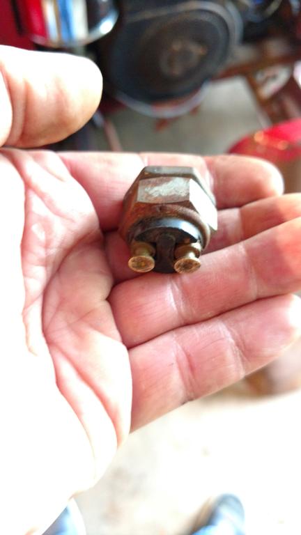

CountryRock 199 #7 Posted October 2, 2018 Decided to rewire the clutch interlock switch. Pulled the switch out to check it, and it does. Scuffed some of the rust off and flushed with contact cleaner. Good to go. Share this post Link to post Share on other sites
