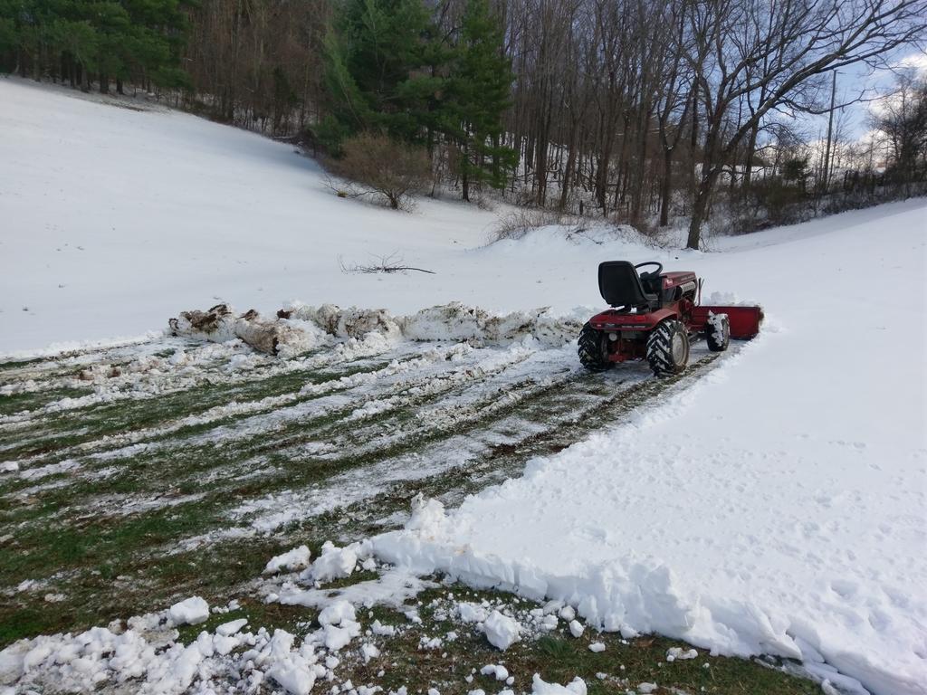

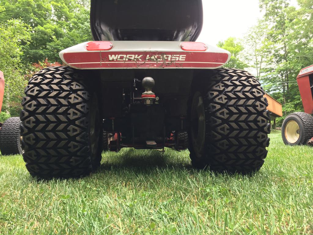

Sarge 3,473 #3 Posted October 1, 2018 I run ags all the way around on mine, but they see a lot of hard work in gravel, sand and even mud at times beyond the snow work in the winter. In the snow, they work quite well in keeping the front end planted but I do run weights up front as well as fluid filled tires. Carlisle Tru Power on most of them except the D-180 which is running the BKT's and I like those equally as well as the Carlisle. There are as many opinions out there as there are tire brands - it's all a matter of preference and personal taste. Sarge Share this post Link to post Share on other sites

Digger 66 3,530 #5 Posted October 1, 2018 Turf Masters if you're mowing more than anything . If you're tilling or playing in the dirt , Ag's and tri-ribs . 1 Share this post Link to post Share on other sites

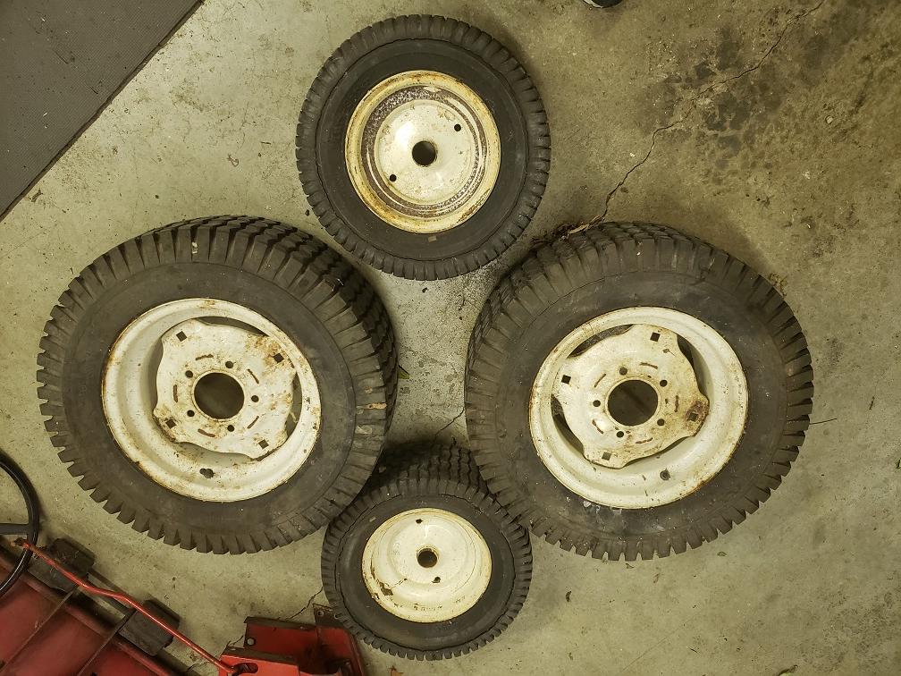

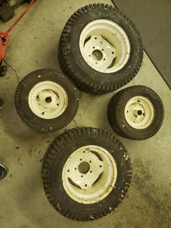

71_Bronco 1,072 #15 Posted October 5, 2018 (edited) As promised, here are some pics of the tires. The larger, rear tires arent too bad, some small cracks here and there, mostly in the grooves of the tread. The smaller front tires are what really concerns me, deep cracks all around the tires on both sides of the side-walls. Not sure if I can fill these cracks with some kind of epoxy putty that would hold while I use tubes in the tires, or if my money / effort is better spent on just putting on new rubber. Edited October 5, 2018 by 71_Bronco Share this post Link to post Share on other sites
ebinmaine 80,089 #16 Posted October 5, 2018 I'm a big fan of originality and especially on tires that still say Wheelhorse on them. They're just plain awesome. However, safety must be my number one concern. If you're going to be using your tractor to haul heavy loads or put stress on the rubber then they just really have to be in good shape. Share this post Link to post Share on other sites
