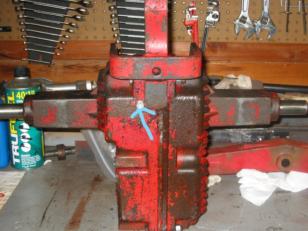

kudzu3 323 #1 Posted September 28, 2018 The procedure should be simple, but I don't want to mess anything up, so I'll ask the question. I need to change the fluid in my '69 charger. What fluid? What filter? Where is the drain plug? I have searched for manuals to guide me, but cannot find anything. Thanks for any help. Share this post Link to post Share on other sites
pfrederi 21,095 #2 Posted September 28, 2018 First determine what is in there. it may be ATF (Cherry Red) or 10w-30 motor oil tan. stick with what ever is in there... Filter Wix51410 You will need between 4 and 5 qts Drain plug on the bottom 1/4" hex 2 Share this post Link to post Share on other sites
stevasaurus 23,816 #3 Posted September 28, 2018 The 69 Chargers use 2 different hydros...Eaton 6 and Sundstrand 90-2046. Here are the manuals for the Eaton 6, and the Sundstrand 90-2046. 3 Share this post Link to post Share on other sites

jeepdave 8 #8 Posted October 10, 2018 (edited) On 9/28/2018 at 11:22 AM, pfrederi said: First determine what is in there. it may be ATF (Cherry Red) or 10w-30 motor oil tan. stick with what ever is in there... Filter Wix51410 You will need between 4 and 5 qts Drain plug on the bottom 1/4" hex Would the Eaton and Sundstrand both use the same filter? Thanks. Edited October 10, 2018 by jeepdave Share this post Link to post Share on other sites
953 nut 68,782 #9 Posted October 10, 2018 1 hour ago, jeepdave said: Eaton and Sundstrand both use the same filter? Yes, they both use the NAPA 1410 or Wix 51410. 1 Share this post Link to post Share on other sites
