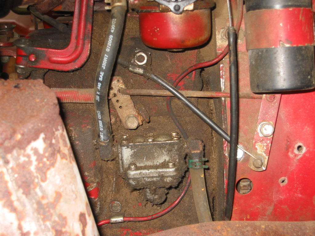

WHX?? 56,847 #2 Posted September 27, 2018 Should be real close to this 4 Share this post Link to post Share on other sites

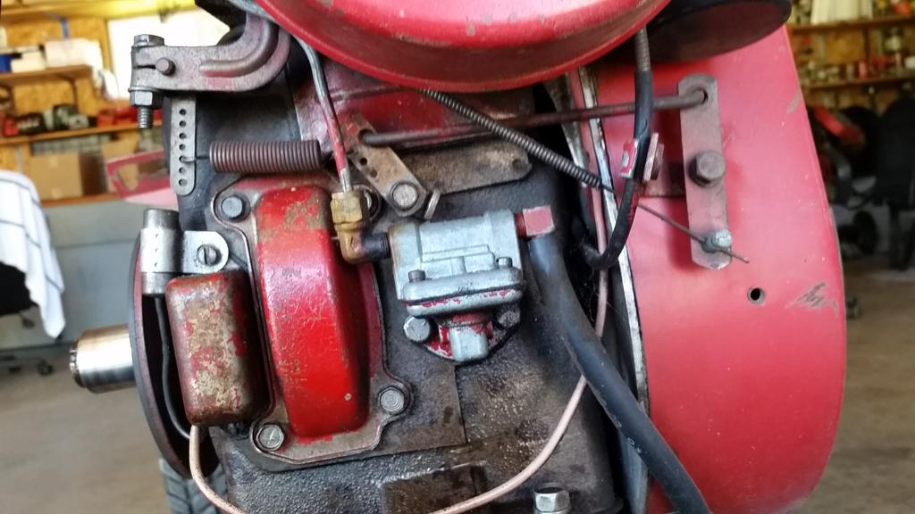

pfrederi 20,658 #3 Posted September 27, 2018 mine aren't as clean 2 Share this post Link to post Share on other sites
WHX?? 56,847 #4 Posted September 27, 2018 One thing the pic doesn't show is the clamp that holds the throttle cable is a clamp behind the air cleaner on the breather retaining stud. Lemme know you need a pic I'll sent the missus out to the shed It's raining out 3 Share this post Link to post Share on other sites

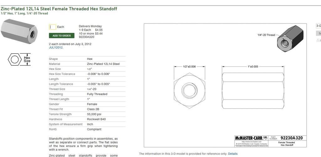

WHX?? 56,847 #8 Posted September 27, 2018 Thanks for saving her Fan... it's kind of a weird setup back ther. A longer nut, almost looks like a all thread coupler for spacing then the clamp and a nut with a split ring lock washer thrown in for good measure. 2 Share this post Link to post Share on other sites

pfrederi 20,658 #17 Posted September 28, 2018 Hard to get a good picture of the stand off This is what you need to get 2 Share this post Link to post Share on other sites
