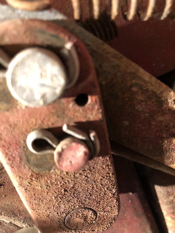

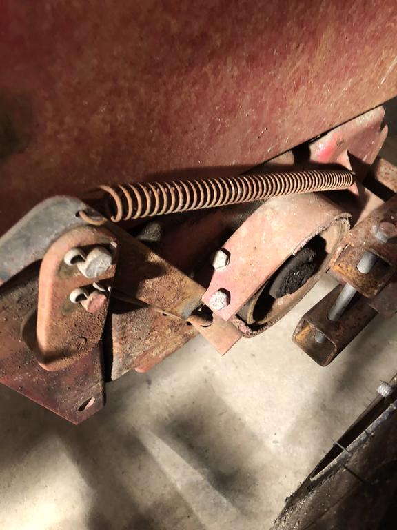

520hC-120 136 #1 Posted September 27, 2018 Hi guys, I’ve been experiencing problems with the drive belt on my 1055 puller. What it does is the belt will fall off every now and then then the belt eventually gets eaten. I have replaced the belt and looked at everything. It looks in order, but is not stock as you can see in the pics. The first and second pics are what it looks like after the belt has fallen off. The third pic is the assembly set up. Any suggestions on what to do would be nice. Thanks in advance! Share this post Link to post Share on other sites

953 nut 69,121 #4 Posted September 28, 2018 Your spring should be on the other side. It attaches to the brake lever where the common shaft goes across and the other end of the spring connects behind the brake band. Share this post Link to post Share on other sites

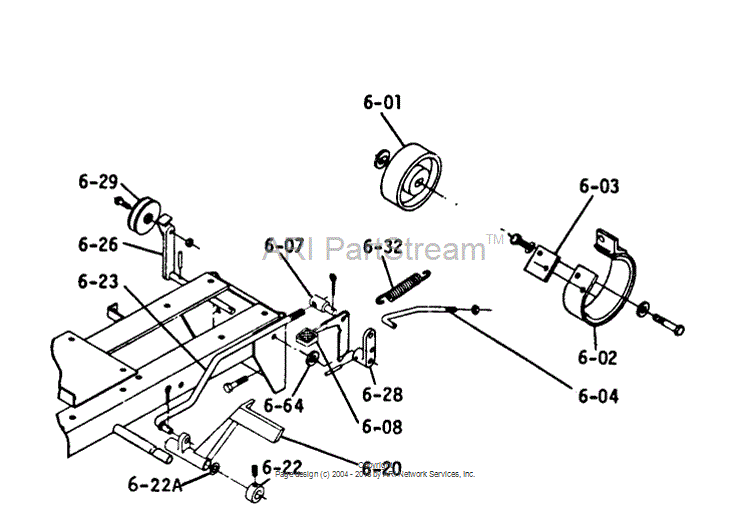

daveoman1966 3,884 #6 Posted September 28, 2018 Here is a good schematic of the belt clutch / brake system. I was wrong is stating the spring is behind the pulley...it is NOT. the spring #32 is on the opposite side of the tractor, as 953NUT stated. This is a Raider 10 schematic, but is the same setup. 1 Share this post Link to post Share on other sites

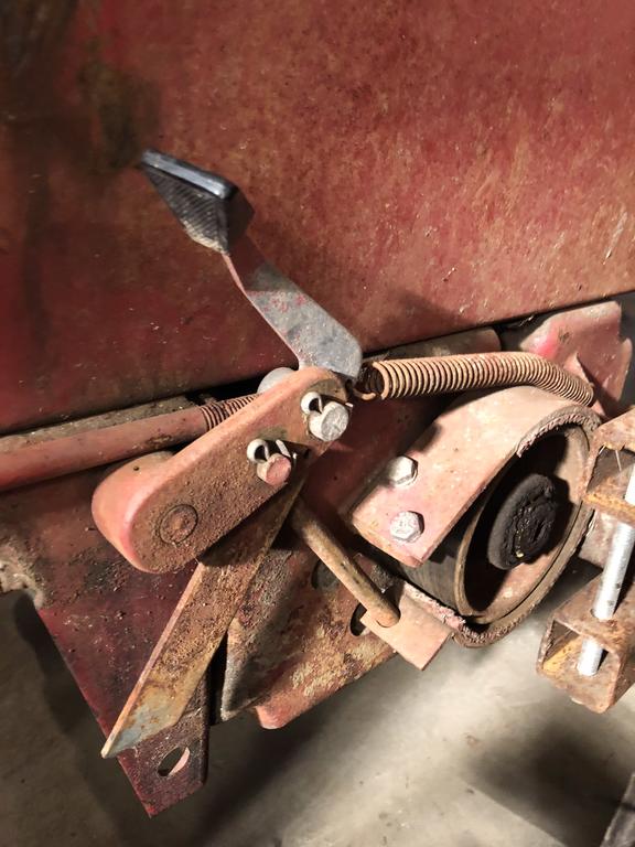

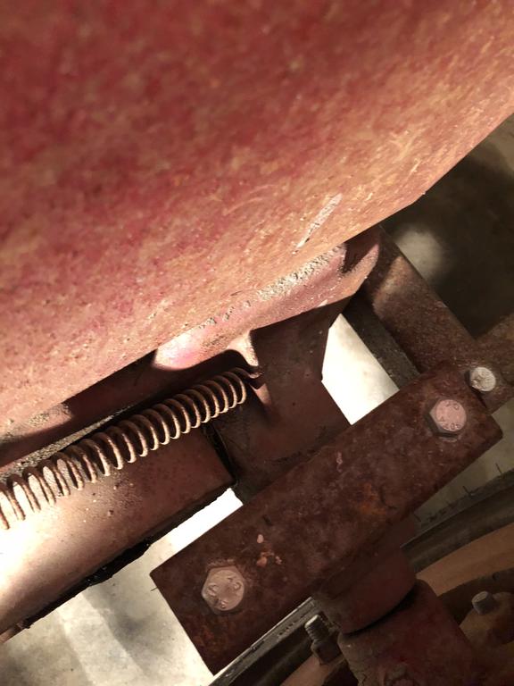

520hC-120 136 #9 Posted September 28, 2018 So I need a new spring that goes from the small hole (In pics) to the tranny support. But the park brake spring is on the spring as of now. Share this post Link to post Share on other sites
520hC-120 136 #10 Posted September 28, 2018 Just got it working. Happy with the results. Thanks to everyone! 1 1 Share this post Link to post Share on other sites
