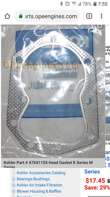

71_Bronco 1,072 #11 Posted September 27, 2018 On 9/25/2018 at 5:41 PM, ebinmaine said: I've only bought a couple. I've heard multiple times over the years that you should try to get a gasket that has the metal compression ring around the combustion chamber. Not all cylinder head gaskets on the aftermarket have that. I believe our vendor @A-Z Tractor Should be able to help you out there. This is the picture of the gasket from ISaveTractors' site. Does this one have the "compression ring" you're talking about? Share this post Link to post Share on other sites
WVHillbilly520H 10,378 #12 Posted September 27, 2018 Yes...here's the O.E. version Share this post Link to post Share on other sites
