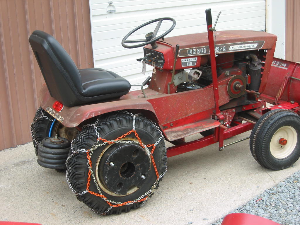

953 nut 69,124 #10 Posted September 25, 2018 As long as you have some place to push the snow to there will be no problem plowing with an 8 or 10 HP . On the steepest portions of my driveway I can only plow going down hill, have to lift the plow on the return trip. Chains, wheel weights liquid filled tires and a weight box are all methods of improving traction for snow removal. I have used this 10 HP 1055 with a 42" blade for years and live on a mountain side. I plow about 300 feet of driveway with an elevation change of eighty feet. There are several threads on this site about liquid filled tires. 2 3 Share this post Link to post Share on other sites

Ed Kennell 47,254 #12 Posted September 25, 2018 Here we go again....plow vs blower and weight vs chains. And it's only September. See my avatar … both of mine are ready, but it's been 4-5 years since I used the bower. The plow is quicker and works better in the wet sloppy stuff....and it's more fun. My go to snow remover. The rubber chains are the bomb. 6 2 Share this post Link to post Share on other sites

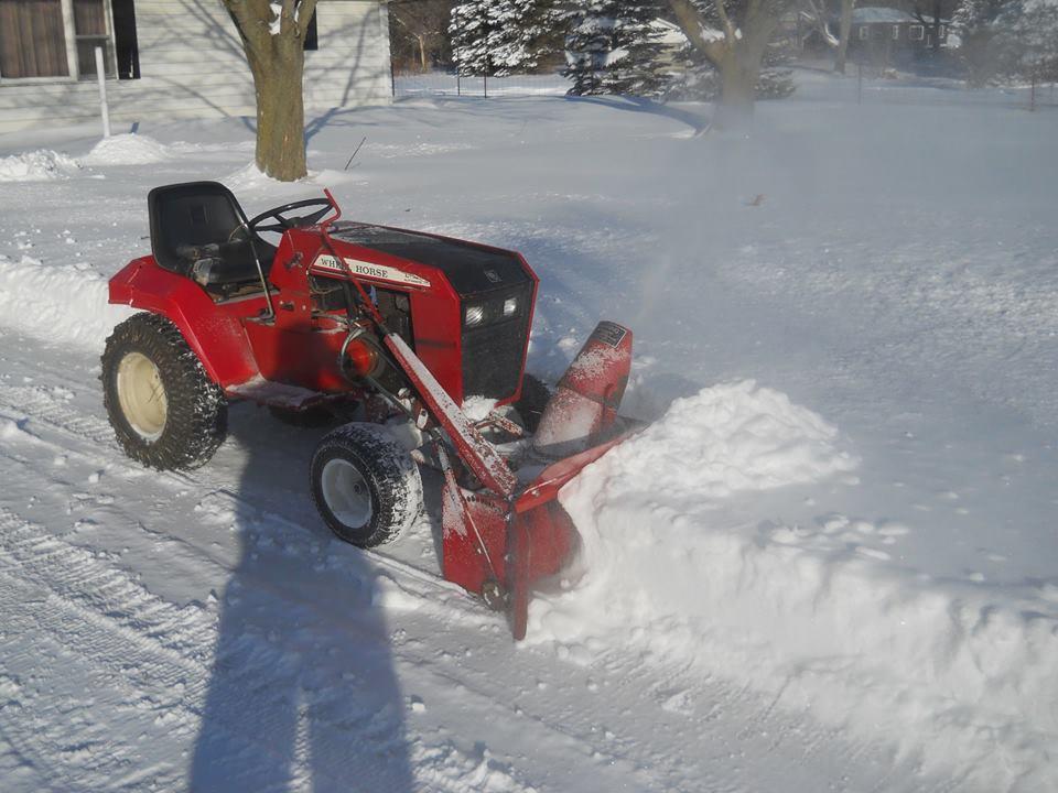

WH nut 553 #25 Posted September 26, 2018 (edited) Why push when you can blow Edited September 26, 2018 by WH nut 2 Share this post Link to post Share on other sites
