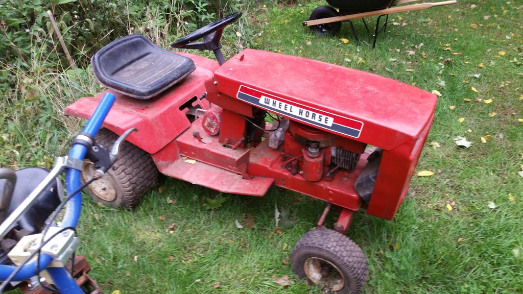

bloomfieldt 1 #1 Posted September 25, 2018 Can someone help me identify this model? The engine is a Briggs 8 hp 318cc Share this post Link to post Share on other sites
953 nut 70,344 #3 Posted September 25, 2018 Looks like it is a Ranger 800. Would need the model number to pin it down more but probably early 1970s Share this post Link to post Share on other sites

gwest_ca-(File Mod) 12,535 #5 Posted September 25, 2018 This same parts list covers the 1969-1973 models. Click on the fuzzy picture I believe these are the possible models but there are mistakes in the info available to us. There should be at least one electric start model and one recoil start model for each year and some are not identified correctly. If you can help with corrections that would be great. 1969 Lawn Ranger model 1-8741 1969 Lawn Ranger model 1-8745 1970 Lawn Ranger model 1-8751 - 7hp - ES @ Toro 1970 Lawn Ranger model 1-8752 - 8hp - ES @ Toro 1970 Lawn Ranger model 1-8755 - 8hp - ES @ Toro 1970 Lawn Ranger model 1-8756 - 8hp - ES @ Toro 1971 Lawn Ranger model 2-0200 - 7hp in PSB #414 1971 Lawn Ranger model 2-0210 - 7hp in PSB #414 1972 Lawn Ranger model 2-0200 - not listed @ Toro 1972 Ranger 800 model 2-0211 - 8hp in PSB #414 1973 Ranger 700 model 2-0220 - Vertical shaft (One found made in Belgium)- 7hp in PSB #414 1973 Ranger 800 model 2-0230 - Vertical shaft - 8hp in PSB #414 Look for an ID plate on the hoodstand up tight to the bottom of the dash panel housing - left, center and right side. Should have the model number and serial number on it. There may be more files. Enter a model number in the search box in " marks - "2-0200" and click on the drop down menu next to the search box. Select Files and it will search the files only. The results that come up are in no particular order so go through them all. May be more than one page of them too. Garry Share this post Link to post Share on other sites
