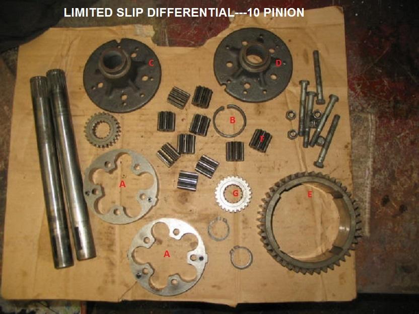

Kdalton36 0 #1 Posted September 24, 2018 Hi, I am a new to the site and needing help on differntial On my charger 12. When I started restoring my tractor I had a rear wheel stuck on the hub and ended up pulling the axle shaft out with the wheel. When I split axle housing to reinstall the snap ring one of the body's that holds the 10 pinion gears was broke. Anybody have any options of where to find one of these? I am finding out these are hard to find. Thanks Share this post Link to post Share on other sites
KC9KAS 4,746 #2 Posted September 24, 2018 @Kdalton36 I suggest contacting one of the site supporters that sell parts, and to An ad in the classified "wanted" may also help. Share this post Link to post Share on other sites
daveoman1966 3,883 #3 Posted September 24, 2018 Item marked 'A' in this pic... is this what you wanted??? If so, I have one... contact me at my email, which is: 1 1 Share this post Link to post Share on other sites
Kdalton36 0 #4 Posted September 24, 2018 Yes that is it. Share this post Link to post Share on other sites

McGrew 461 #8 Posted September 25, 2018 I recently rebuilt the 10 pinion diff in my 5073. Both of the pinion carriers came out in pieces. I found a really nice pair from A-Z Tractor for a good price. They arrived at my door shortly after completing the transaction, and I have nothing but good things to say about the purchase. Danny Share this post Link to post Share on other sites
