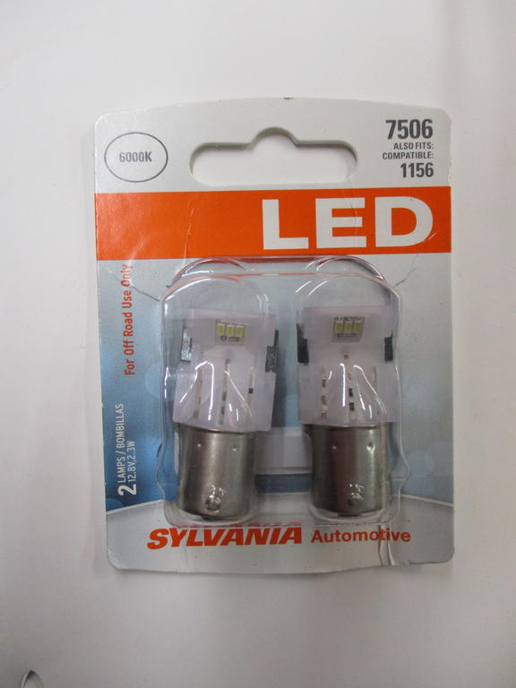

Tankman 3,528 #7 Posted September 24, 2018 (edited) Any recommendations for the 4” headlamps? Thinking, “I’m not to bright.” Edited September 24, 2018 by Tankman Share this post Link to post Share on other sites
WHX?? 54,509 #8 Posted September 24, 2018 (edited) Here you go Tank If you can find the 1156 in the lower 3 or 4 k color the better. the 5/6 k colors can glare with snow for winter work. If not a winter tractor go with 5/6 as they seem to be brighter Edited September 24, 2018 by WHX20 1 1 Share this post Link to post Share on other sites
