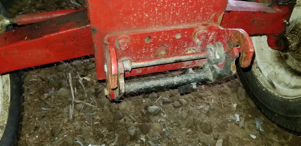

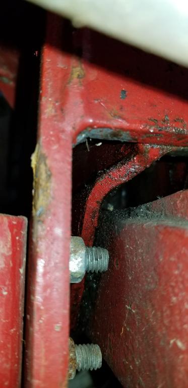

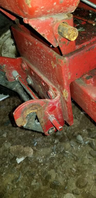

SimonC 35 #27 Posted September 24, 2018 (edited) hi guys, first off, thanks a lot for all the help, you guys rock! so I just got a second to go in the shed and look. what was perceived as a shim plate was actually on top of the bracket holding the front mount (see pic). I just removed the two first bolt to remove the extra plate. Just so we are on the same page, this metal plate was there to hold another front mounted plate used to attach a winch to raise/lower the snow blower (at least that what it looked like). should I conclude that this attach o matic bracket was custom made and that I should cut a piece off and use only the first two mounting holes ? edit---- looking at the pics @daveoman1966 provided, I would expect that behind that bracket there's a hidden frame hole, if two mounting screws aren't enough, drilling that one on the bracket would give me the 3rd thanks Edited September 24, 2018 by SimonC Share this post Link to post Share on other sites
pfrederi 19,459 #28 Posted September 24, 2018 Raiders never had front mount tachmatics. The PO fabricated something trying to replicate a later WH optional front hitch accesaorry set to put front tachmatics on older machineds He didn't do it right. I would pull lit all off an pick up an 8-5551 IF you want to continue to use a front tachmatic . Twp pictures of the 8-5551 and the mid tachmatic. they can work together. The last picture is the side frames of the 8-5551 Share this post Link to post Share on other sites
SimonC 35 #29 Posted September 24, 2018 so the existing "custom" front mount seems to work fine with the snow blower. belt length and all looked ok. If I just unbolt, cut the excess length to match the real 8-5551 brackets length, should I expect issue with the mowing deck and the front tensioner. it looks like the custom one I have might be a bit further away from the frame and a tad lower. thanks Share this post Link to post Share on other sites

pfrederi 19,459 #31 Posted September 24, 2018 The mule drive (tensioner) can make up a fair amount of any misalignment. But you will have to try it to make sure. Yes cutting off the shim plate (and you may need to trim a bit off the outer one as well) should reveal the hole you need and give you the space for the mid mount. Share this post Link to post Share on other sites

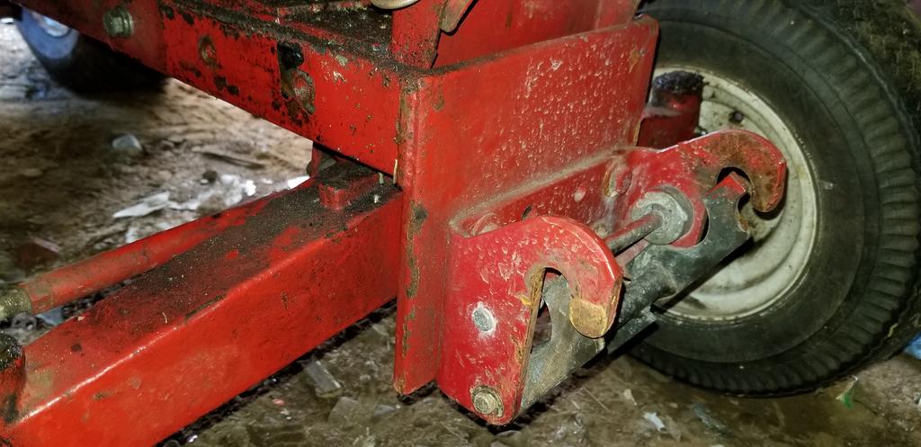

SimonC 35 #32 Posted September 24, 2018 took some pics of the current setup Share this post Link to post Share on other sites
pfrederi 19,459 #33 Posted September 24, 2018 Maybe ;looks a bit low and maybe forward...but only way to find out for sure is to try Share this post Link to post Share on other sites

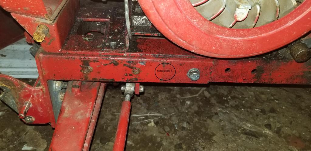

SimonC 35 #35 Posted October 29, 2018 On 9/23/2018 at 5:27 PM, JAinVA said: These may be redundant considering some of the other pictures posted but I hope they may help.The first shows where tachmatic plates mount to the frame.The second shows how all the assorted parts are located.The last 2 pictures are of the mounting the t-bar. on this picture that you posted, the hole that has something like a washer on it is used by my pedals, however I have the bottom one. the bottom (to the right on the pic) is not what was provided on the exploded part diagram, would you guys think that it could still be used to install a lift t-bar for the mower deck ? thanks Simon Share this post Link to post Share on other sites
JAinVA 4,638 #36 Posted October 30, 2018 The hole on the right is to low for the lift bar.The lift bar cross shaft can be seen on the lower left.This is where it mounts. 1 Share this post Link to post Share on other sites
