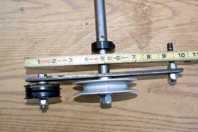

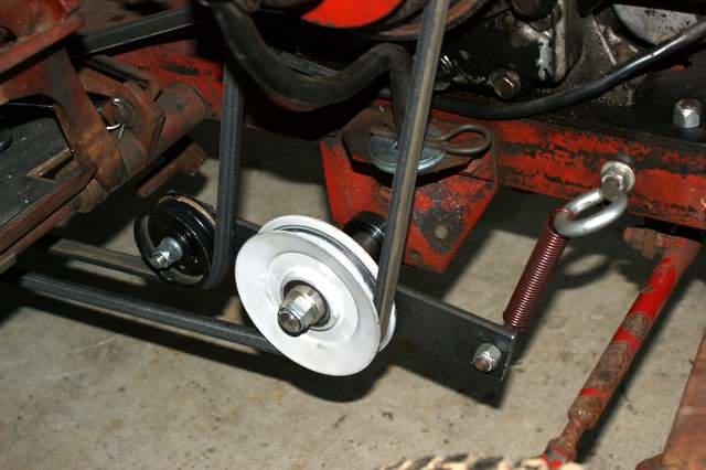

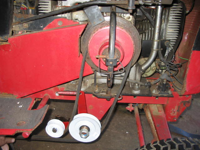

daveoman1966 3,884 #3 Posted September 22, 2018 Wrong pulley(s)...wrong belt? The belt # 110265 is 141" x 1/2. Here are two pulley setup options: 1 Share this post Link to post Share on other sites

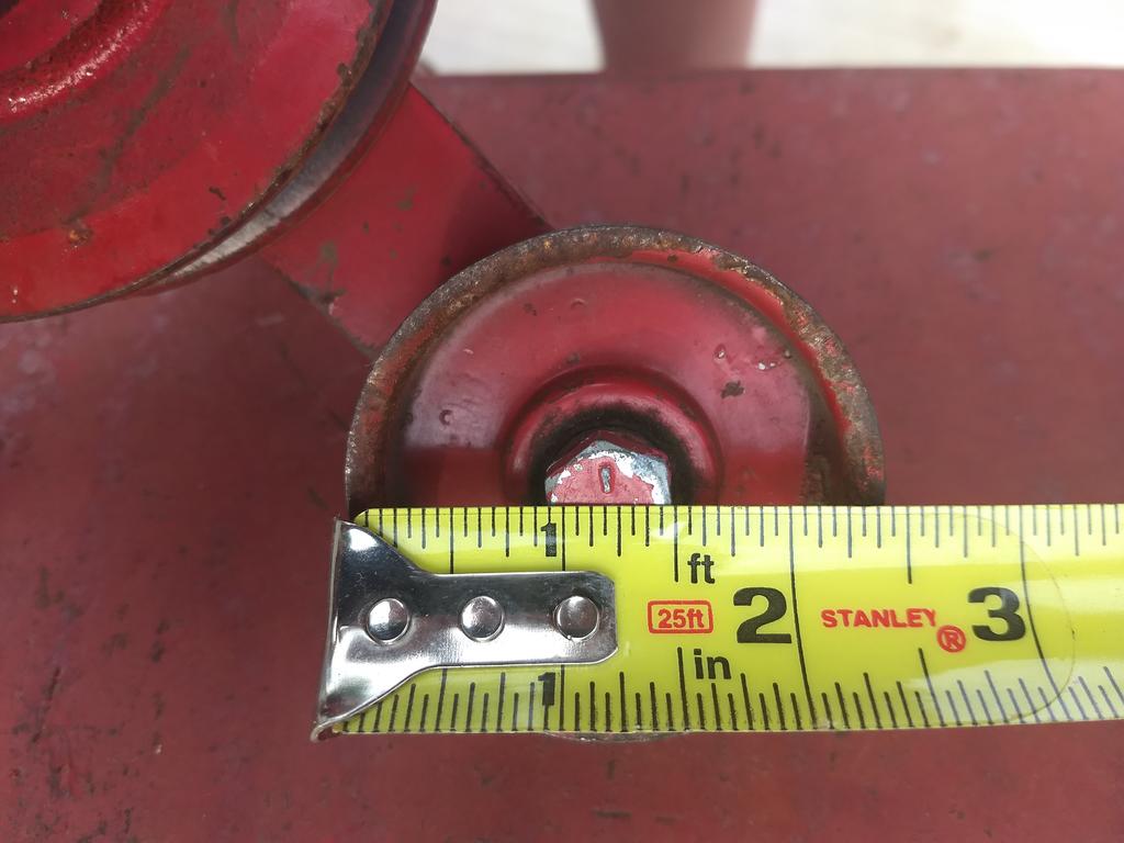

Blackhood Bill 728 #5 Posted September 22, 2018 I just bought a tiller for my c-145 and I seen your post and just went out to measure my pulley. Here is a picture of mine with a tape measure.hope this helps. This is for 36" tiller. 2 Share this post Link to post Share on other sites

sparkys toy 77 #8 Posted September 27, 2018 Couldn't tell from your pix but it didn't look like the tension spring is installed,which would pull the idler would rotate down away from the pettal bar just got a new oem idler pulley from toro and it fits great Share this post Link to post Share on other sites
Busman 14 #9 Posted September 27, 2018 I bought a 2.5 inch pulley and it fit much better. Now I’ll need the spring to apply tension. I’ll get one this weekend. Share this post Link to post Share on other sites
