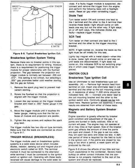

pfrederi 21,300 #5 Posted September 21, 2018 Here are the tests for the coil and trigger. Share this post Link to post Share on other sites
