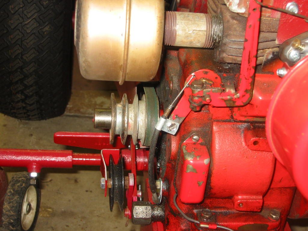

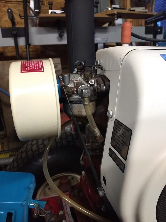

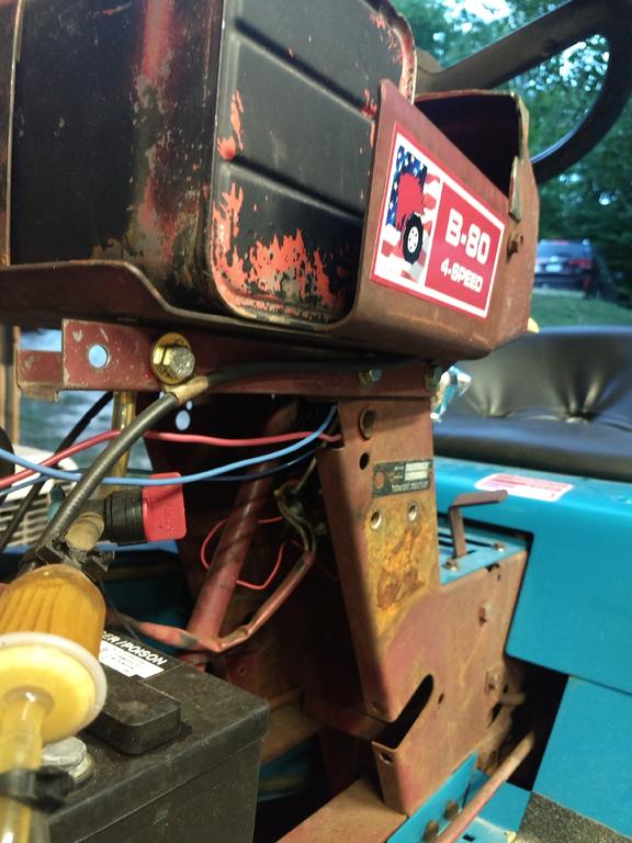

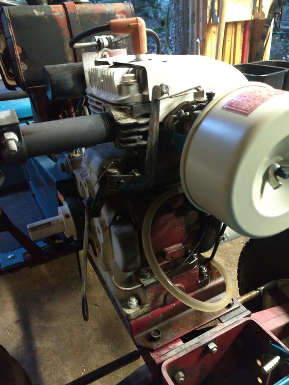

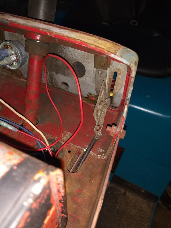

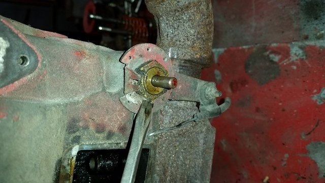

ebinmaine 77,068 #6 Posted September 17, 2018 Here's some pics of my Patriot horse. This shows the choke cable as it goes into the carburetor and also how it's mounted on the side of the engine. This shot shows where it is held onto the side of the tractor. Here you can see where the cable comes up through the fuel tank bracket and attaches to the back of the lever. This pic shows the end of the throttle cable and the bracket that holds it and where it goes into the wheel that is attached to the engine governor. Let me know if there's something else you'd like to see or a different angle... 2 Share this post Link to post Share on other sites
ol~horses 4 #8 Posted September 18, 2018 thanks for all the replies!....if you positioned yourself so that the pto lever was in front of you, you' see the of the tractor... linkage ,primairly 2 disks actuated by the gov. linkage in front the disks pivot on one another..... they are no longer made...think I can fix them, but don't know how the throttle cable was routed PS i gotta get a camera! appreciate the help, folks Share this post Link to post Share on other sites

ol~horses 4 #14 Posted September 20, 2018 I think that if I could see the backside of the disks etc. to see which goes over what i'd be on my way (or closer anyway)....remaking the interior end of the brass nut unit corrected one problem already!.............thanks again to all who have been making suggestions 1 Share this post Link to post Share on other sites

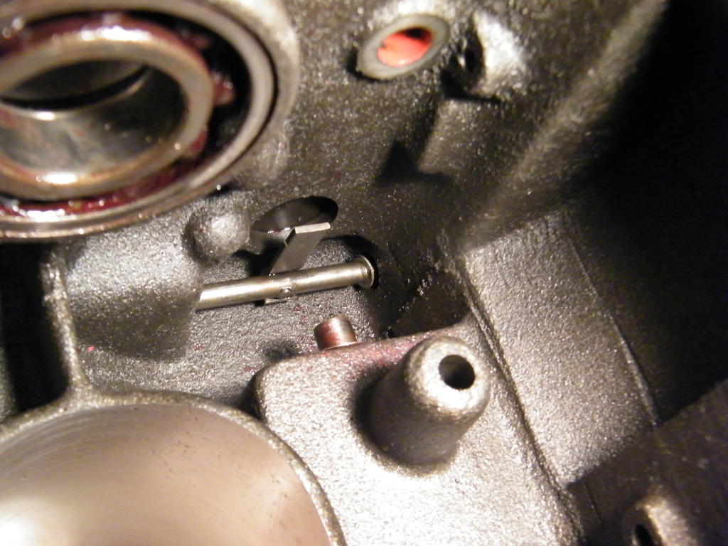

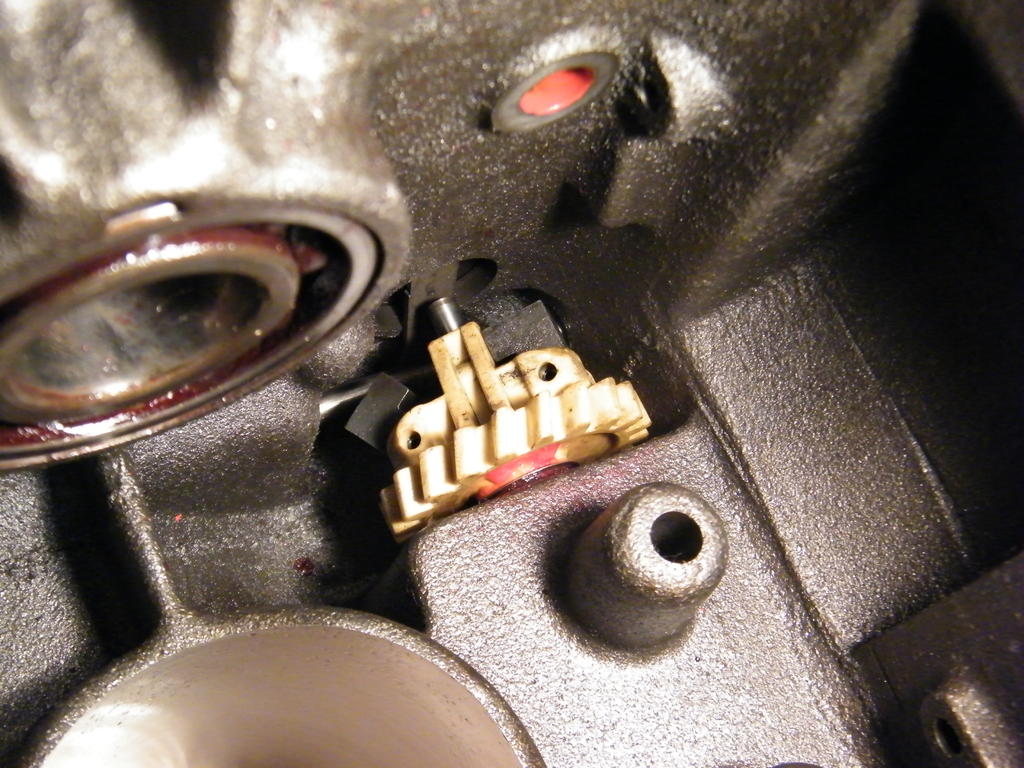

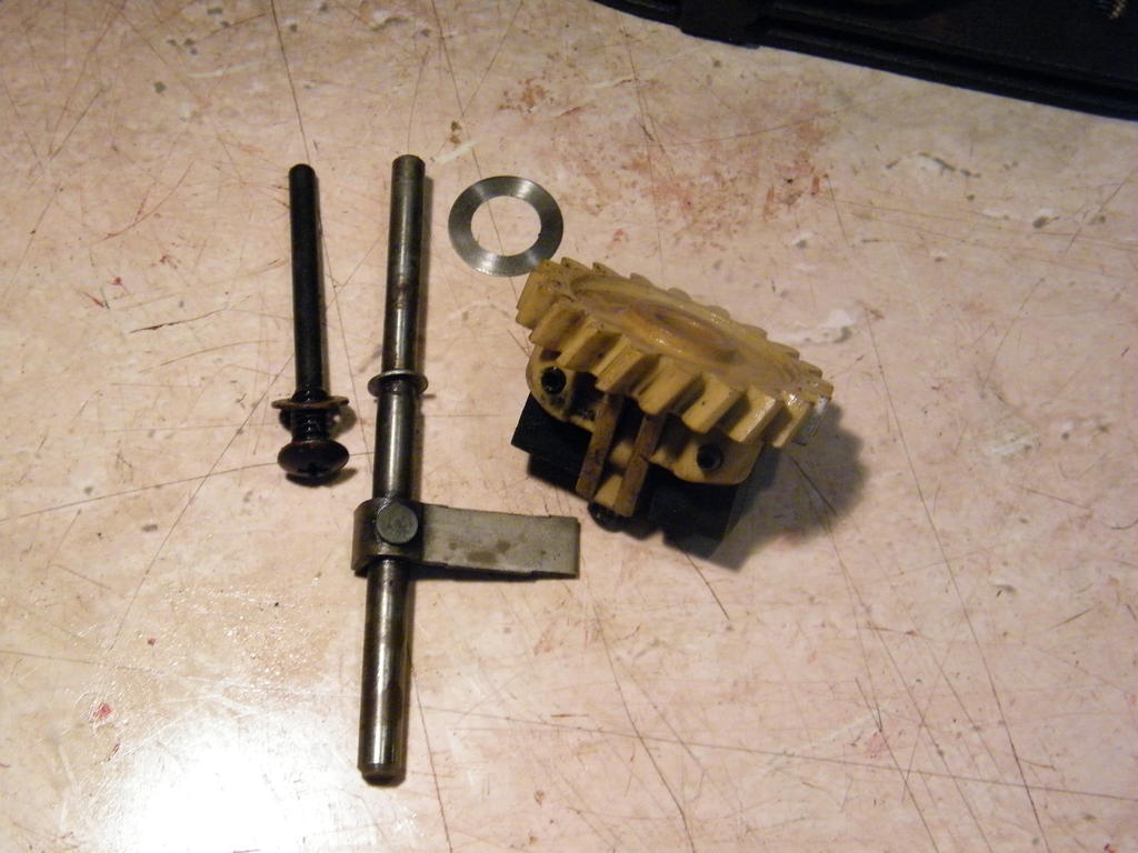

stevasaurus 23,568 #16 Posted September 20, 2018 Here is what the inside parts of the governor look like. There are some real good pictures in this thread of the governor. Check this out. Share this post Link to post Share on other sites
ol~horses 4 #17 Posted September 20, 2018 the disk and brass piece are mounted on the chasis and are part of the governor ...the backside of the disk,brass piece and arm are what i am referring to...the arm has a hole on one end,an offset and a forked opening on the other end...so you have the two pieces riding on the brass piece,i think........*chuckle....that is the backside i'm referring to....the arm with the fork is pretty ugly on the fork end....I can't picture in my head what that looks like....btw i live 15min south of elk river Share this post Link to post Share on other sites
stevasaurus 23,568 #18 Posted September 21, 2018 I understand where you are talking about, I just don't get what you are trying to do. Share this post Link to post Share on other sites
ol~horses 4 #19 Posted September 22, 2018 Steveasauus the brass nut on mine had been worn down, causing a bind ...I used a little hand grinder to remove some material from the backside of the head of the brass nut...this gave me free floating (bindless) operation THEN *chuckle, my son in law figured out how to adjust the governor unit (as UNIT) ...yep, he IS a smart fella!...(bails me out, A-lot).... thanks to all who have been giving me a hand! Last but not least, cannot seem to find a ignition sw......been to couple of suppliers without getting the proper replacement...they say the part number of their unit is a direct replacement it AIN"t.....the ones they insist is correct has the wrong contact orentation so when you release the key from start position you also lose the run circuit......anybody know what the correct part number is? last but not least, did Wheel Horse ever make a cab that zipped up/down so you'd stay dry when blowing snow.....I've go one but don't know who made it...came with a frame attachment that attaches it to the tractor...it fits the B-80, ddon't know about the others Share this post Link to post Share on other sites
