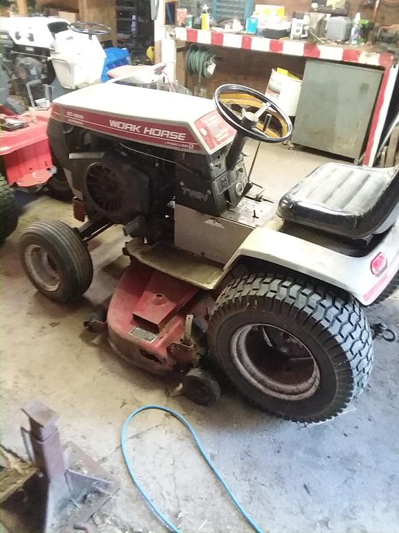

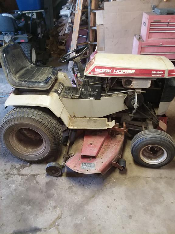

Alamobrady30 47 #1 Posted September 16, 2018 I have recently inherited a 1984 gt-1800 that has been sitting for 8+years. I am look for the size of v-belt that's goes to all three blade spindles. I got it runing like a champ and the hydros work great but the belt in question was already missing. Help a brotha out . 1 Share this post Link to post Share on other sites
