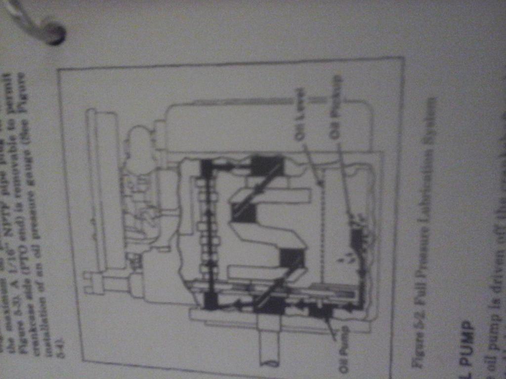

The Gman 476 #16 Posted September 17, 2018 (edited) On 14/09/2018 at 10:33 PM, Sparky said: The series 1 Kohler 17 twins were known to starve one of the cylinders of oil if ran on slopes. They were a splash lubed motor and the cylinder on the "up side" wouldn't get proper lubrication. Two sidways and fuzzy pics of the two lub systems on the series II. Edited September 17, 2018 by The Gman Share this post Link to post Share on other sites
