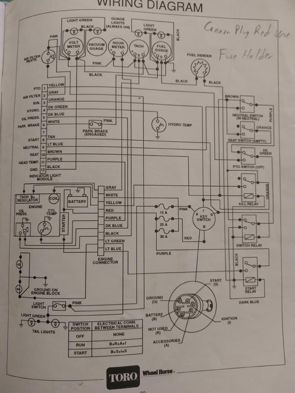

520hC-120 136 #2 Posted September 13, 2018 I had a similar problem with my 520h except it died and had no spark. So no guarantees but it may be your problem. So next to your battery there will be a connector connecting two wires to other ones. What will happen is it will get dirty and cause malfunctions. What I did is just snip the wires from the connector, and used just wire connectors to join them. Make sure that they are the same wires connected or I’m sure more issues will arise. Hope this helps. Share this post Link to post Share on other sites
WHX?? 58,226 #3 Posted September 13, 2018 520hc beat me to it but yes Check the nine pin connector they have been known to go bad and even give the intermittent problems. Same with the fuse holders. 2 Share this post Link to post Share on other sites
