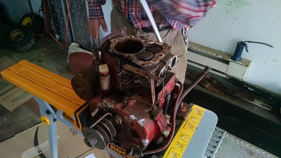

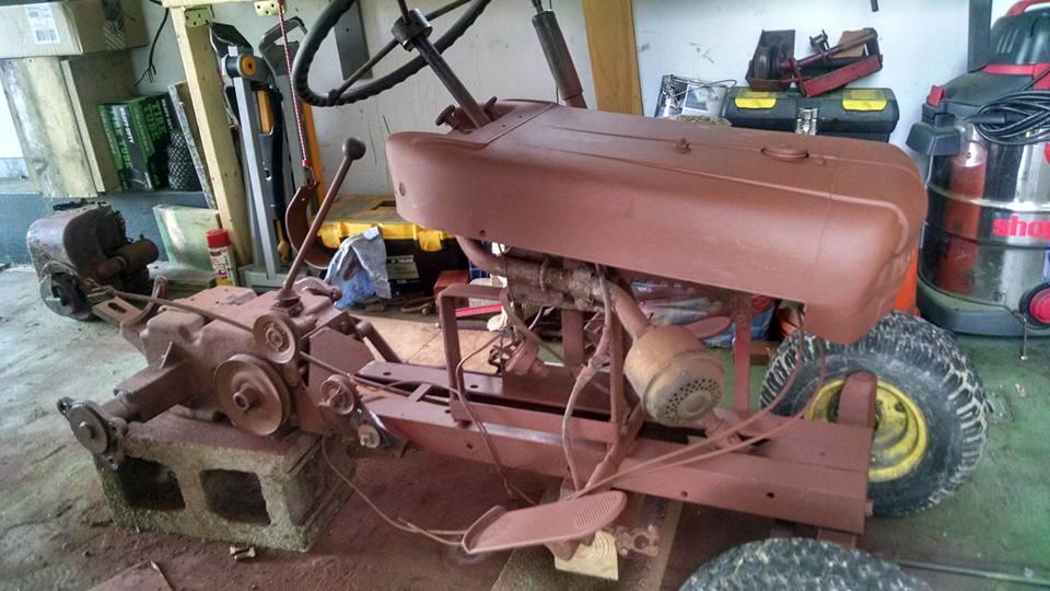

Paul Boy 31 #14 Posted October 5, 2018 We've made some progress on our little find. A couple of questions. Are those footrests correct for a 1961 551? This has an ignition switch that is attached on the right hand side of the hood, would that have been a feature on a 1961 551? The original engine is now freed up and turning very smooth. There is no brand name on the engine but there is a metal plate with some numbers on it attached. I will try to photograph it tomorrow and maybe someone can tell me something about it. It looks good and hope to get to try it over the weekend. The body is now in full primer and looking forward to working on it again this weekend. To answer the question about the gauge that appeared to be upside down. Its an add on amp meter and the housing was cracked and broken off and it was just sitting there. 1 Share this post Link to post Share on other sites

Paul Boy 31 #16 Posted October 5, 2018 Have only these two photos that I took a couple of days ago. 1 1 Share this post Link to post Share on other sites
WHX?? 53,079 #17 Posted October 5, 2018 Those are the correct footrests and I believe the original engine would have been a Tecumseh HH55D-2113. Not sure on the ignition switch. Share this post Link to post Share on other sites
stevasaurus 23,490 #18 Posted October 5, 2018 That engine does look like a Tecumseh...googled images of old Tecumseh engines. This was my 5.5 with a different spec number then yours. Share this post Link to post Share on other sites
