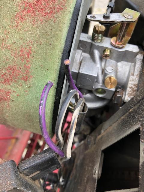

TimH 105 #1 Posted September 12, 2018 M125 Stopped charging the battery. Is there anything besides replacing the battery and cleaning cables that I should look at or test before taking flywheel off ? Plus were is the best place to get a stator if I need one ? Thanks ! Share this post Link to post Share on other sites

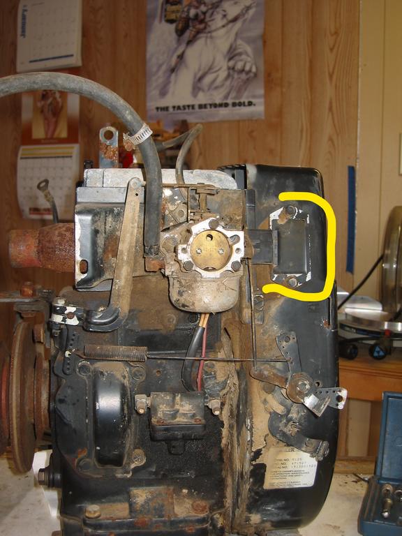

pfrederi 19,280 #3 Posted September 12, 2018 The regulator is in the front of the blower housing. You have to remove the plastic Air cleaner cover to see it 4 Share this post Link to post Share on other sites
TimH 105 #4 Posted September 12, 2018 Thanks pfrederi and Achto Found a wire broken, Solider and heat shrink . All working great now. 1 2 Share this post Link to post Share on other sites
