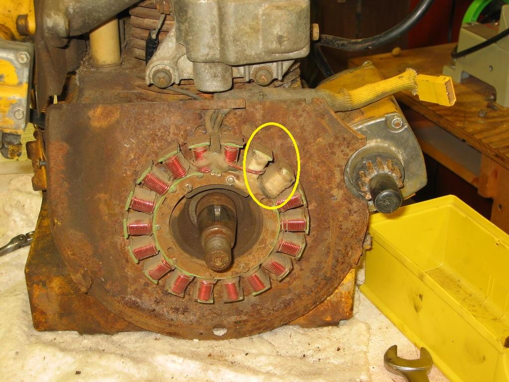

SimonC 35 #76 Posted September 14, 2018 1 minute ago, Achto said: I believe that there are separate windings on you stator. 1 set for the ignition and 1 set for charging. I'll take that as a "possible" indicator that something's working in my flywheel/stator current state thanks! Share this post Link to post Share on other sites
pfrederi 20,226 #77 Posted September 14, 2018 1 minute ago, Achto said: I believe that there are separate windings on you stator. 1 set for the ignition and 1 set for charging. The are independent and can fail independently. Do yo have spark?? Share this post Link to post Share on other sites
SimonC 35 #78 Posted September 14, 2018 5 minutes ago, pfrederi said: The are independent and can fail independently. Do yo have spark?? yes, engine runs fine (for it's age :p) Share this post Link to post Share on other sites
SimonC 35 #79 Posted September 14, 2018 6 minutes ago, pfrederi said: The are independent and can fail independently. Do yo have spark?? dont burst my bubble lol I'm trying to be optimistic Share this post Link to post Share on other sites
Achto 31,513 #80 Posted September 14, 2018 (edited) Looking at the pic that pfrederi posted. I circled the part of the stator that appears to run the ignition. The rest of the stator is used for charging. Edited September 14, 2018 by Achto 1 Share this post Link to post Share on other sites
SimonC 35 #81 Posted September 14, 2018 1 minute ago, Achto said: Looking at the pic that pfrederi posted. I circled the part of the stator that appears to run the ignition. The rest of the stator is used for charging. ok then, at least the magnets in my flywheel must still be glued properly otherwise that would also not work. Share this post Link to post Share on other sites
Achto 31,513 #82 Posted September 14, 2018 2 minutes ago, SimonC said: yes, engine runs fine (for it's age :p) 2 minutes ago, SimonC said: lol I'm trying to be optimistic Remain optimistic until testing has proven otherwise. Share this post Link to post Share on other sites
pfrederi 20,226 #83 Posted September 14, 2018 The picture is of a 15 amp stator The 10 amp looks different but same concept 1 Share this post Link to post Share on other sites

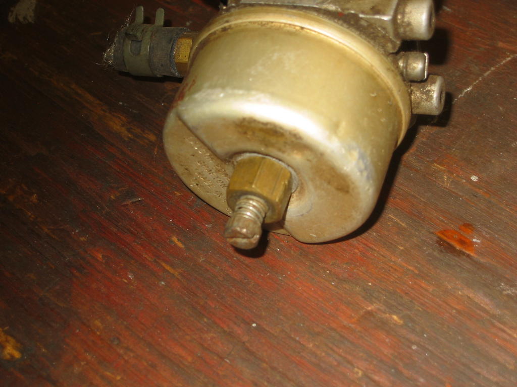

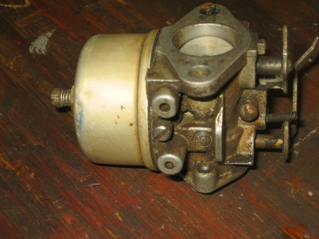

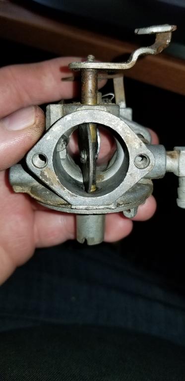

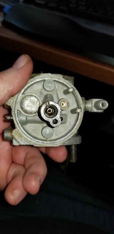

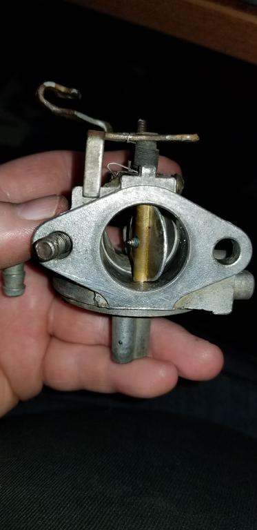

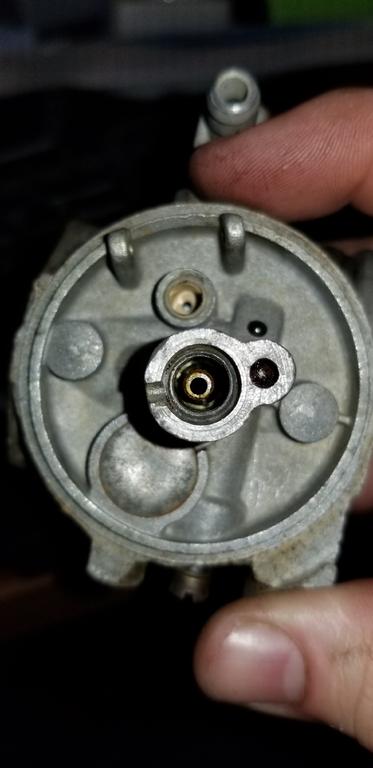

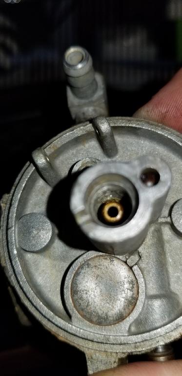

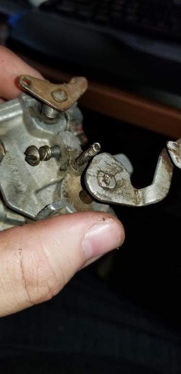

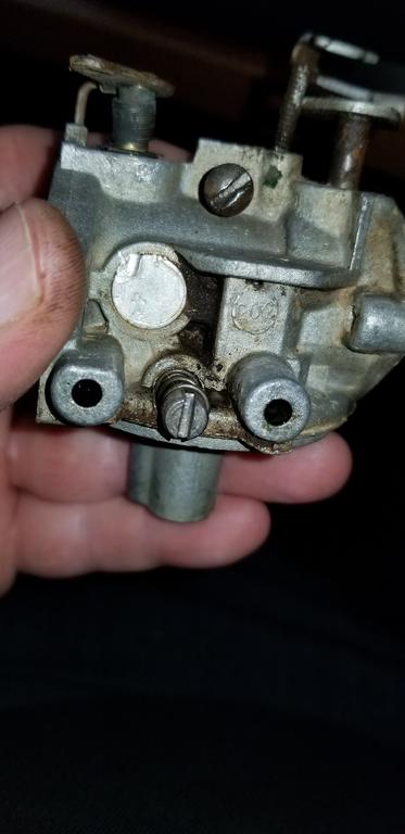

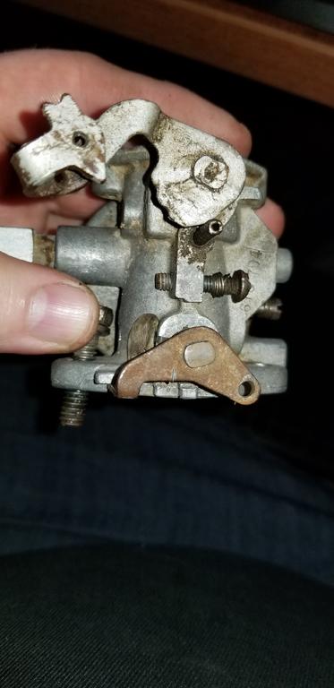

SimonC 35 #85 Posted September 14, 2018 am I missing a jet ? i didn't remove anything other than the o-ring, metal float and needle from inside the bowl. Share this post Link to post Share on other sites
SimonC 35 #86 Posted September 14, 2018 (edited) just noticed the throttle butterfly is not where it should, not sure if I did it removing or not, just moved it back (that's how much slack there is in the exterior part). would explain why my idle was so high Edited September 14, 2018 by SimonC Share this post Link to post Share on other sites
pfrederi 20,226 #87 Posted September 14, 2018 There should be a spring on the throttle butter fly shaft Spacer provides clearance from the block for the throttle linkage. Should have a gasket on both sides. Techy carb main jets are usually in the fuel bowl see picture 2 1 1 Share this post Link to post Share on other sites

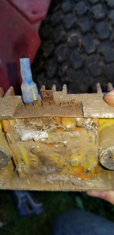

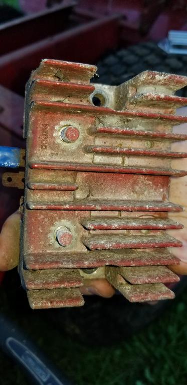

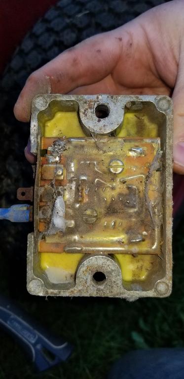

SimonC 35 #89 Posted September 24, 2018 On 9/19/2018 at 7:32 AM, Achto said: Just checking in to see if you have made any progress. 5 kids 10 and under, slow progress.. I relocated the solenoid from where the original throttle usually goes. I also took the old regulator off, Pretty obvious that this one's life is done. see picture. ordered a replacement (which is much smaller). I have my replacement carb, just waiting for my fel pro material to cut the missing gasket before I can install it. in the meantime I have been working on trying to get my mower attached, it came with it, but clearly was never used on it... also going to reroute some of the hoses and redo the wiring for the regulator. very slow progress, I just hope I can at least mow once with it before snow falls, 1 celcius this morning, winter is coming. 1 Share this post Link to post Share on other sites

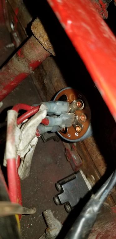

SimonC 35 #90 Posted September 30, 2018 (edited) Hi, finally getting around to re-wire some of this stuff. moved my solenoid properly. attached my new regulator and wired the two AC leads to it. Now I'm looking at my key switch labels and I'm confused. my key switch has the following: B G S L M Where am I supposed to hook up the DC lead coming from the regulator ? all I read and schematic I can see have the R lead which connects to the regulator... thanks Edited September 30, 2018 by SimonC Share this post Link to post Share on other sites
pfrederi 20,226 #91 Posted September 30, 2018 15 minutes ago, SimonC said: Hi, finally getting around to re-wire some of this stuff. moved my solenoid properly. attached my new regulator and wired the two AC leads to it. Now I'm looking at my key switch labels and I'm confused. my key switch has the following: B G S L M Where am I supposed to hook up the DC lead coming from the regulator ? all I read and schematic I can see have the R lead which connects to the regulator... thanks You can wire it to the L terminal. You want a terminal that is only connected in Run position. 1 Share this post Link to post Share on other sites
SimonC 35 #92 Posted September 30, 2018 (edited) 3 hours ago, pfrederi said: You can wire it to the L terminal. You want a terminal that is only connected in Run position. so here's the current status. I have over 20V AC between the two leads coming from the generator I have tested my regulator metal body against the tractor ground with no issues. I also dont fully trust the screw to provide a proper ground so I have a lead going from one of the mounting screw directly to my battery negative side. I have 0V DC reading when testing the middle lead against the ground other than coming with the conclusion that the regulator is possibly defect, are there other things I can test ? ----- edit with the key in the ON position, shouldn't I get 12v DC at the middle regulator lead provided by the battery ? ------ thanks Edited September 30, 2018 by SimonC Share this post Link to post Share on other sites
Achto 31,513 #93 Posted September 30, 2018 1 hour ago, SimonC said: have 0V DC reading when testing the middle lead against the ground You will need to have it connected to a battery for it to work. Also I would try to find a switch that has an I on it instead of a M. The switch you have is for a magnito style ingnition. You can use the one you have but do not connect anything to the G or M terminals. Share this post Link to post Share on other sites
pfrederi 20,226 #94 Posted September 30, 2018 31 minutes ago, Achto said: You will need to have it connected to a battery for it to work. Also I would try to find a switch that has an I on it instead of a M. The switch you have is for a magnito style ingnition. You can use the one you have but do not connect anything to the G or M terminals. I have to disagree this is a techy solid state ignition you do not want an I terminal..... 1 Share this post Link to post Share on other sites
pfrederi 20,226 #95 Posted September 30, 2018 2 hours ago, SimonC said: so here's the current status. I have over 20V AC between the two leads coming from the generator I have tested my regulator metal body against the tractor ground with no issues. I also dont fully trust the screw to provide a proper ground so I have a lead going from one of the mounting screw directly to my battery negative side. I have 0V DC reading when testing the middle lead against the ground other than coming with the conclusion that the regulator is possibly defect, are there other things I can test ? ----- edit with the key in the ON position, shouldn't I get 12v DC at the middle regulator lead provided by the battery ? ------ thanks You should if you have the regulator wire plugged into the ignition switch in the R or failing having that the L or A terminal. In run the switch should connect B to the A L R I terminals. You sure about your switch>?? Share this post Link to post Share on other sites
Achto 31,513 #96 Posted September 30, 2018 (edited) 8 minutes ago, pfrederi said: I have to disagree this is a techy solid state ignition you do not want an I terminal..... That's right. I should have read back & brushed up on the post. Darn C.R.S. Good catch @pfrederi Edited September 30, 2018 by Achto Share this post Link to post Share on other sites
SimonC 35 #97 Posted September 30, 2018 So you guys are confirming that there is no diode in the L leg on those switches that would prevent the 12v from travelling back from the battery ? Share this post Link to post Share on other sites
pfrederi 20,226 #98 Posted September 30, 2018 25 minutes ago, SimonC said: So you guys are confirming that there is no diode in the L leg on those switches that would prevent the 12v from travelling back from the battery ? Never say never..do you have continuity between B L in the run position??? If so no diode never heard of one in the switch itself. 1 Share this post Link to post Share on other sites
SimonC 35 #99 Posted October 1, 2018 So if there is no diode, my switch might be defective then. Out of curiosity, why would the regulator need 12v DC to work ? Share this post Link to post Share on other sites
SimonC 35 #100 Posted October 1, 2018 Also, I guess I should be able to confirm that the regulator is working by hooking up the battery positive directly to the DC lead on it.... If that works it would point the finger at the switch. That's one thing that isn't rusted out lol. 1 Share this post Link to post Share on other sites
