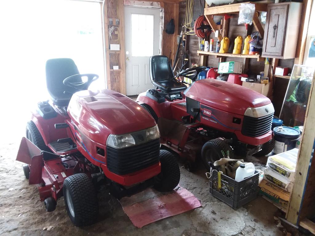

We have a 2002 520xi with about 500hrs we recently bought.
While mowing the other day, it would just shut down and after waiting about 10 minutes it started and ran good until finished mowing.
Here's my and Dads plan...
Already changed oil and filter.
We will replace all fuel line and filter. New plugs. And clean fuel tank and continue using 91 octane ethanol free gas from local Country Fair.
Clean carburetor.
Any other obvious things we should do?
Thanks Cory
The newer 520xi is on the left.

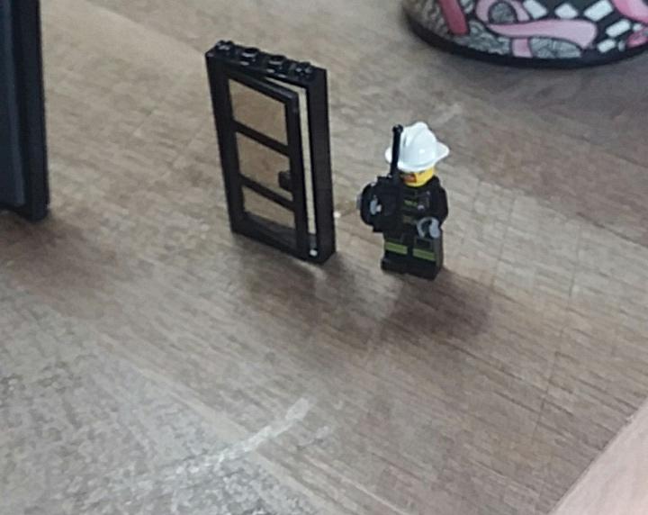

Update:
Big chunks of plastic should NOT be in a newly cleaned fuel tank!
We worked on this tractor a little bit at a time. And I may not have kept a close enough eye on the kids.
Replaced fuel lines, carb clean, plugs ect... turns out that the problem  is that I pulled the gas tank filter (again)  and right then I knew what the problem was.
I have young kids! Hahaha
Found lots of these Lego parts and other junk.
Conclusion for tonight is after working through that, after getting everything back together (I think) it ran flawlessly for 30 minutes!
Cory
  • Like 1
  • Haha 2

Great to hear you found the toys. I love simple, but strange solutions.
