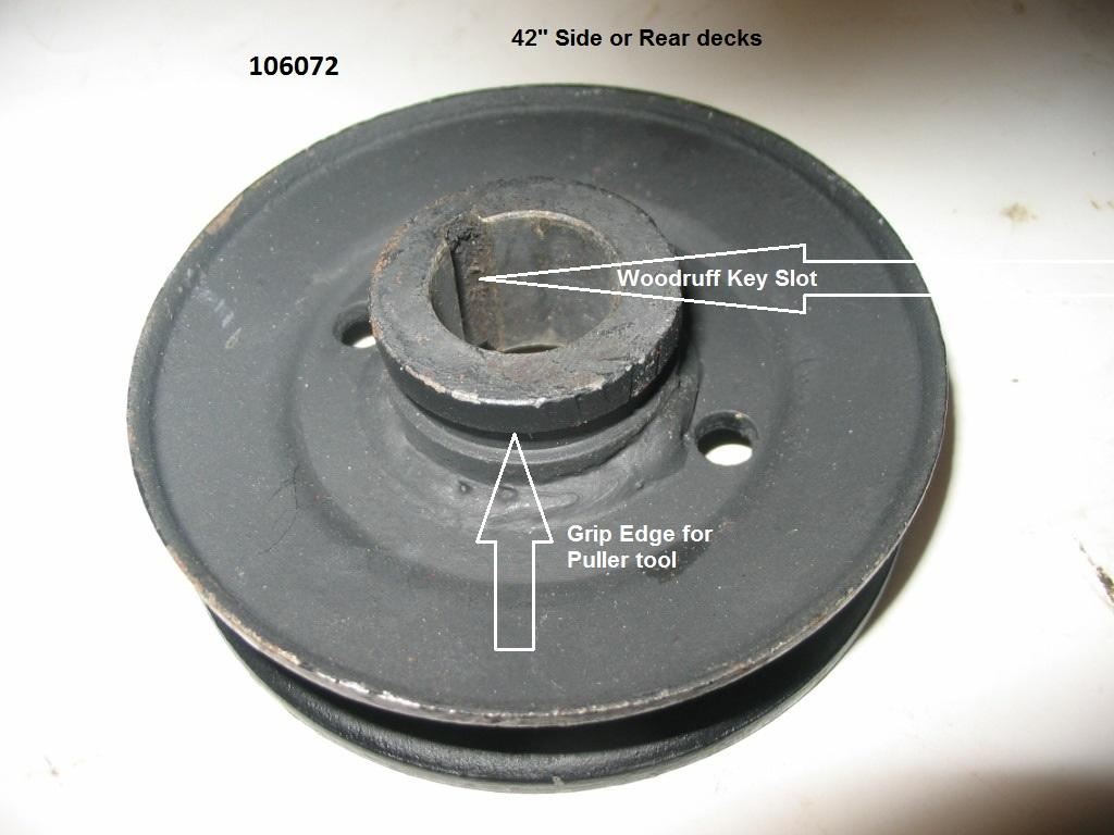

daveoman1966 3,612 #6 Posted September 4, 2018 SOME of the 42" side pulleys have a ridge / lip used to lift off the pulley using a Power Steering Pump Pulley Remover tool. Auto Zone will rent you this tool for FREE, as long as you return it undamaged, and promptly. Here is the 42" Left / Right side puley I refer to. It is pulley # 102072 and has a keyway slot. There are also some 48" decks that use a similar pulley. 1 Share this post Link to post Share on other sites
FatJackDurham 318 #7 Posted September 4, 2018 Mine doesn't have any of those indications. I have most of the pullers I need, it's just not budging. I'll cut the first one off, see if I am missing something. Share this post Link to post Share on other sites

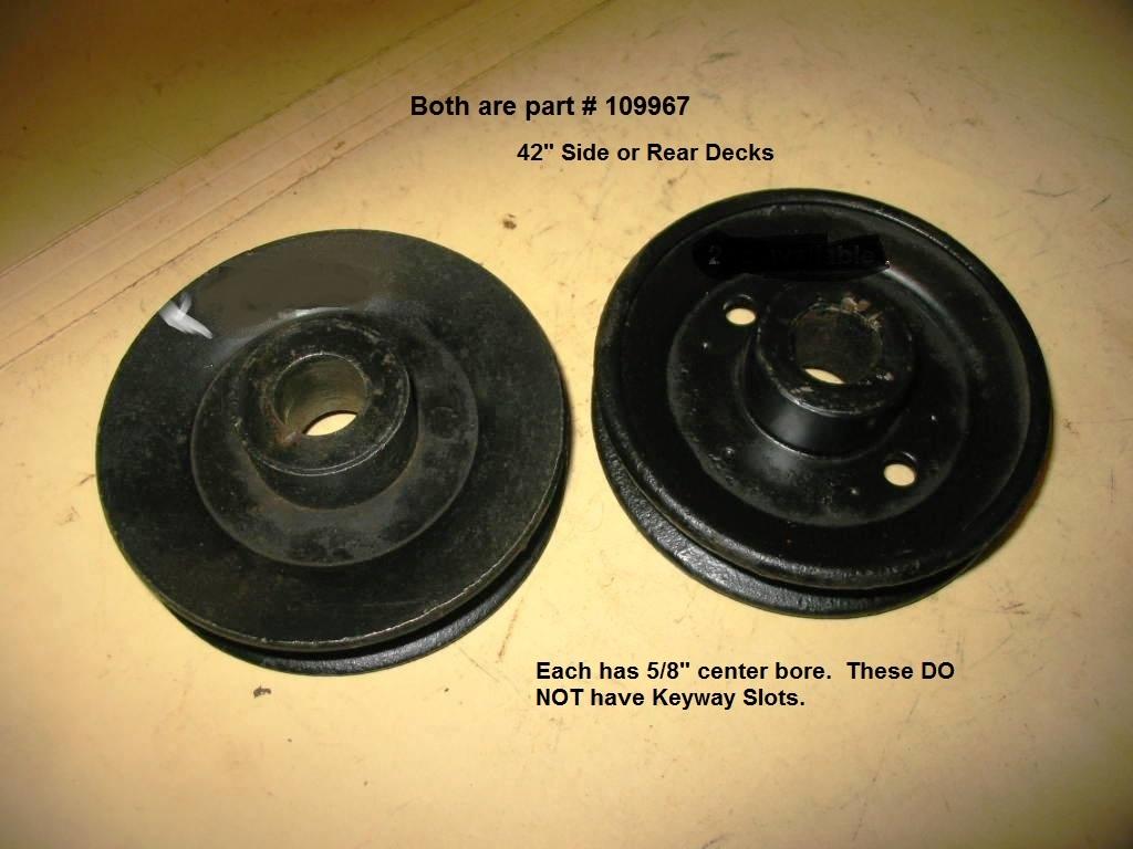

daveoman1966 3,612 #9 Posted September 11, 2018 Your are looking for pulley # 109967. I have none. 1 Share this post Link to post Share on other sites
