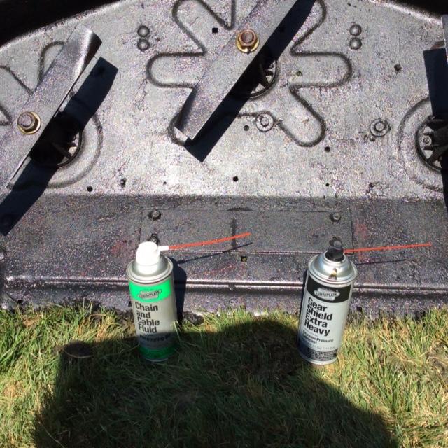

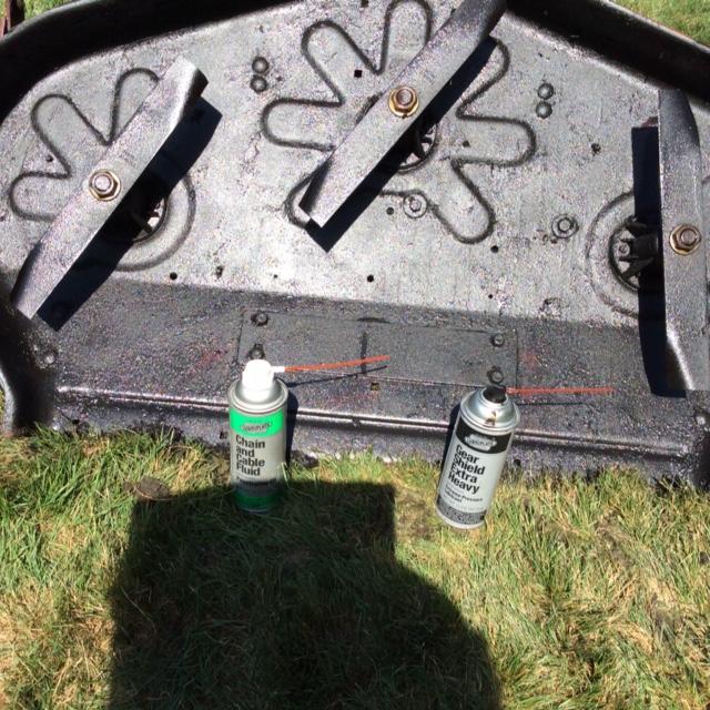

peter lena 10,087 #1 Posted September 2, 2018 Just dropped and cleaned the deck, added spray lubricant. I use lubriplate chain and cable fluid , use the lighter green can first as a creeper to soak cleaned deck, sitting in hot sun that almost dries out and then ,I use the heavy gear shield, basically 680 wt. gear oil. I do this 3 times a year, last coating for winter , let it sit upside down over winter, zero rust ,absolutely the way to preserve your deck. by the way this is the best automotive rust proofing I have ever used, the lighter green can first to soak in and penetrate , then a few days later over spray with the gear shield, especially in doors and rocker areas. drive out the moisture , replace with lubricant. used this as a millwright, lubriplate chain and cable spray, pete 14 7 Share this post Link to post Share on other sites

ronhatch 410 #3 Posted September 2, 2018 When it comes time to clean out grass clipping and stuff, does it come loose easily? 1 Share this post Link to post Share on other sites
Tankman 3,528 #4 Posted September 2, 2018 Just went to the barn, deck cleaned and soaked with spray penetrating oil. Might penetrating spray grease work also? Your deck looks great! 2 Share this post Link to post Share on other sites
peter lena 10,087 #5 Posted September 2, 2018 the deck cleans very easily, I find once the heavy gear shield sets up , it will easily scrape off leaving clean paint under it, but it never comes off in use. I don't know if spray grease will work, I don't think it has the lubricity of the heavy oil. I have used this combo for years and its just as effective on my cars, the bottoms of both cars look like the deck does, I touch up as needed , but this stuff just stands up very well. my auto mechanic marvels at its protection, pete 4 Share this post Link to post Share on other sites
Tankman 3,528 #6 Posted September 3, 2018 (edited) Well Pete, thanks for a great tip! Cleaned the (a) deck, sprayed with Kimball Midwest penetrating oil. Let that soak overnight. A coating of Kimball Midwest penetrating grease next day. Deck looks like new. Thanks again. https://www.kimballmidwest.com/All-Products/Chemicals/Lubricating-Compounds/Penetrants/801301 https://www.kimballmidwest.com/All-Products/Chemicals/Lubricating-Compounds/Aerosol-Greases/80925 Edited September 3, 2018 by Tankman 3 Share this post Link to post Share on other sites
peter lena 10,087 #7 Posted September 3, 2018 good going on that tank man, I always think ," breaking the damp grunge cycle " is the start to saving your stuff. typically, your deck lives like a mushroom, wet, grungy, neglected. I've been doing this for years , so I don't even think about it . if I am lucky enough to be cutting dry , a deck drop and brush out is easy . but if its been wet or heavy , I will counter that with deck drop, clean out and lube in the sun. lubrication of any type will stop the acidic effect of grass on decks, along with hot sun . just regularly getting after it , is key, pete Share this post Link to post Share on other sites
peter lena 10,087 #8 Posted September 4, 2018 tank man , I think that penetrating grease , is fluid film, relabeled, that is good stuff in a confined / contained area. but I don't think it will stand up to direct abuse under deck, if it stands up for you , fine. let me know, that's where that open gear shield really stands up. most important , you did the two steps needed to clean and lubricate you deck, experiment and find what works best for you, pete Share this post Link to post Share on other sites
