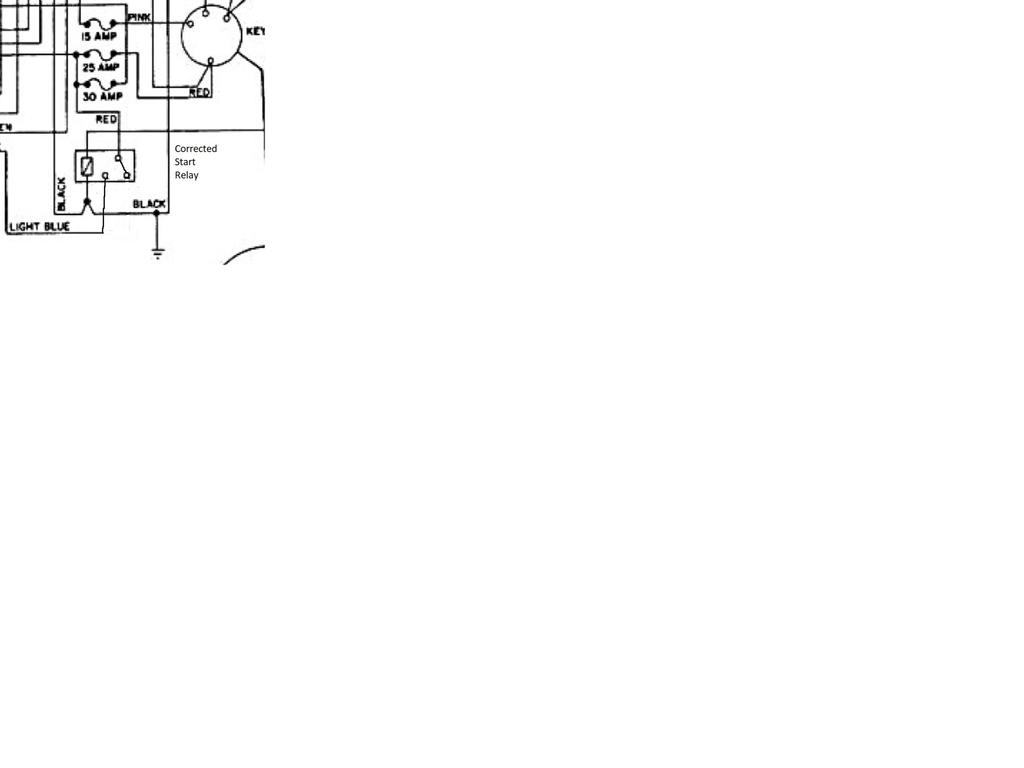

gwest_ca-(File Mod) 12,418 #15 Posted September 2, 2018 Correct - oil pressure switch is not in the starter circuit. Just noticed a mistake in the main wiring diagram. The start relay is not illustrated properly. The little magnetic coil in the relay is magnetic only when the coil is powered and that is when it pulls the contact towards it to activate the starter circuit. Share this post Link to post Share on other sites

gwest_ca-(File Mod) 12,418 #17 Posted September 2, 2018 Page on 116397 starter relay. Click on picture and then again on the page that comes up to enlarge them. Garry Share this post Link to post Share on other sites
