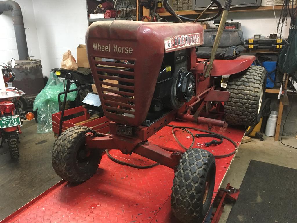

pequeacubs 3 #1 Posted August 29, 2018 I was wondering what the stock belt size was for these lawn rangers. I just picked this up it has a newer 5hp briggs on it. i was hoping to get the stock belt length so i have some where to start. 1 Share this post Link to post Share on other sites
pfrederi 20,227 #2 Posted August 29, 2018 Old WH # 1576 replaced by 9691 70" x 1/2" belt 1 Share this post Link to post Share on other sites
WHX?? 55,996 #3 Posted August 29, 2018 I would start with a 70 incher but get a 69 and 71 and see what fits best. Never know if the PO changed pulley sizes or relocated the motor a little. Can always return the one that don't fit the best as long as they have not been run a lot or scuffed up. . Saves the multiple trips to the v-belt store. Nice looking LR BTW 1 Share this post Link to post Share on other sites
