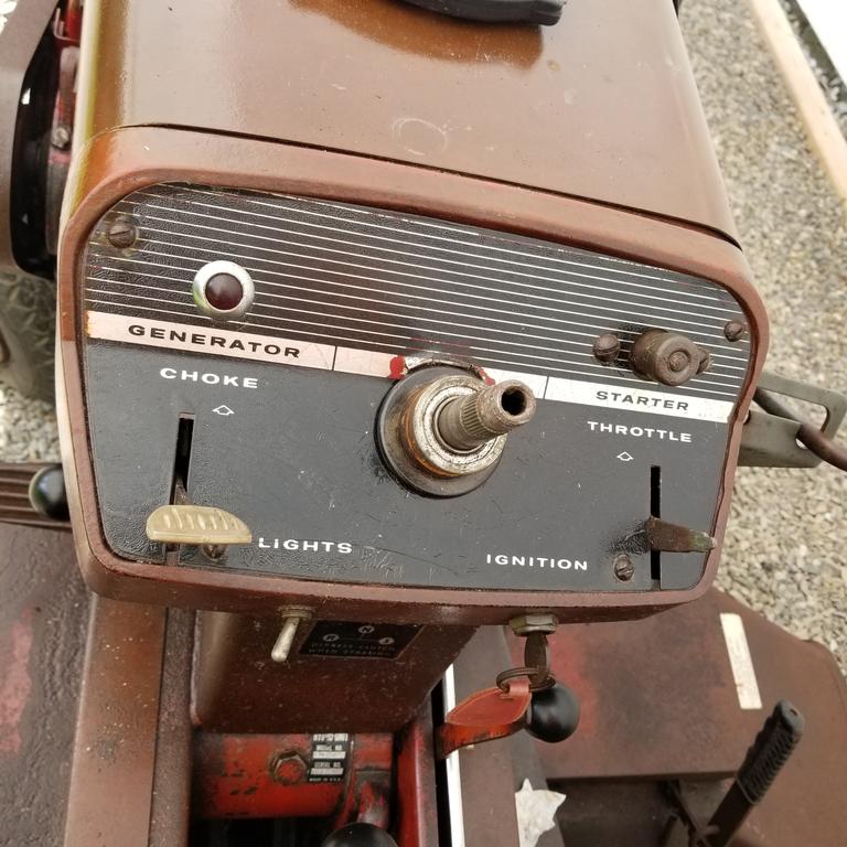

HorseWhisperer 243 #1 Posted August 27, 2018 (edited) Not sure what's missing besides little shiny spheres just below the steering wheel.All works well below just need a pic/available upper bearings for my early 953 Edited August 27, 2018 by HorseWhisperer 1 Share this post Link to post Share on other sites

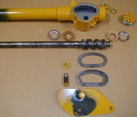

953 nut 70,344 #2 Posted August 27, 2018 Take a look at this thread, should answer all your questions. http://gardentractortalk.com/forums/topic/10576-snappermf-1650-ross-steering-rebuild-help/ PS; I will be heading up to the Syracuse area in a couple of weeks. If you want that pesky early 953 out of your way I could bring along a trailer. 4 Share this post Link to post Share on other sites

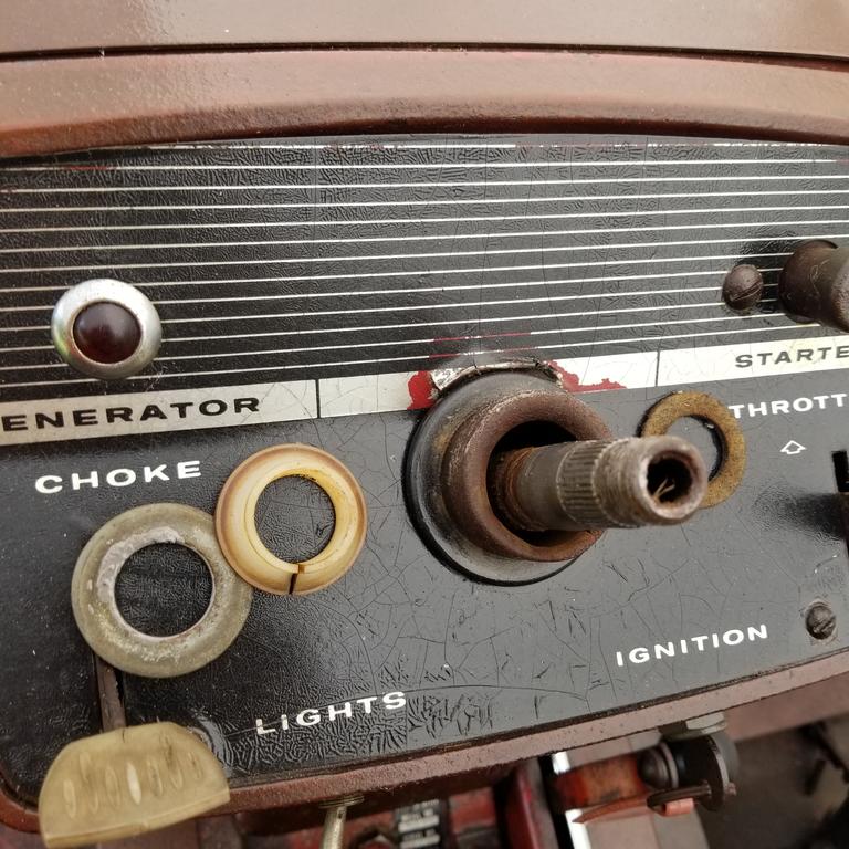

HorseWhisperer 243 #5 Posted August 27, 2018 I have been through this thread and have found the upper ross bearings on a "E" site before but I guess I'm thick and need to see what I'm looking at.The inner plastic race is there,the felt washer and the washer on top but I think the lower plastic race is missing? 1 Share this post Link to post Share on other sites

RandyLittrell 3,946 #8 Posted August 28, 2018 If the ross steering is just like the ross on cub cadets, you can pull the little race off and use a standard wheel bearing in its place. Randy 2 2 Share this post Link to post Share on other sites
HorseWhisperer 243 #9 Posted August 28, 2018 10 hours ago, RandyLittrell said: If the ross steering is just like the ross on cub cadets, you can pull the little race off and use a standard wheel bearing in its place. Randy I am gonna mic that baby up and head to tractor supply.Thanks my friend 3 Share this post Link to post Share on other sites
RandyLittrell 3,946 #10 Posted August 28, 2018 If I remember right, the wheel bearing fit nice on the shaft and it's just a titch loose on the tube. One wrap of tape or a little dimple or two and your good to go. 2 Share this post Link to post Share on other sites
HorseWhisperer 243 #11 Posted August 28, 2018 13 hours ago, RandyLittrell said: If the ross steering is just like the ross on cub cadets, you can pull the little race off and use a standard wheel bearing in its place. Randy Well Randy,This is the greatest gift I've got in a spell.The butchered race came off and I realized why I save all them old rims - it's like new now.Thanks again for that info 1 1 Share this post Link to post Share on other sites
