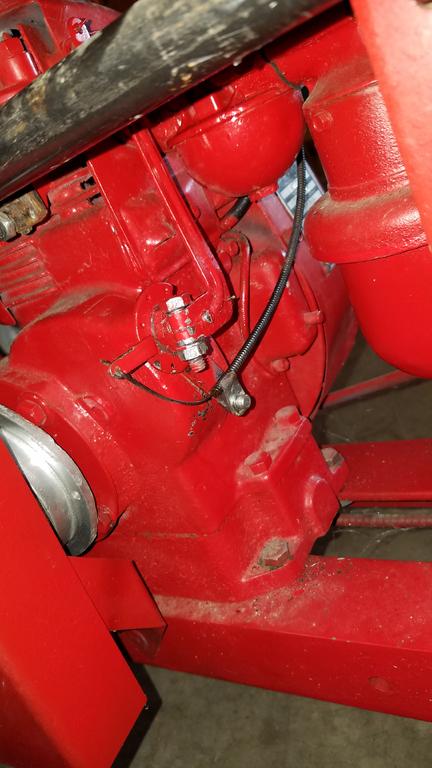

Shed 377 #27 Posted August 30, 2018 Does anyone have a picture of a factory k90 throttle setup mine isn't right at the carb Share this post Link to post Share on other sites
peter lena 9,901 #28 Posted August 30, 2018 nice pick up, but as a grandpa, that little boy did it for me, Pete 1 1 Share this post Link to post Share on other sites

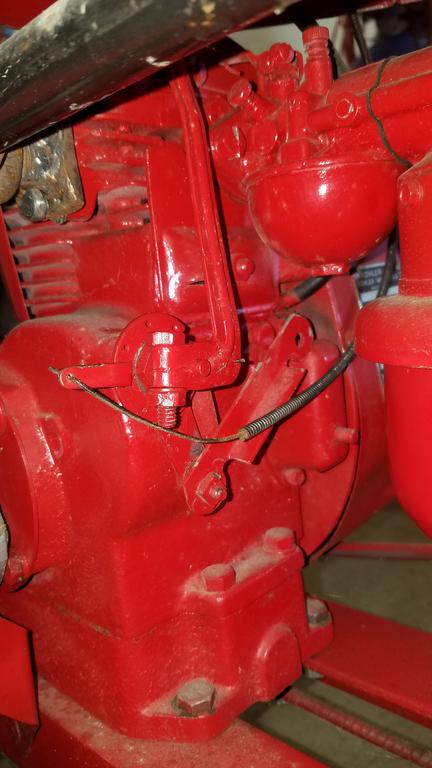

Shed 377 #30 Posted August 30, 2018 What's missing with this carb linkage it doesn't seem right 1 Share this post Link to post Share on other sites
peter lena 9,901 #31 Posted September 2, 2018 looks like the pivot linkage back to carb is missing , you might find a picture to help out out there, models and years are different. also that cable pull should be secured as close to the end as possible for mechanical advantage, along with a through lubrication of that cable for easy use. pete Share this post Link to post Share on other sites

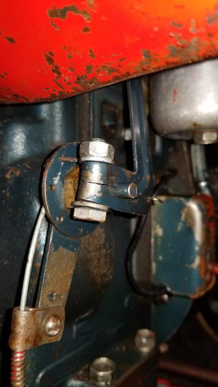

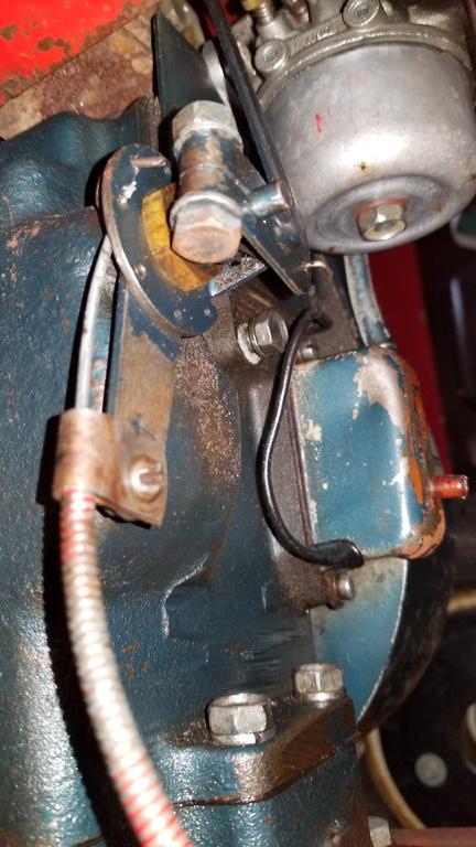

Shed 377 #33 Posted September 2, 2018 Ok so I removed that random bracket off and came up with this I have a tab sticking off and asand asI turned it the Gov spring got tighter so I found a spot where things were neutral and made a cable clamp and that's what I ended up with I did lubricated the cable and housing. My glass fuel bowl was gummed up so I took it apart I need to make a new cork gasket unless they sell them and re do the fuel line also I seen there is no oil or mesh in the air filter so I read a few things in here and seen guys put stainless mesh and non detergent oil in the filters. Share this post Link to post Share on other sites
953 nut 66,616 #34 Posted September 3, 2018 I think you may want to get a longer cable so it will come up straight from the bottom like Craig's. Looks like that may bind on you. 1 Share this post Link to post Share on other sites
