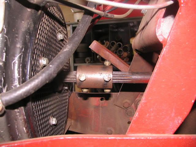

pacer 3,181 #2 Posted August 24, 2018 On the D's the flywheel screen simply has a hole cut in the center to allow for a splined shaft bolted to the flywheel that connects to an 'adapter' that mates to the hyd pump. I have a Massey Ferguson GT with a K341 that also has a similar setup driving a drive shaft back to a PTO drive point and then on to the Hyd pump. Neither of these are ideal, the D at least has a rubber spacer between that will allow some 'give' to the drive, but still can have a short life span. The MF has 3 solid splined connectors that allows NO 'give' accelerating the wear. And of course parts are NLA!! Heres a pic of mine with a mod I have done in an attempt to take slack out by adding set screws - I have a few hrs on it now and so far is still tight... Share this post Link to post Share on other sites

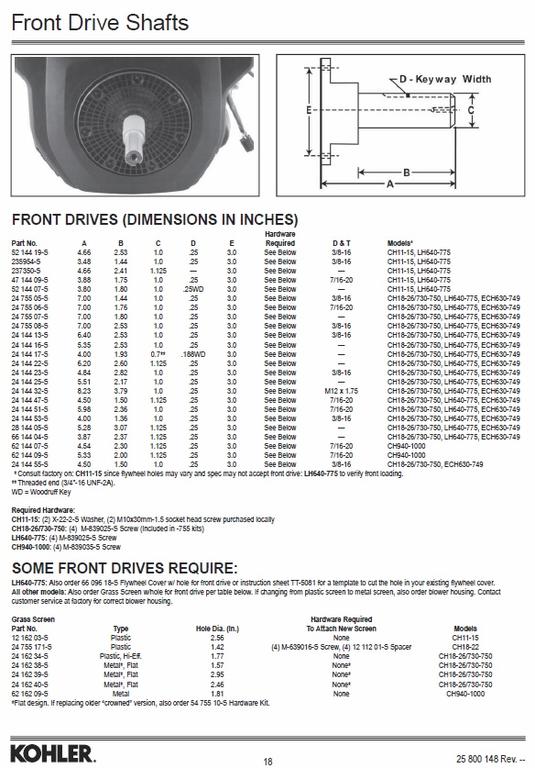

gwest_ca-(File Mod) 12,532 #3 Posted August 24, 2018 Kohler has had front shafts available for a long time but this page from a 2011 catalog only lists them available for the Command engines as that is what their current production was. I did compare to an older catalog and most were the same parts but listed for the K-Series of engines. Have to do some digging to find it. Garry Share this post Link to post Share on other sites
