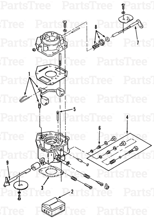

WHX?? 54,508 #5 Posted August 23, 2018 interesting Cleat, since running the choke partly on one can assume it was running lean or air going by the loose plug? Where was the plug located? 1 Share this post Link to post Share on other sites
cleat 8,715 #6 Posted August 23, 2018 It is a small little plug located just above the idle jet. 1 Share this post Link to post Share on other sites

Cee245 852 #8 Posted August 23, 2018 @cleat, Can you show us pictures and how did you get the Welch plug to properly seal? I have a P216 and it's developed a surge that I haven't figured out yet. Thanks Cory 2 Share this post Link to post Share on other sites
lynnmor 8,544 #9 Posted August 23, 2018 A welch plug is a one time use part. Clean the bore where it goes, then apply a small amount of fuel resistant sealant to the edge of a new plug and place it in the bore. Now take a punch and hammer and gently tap on the dome of the plug till it tightens in the bore. It doesn't take much and you should still have some dome shape when done. Hopefully you can find new plugs at an auto parts store. Measure the bore, I believe it is 3/8". Onan doesn't include the welch plug in their kits, but some cheap Chinese kits have them. 1 Share this post Link to post Share on other sites
gwest_ca-(File Mod) 11,977 #10 Posted August 24, 2018 If the plug is tight and you want to seal it on the outside clean well. Get some nail polish your wife no longer cares for and apply a couple of coats to the edge of the cup. If it has some color it helps to see if your application is complete. Seal-All is another product that will withstand gasoline but I would not want to use it if installing a new plug. Too much chance of using too much and causing internal problems. Garry Share this post Link to post Share on other sites
