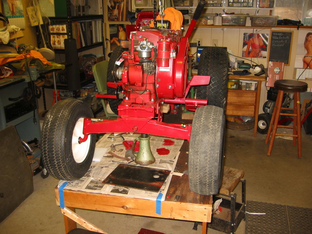

CasualObserver 3,416 #2 Posted August 21, 2018 I had a wooden worktable for a while. I built it at 24" tall on casters. I thought it was a nice height for me at 6'tall. Tall enough I could reach around most things standing but also could sit on one of my adjustable stools too. Share this post Link to post Share on other sites

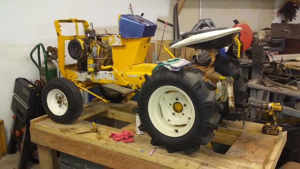

RandyLittrell 3,944 #5 Posted August 21, 2018 (edited) Here is mine, ignore the yellow thing on there! Its 18" to 24" I think, I can measure tonight. I highly suggest you either winch it on there or I put the tractors in low and idle them up without me on and kill the ignition at the top of the ramp. Edited August 21, 2018 by RandyLittrell 2 1 Share this post Link to post Share on other sites

RandyLittrell 3,944 #8 Posted August 21, 2018 2 hours ago, Daron1965 said: I like the cut outs on the deck. Another great idea I will use. Thank you. The whole middle is open and I put boards underneath so you can use 2 by material and slide them front to back. So I can remove all or just put pieces under to use a jack. Randy 1 1 Share this post Link to post Share on other sites

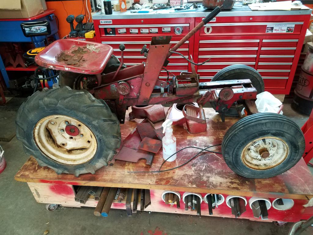

pfrederi 20,675 #10 Posted August 21, 2018 My bench is about 24" high. Don't mess with ramps just hoist her up or down 2 1 Share this post Link to post Share on other sites
