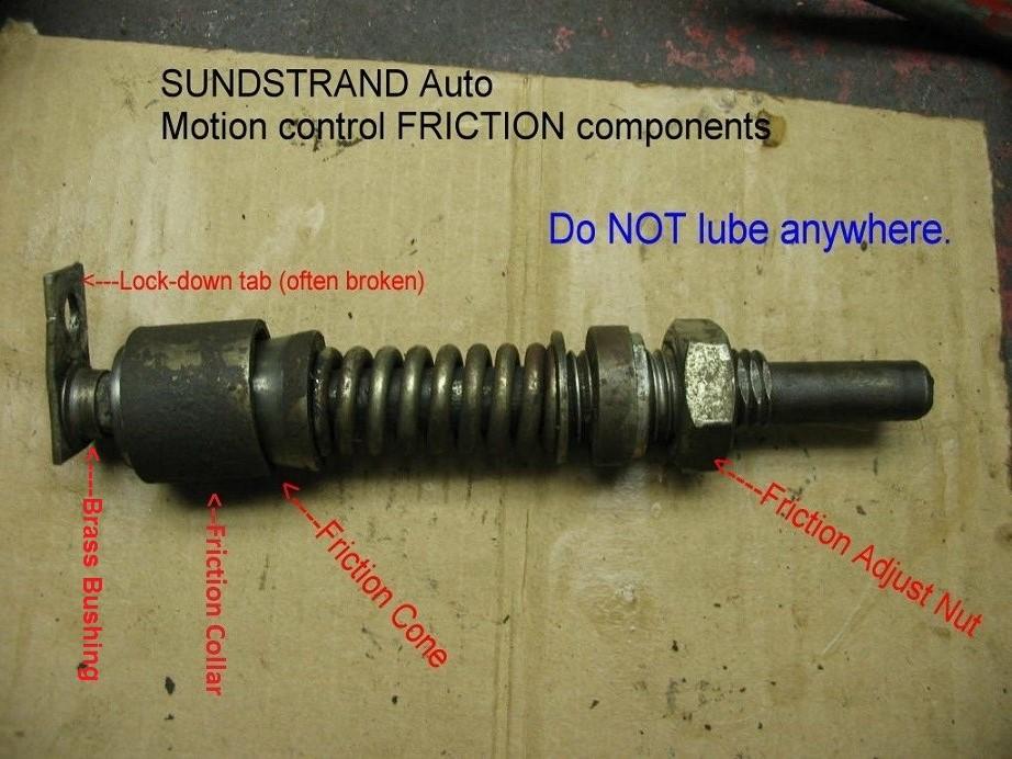

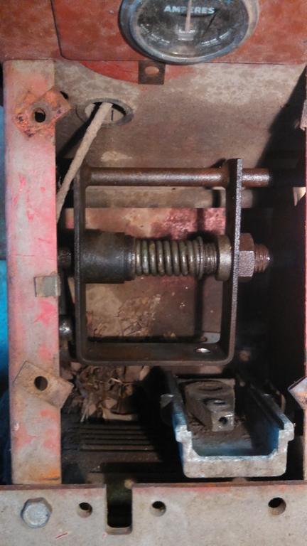

c-series don 12,609 #4 Posted August 19, 2018 The Work Horse doesn't have that friction adjustment. It has an Eaton transmission. I believe that adjustment can be done at the seat pan were the friction nut is. Share this post Link to post Share on other sites
