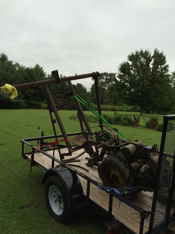

jcb857 161 #4 Posted August 19, 2018 This is what it looked like before I put it on trailer 2 Share this post Link to post Share on other sites
ebinmaine 63,133 #5 Posted August 19, 2018 That is some kinda unique. Lookin forward to seeing this build. Share this post Link to post Share on other sites

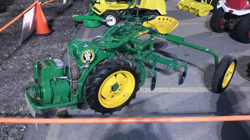

Chris G 3,274 #6 Posted August 21, 2018 Those are awesome machines. Just seen this one over the weekend at a local fair 3 1 Share this post Link to post Share on other sites

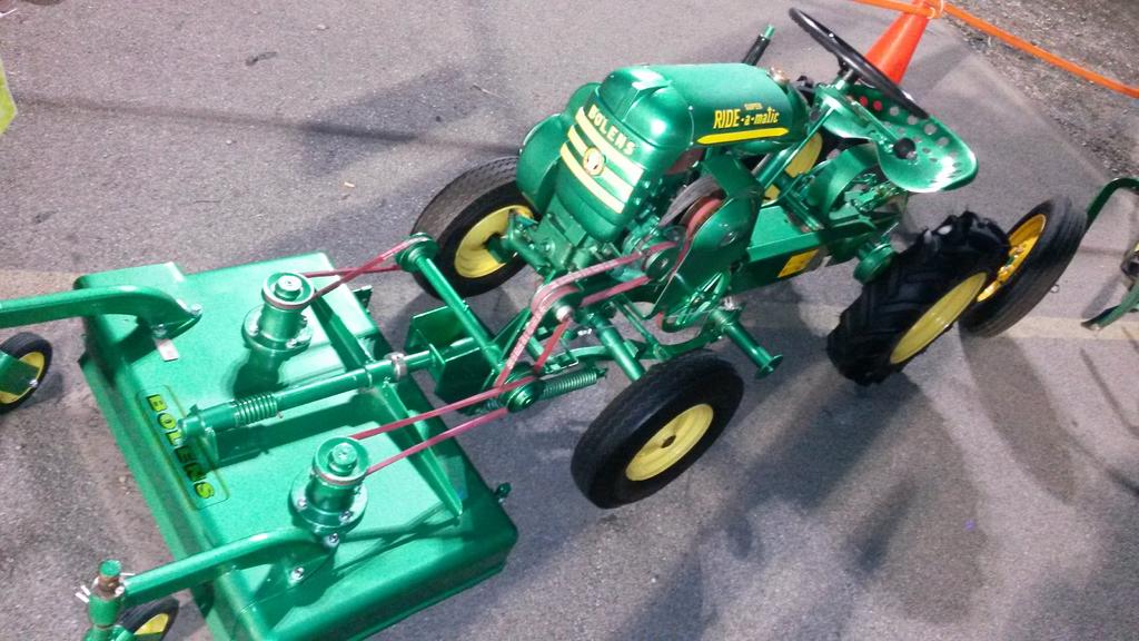

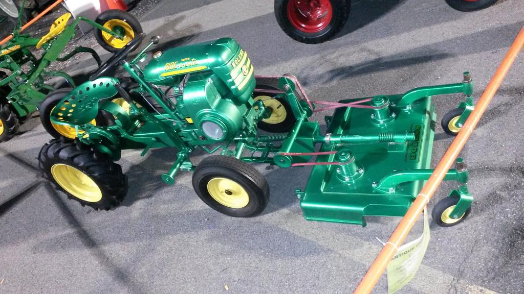

Chris G 3,274 #8 Posted August 23, 2018 6 hours ago, jcb857 said: That ridemaster looks great. Ya the gentlemen that shows that particular bolens, has got several really sharp machines. This is a Ride-A-Matic that he fully restored. 3 1 1 Share this post Link to post Share on other sites
WHNJ701 4,164 #9 Posted August 23, 2018 (edited) 7 minutes ago, Chris G said: Ya the gentlemen that shows that particular bolens, has got several really sharp machines. This is a Ride-A-Matic that he fully restored. he is on a couple other forums goes by bolens1000, and he has an online business for some parts, he does some nice restorations. I have a 57 super ride a matic in line to be restored someday, but I keep getting sidetracked by these wheelhorses that I keep bringing home Edited August 23, 2018 by jabelman 1 Share this post Link to post Share on other sites

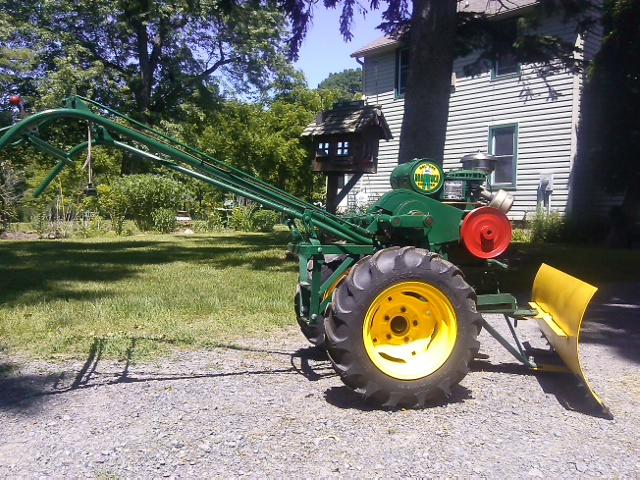

rjg854 10,737 #11 Posted August 23, 2018 On my Bolens , I basically used Greenbay Packers colors 1 Share this post Link to post Share on other sites

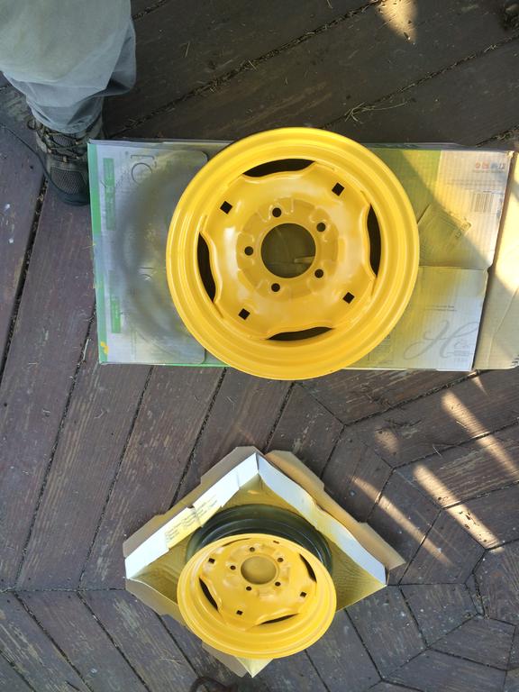

jcb857 161 #12 Posted September 4, 2018 It has been a little slow but I had a fee nice days to work on the ridemaster. New back rims and tires came in sand blasted rims and put some color on them. New holland yellow Share this post Link to post Share on other sites

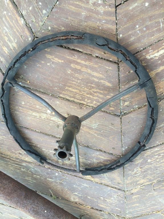

jcb857 161 #13 Posted September 4, 2018 Lots of work to be done on steering wheel. But it is going to turn out good Share this post Link to post Share on other sites

ebinmaine 63,133 #15 Posted September 5, 2018 2 hours ago, jcb857 said: work to be done on steering wheel Please post pics of this process. I'm fascinated to see how that will be done. Share this post Link to post Share on other sites

WHNJ701 4,164 #17 Posted September 5, 2018 (edited) 2 hours ago, jcb857 said: Lots of work to be done on steering wheel. But it is going to turn out good that's a project buts it can be saved, I have redone a few just as bad, it takes time, a dremel, bondo, jb weld, 12 pack miller lite, and lots of sanding, prime and paint. I guess i could have replaced a few but I always try to keep the original steering wheel on the tractors I redo Edited September 5, 2018 by jabelman 4 Share this post Link to post Share on other sites
ebinmaine 63,133 #18 Posted September 5, 2018 1 minute ago, jabelman said: bondo, jb weld, 12 pack miller lite What are the proper percentages and ratios and sequences and suches and so forth here ?? 2 Share this post Link to post Share on other sites

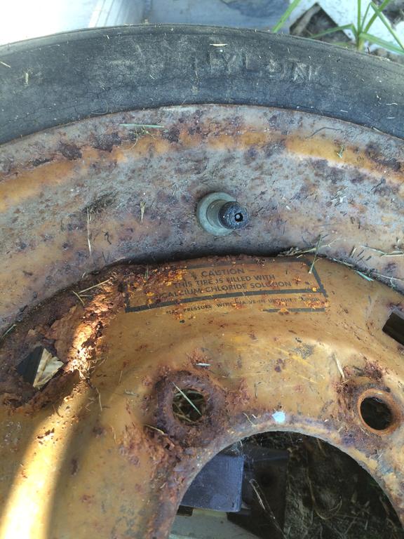

jcb857 161 #19 Posted September 5, 2018 10 hours ago, jabelman said: that's surprising on the rims guess they weren't factory loaded, bolens used some nasty stuff that rotted rims I am surprised by how good of shape the rear rims are in.They still have some of the decals on them. Maybe they never filled them or the original owner only had the high clearance attachment on during crop growing season and sat in dry barn for rest of the rest of the year. I will get a couple pics of them for you. Share this post Link to post Share on other sites
jcb857 161 #20 Posted September 5, 2018 Pic of decal on back rim. No fluid in them. Not perfect but nice originals for there age. 2 Share this post Link to post Share on other sites

rjg854 10,737 #22 Posted September 8, 2018 On 8/23/2018 at 7:52 PM, rjg854 said: On my Bolens , I basically used Greenbay Packers colors 3 2 Share this post Link to post Share on other sites
jcb857 161 #23 Posted September 8, 2018 Nice job. Have you ever used it to move snow? I always wonderd how much those walk behinds could push. Share this post Link to post Share on other sites
rjg854 10,737 #24 Posted September 8, 2018 You bet I used it to push snow, for probably 10 years. I originally bought it to regrade my yard after a septic system install. I figured if it could push that much dirt, snow wouldn't be a problem. The thing is all chain drive with a clutch for each wheel. Thats how you turn it, by disengaging one of the clutches and then spinning on the disengaged wheel. There's no reverse. Nothing stops this beast. You could put it against a tree with the clutches engaged and the wheels will continue to turn. Never had to use snow chains . It was actually a lot of fun to use. Then I discovered Wheel Horse, been riding ever since 1 Share this post Link to post Share on other sites
