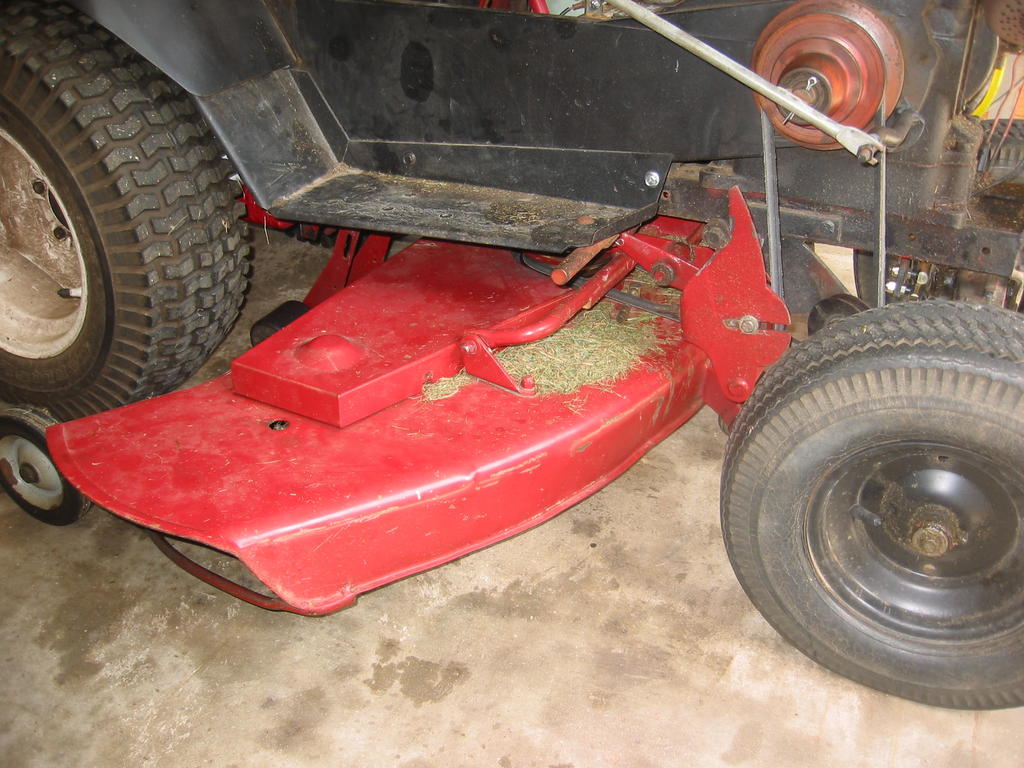

pfrederi 21,051 #1 Posted August 17, 2018 Been working with a older deck 5-1000 i believe (no data plate.). The max height cut I can get is about 2-3/4 inches. Put a couple 1/2" boards under rear wheels to simulate going to larger wheels...raised the back of the deck but not the front. Unlike newer decks there doesn't seem to be a leveling adjustment. Any thoughts on how to get it up to 3 or 3-1/4" cut??? Share this post Link to post Share on other sites

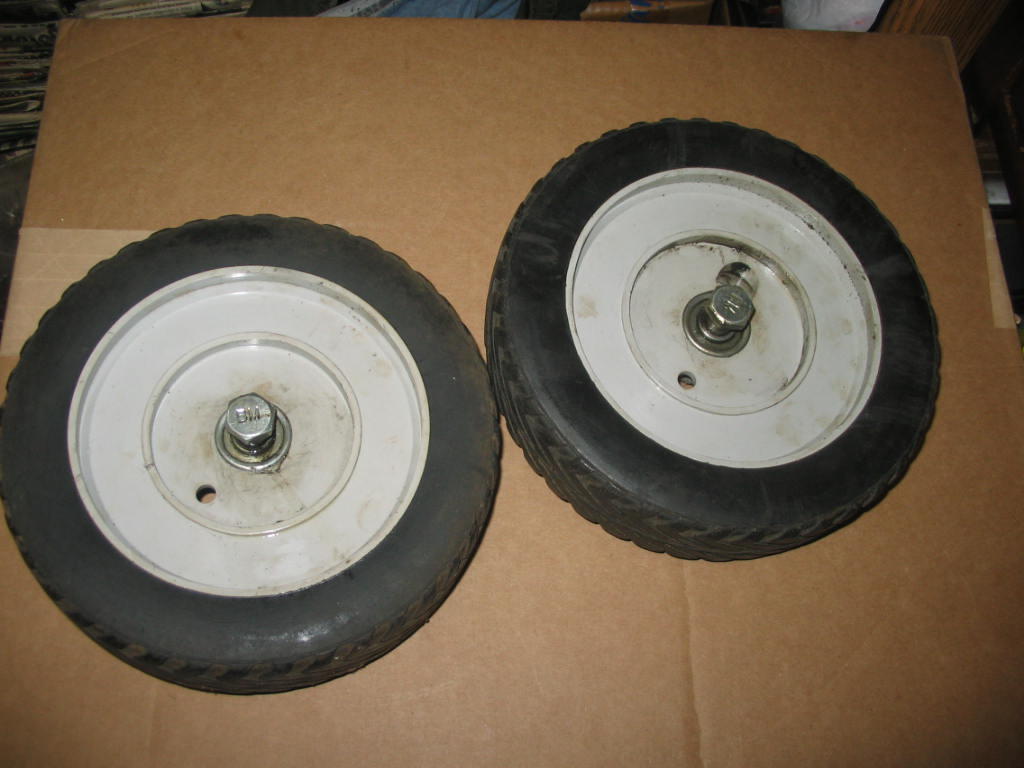

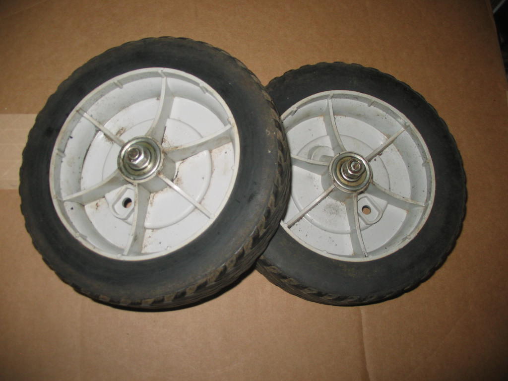

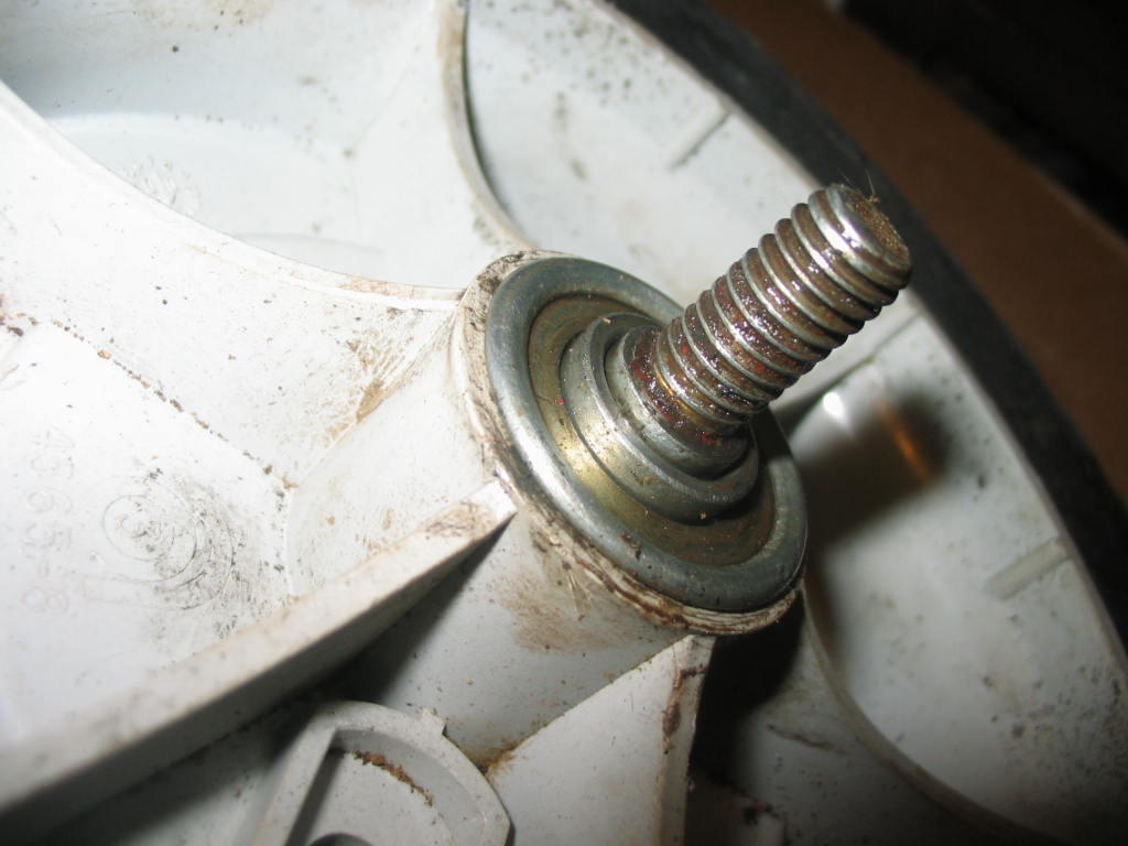

daveoman1966 3,884 #2 Posted August 17, 2018 (edited) I have a pair of deck wheels...they are 2" wide x 8" dia with shoulder bolts and steel bearings. Bolt threads are 1" or so. These would probably solve the cut height issue and give you much more range...$32... SHIPPED to USA zips Edited August 17, 2018 by daveoman1966 Share this post Link to post Share on other sites
peter lena 10,016 #3 Posted August 17, 2018 https://www.tractorsupply.com/tsc/product/martin-wheel-6x1-3-8-plastic-deck-wheel-1-2-in-bushing-1-3-8-in-offset-hub?rfk=1 I have these wheels on 3 decks, and they give me the high cutting height I want, they also stand up very well , and at 14 $ a pair, ordered from tractor supply I think it will help your problem. I do not have any older decks , but the added wheel height gives me a very good cutting height without a burn. I would also check your lift point hook up , maybe you can modify for more height, pete Share this post Link to post Share on other sites
Ed Kennell 46,998 #4 Posted August 17, 2018 1 hour ago, pfrederi said: Unlike newer decks there doesn't seem to be a leveling adjustment. Any thoughts on how to get it up to 3 or 3-1/4" cut??? Paul, do you have the pin that rides on the curved center support channel? The location of that pin should balance the front to rear height. You may have to drill new holes to adjust the pin location to get the front up level. Share this post Link to post Share on other sites
pfrederi 21,051 #5 Posted August 17, 2018 Are you talking about the pin #47? It is currently in the second hole as shown in parts diagram. The long slot below was used on earlier model decks 5-1421 that used a long bent rod to adjust the height. Guess WH used the same bracket assembly #38 on different decks.. Do you think if I moved the pin to the top hole that would help?? Share this post Link to post Share on other sites
Ed Kennell 46,998 #6 Posted August 17, 2018 Yep, #47 pin should control the front height. Try a different hole to see if it makes a difference. You may have to drill new holes or modify the pin support bracket to get the height you want. 1 Share this post Link to post Share on other sites
pfrederi 21,051 #7 Posted August 18, 2018 Dug out a pair of 7 inch wheel for the deck put them on but as i anticipated it just raised the back of the deck so there was way to much difference between blade height at front and back. I know you want a little for best cut but this was almost 1/2". Using Ed's suggestion moved the rod #47 to the top hole in the axle assembly...success!! little over 3" now and just a shade lower in front. Thank you all 2 Share this post Link to post Share on other sites
