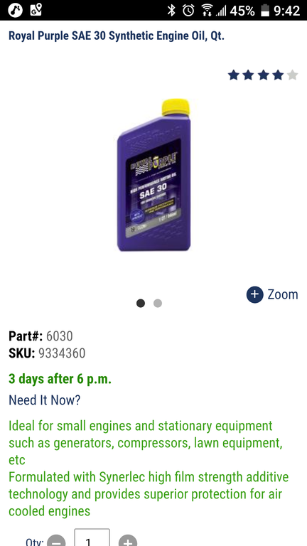

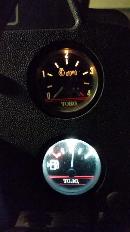

WHX?? 56,623 #32 Posted August 17, 2018 Never heard of Royal Purple Jeff. Here's what those SB leds look like in a dash. and a right to them. https://www.superbrightleds.com/moreinfo/ba9s-ba7s/ba9s-led-bulb-4-led-ba9s-retrofit-car-classic-car-bulbs/6/58/ Share this post Link to post Share on other sites

WVHillbilly520H 10,378 #35 Posted August 18, 2018 12 hours ago, WHX20 said: Never heard of Royal Purple Jeff. Jim, it's gearhead oil, was made formainly high performance engines with flat tappet cams when they started dropping the ZDDP levels because of emissions/ converters, Jeff. 1 Share this post Link to post Share on other sites

Schrec050584 2 #40 Posted August 22, 2018 Engine oil for 12hp kohler is sae 30 right or can i run 10w 30 synthetic? Share this post Link to post Share on other sites
WHX?? 56,623 #41 Posted August 22, 2018 Correct ...strait 30 weight although 10w30 syn will not hurt it. 10w might be the better choice for cold weather starts & running. Share this post Link to post Share on other sites
