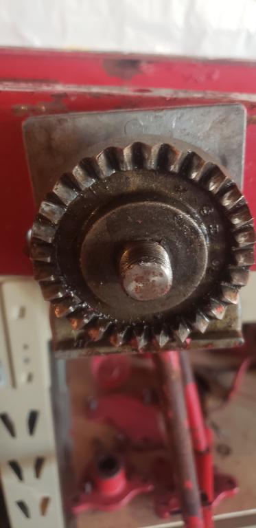

71_Bronco 1,073 #30 Posted June 2, 2019 On 2/15/2019 at 11:08 AM, DerekMorrissey said: So on my tractor the owner had a 32' rotary motor [parts number 3262] and I'm trying to get these bevel gears off and cant for the life of me, anyone know how to get these off or could steer me in the right direction? I had to remove one from my rotary mower not too long ago. According to my parts diagram (slightly different model than yours), that gear is keyed onto the shaft. I used a 3-jaw puller and slowly pulled it off, making sure it had lots of PB Blaster (penetrating oil) on it. It slid off slowly, using a standard wrench, but didnt fight. Was just a tight press fit, and luckily wasnt fused to the shaft. Didnt need to break out the impact. To get it back on, I lined up the key, and slowly tapped it on using a socket to fit around the shaft. Share this post Link to post Share on other sites
71_Bronco 1,073 #31 Posted June 2, 2019 On 2/15/2019 at 11:08 AM, DerekMorrissey said: So on my tractor the owner had a 32' rotary motor [parts number 3262] and I'm trying to get these bevel gears off and cant for the life of me, anyone know how to get these off or could steer me in the right direction? I had to remove one from my rotary mower not too long ago. According to my parts diagram (slightly different model than yours), that gear is keyed onto the shaft. I used a 3-jaw puller and slowly pulled it off, making sure it had lots of PB Blaster (penetrating oil) on it. It slid off slowly, using a standard wrench, but didnt fight. Was just a tight press fit, and luckily wasnt fused to the shaft. Didnt need to break out the impact. To get it back on, I lined up the key, and slowly tapped it on using a socket to fit around the shaft. Share this post Link to post Share on other sites
71_Bronco 1,073 #32 Posted June 2, 2019 On 2/15/2019 at 11:08 AM, DerekMorrissey said: So on my tractor the owner had a 32' rotary motor [parts number 3262] and I'm trying to get these bevel gears off and cant for the life of me, anyone know how to get these off or could steer me in the right direction? I had to remove one from my rotary mower not too long ago. According to my parts diagram (slightly different model than yours), that gear is keyed onto the shaft. I used a 3-jaw puller and slowly pulled it off, making sure it had lots of PB Blaster (penetrating oil) on it. It slid off slowly, using a standard wrench, but didnt fight. Was just a tight press fit, and luckily wasnt fused to the shaft. Didnt need to break out the impact. To get it back on, I lined up the key, and slowly tapped it on using a socket to fit around the shaft. Share this post Link to post Share on other sites
71_Bronco 1,073 #33 Posted June 2, 2019 On 2/15/2019 at 11:08 AM, DerekMorrissey said: So on my tractor the owner had a 32' rotary motor [parts number 3262] and I'm trying to get these bevel gears off and cant for the life of me, anyone know how to get these off or could steer me in the right direction? I had to remove one from my rotary mower not too long ago. According to my parts diagram (slightly different model than yours), that gear is keyed onto the shaft. I used a 3-jaw puller and slowly pulled it off, making sure it had lots of PB Blaster (penetrating oil) on it. It slid off slowly, using a standard wrench, but didnt fight. Was just a tight press fit, and luckily wasnt fused to the shaft. Didnt need to break out the impact. To get it back on, I lined up the key, and slowly tapped it on using a socket to fit around the shaft. 1 Share this post Link to post Share on other sites

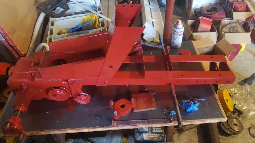

DerekMorrissey 18 #42 Posted July 8, 2020 Just started to prime some peices of my 502! Turning out great 1 Share this post Link to post Share on other sites

DerekMorrissey 18 #45 Posted February 28, 2021 Wanted to update yall on the progress of my 502, its coming along great, the color is going down perfect and im really liking the way the tractor is turning out, and I want to thank everyone for the help, comments, and compliments along the way. Share this post Link to post Share on other sites
