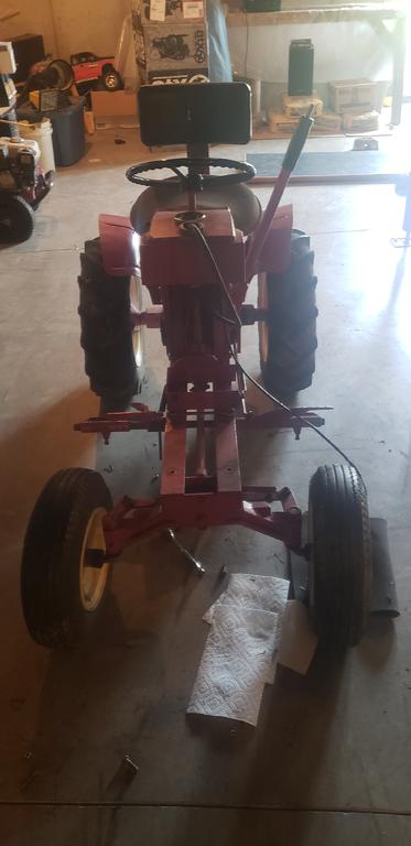

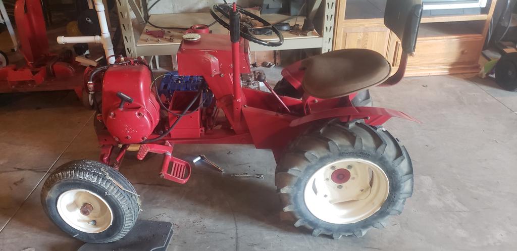

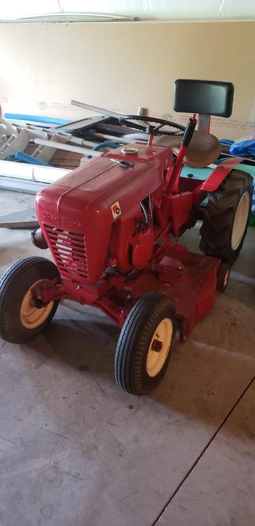

DerekMorrissey 18 #8 Posted August 14, 2018 I think its probably the best looking 502 I've seen in a while especially with the documentation I have 2 4 1 Share this post Link to post Share on other sites

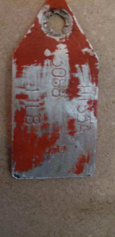

DerekMorrissey 18 #12 Posted August 14, 2018 Theres the engine tag like I said it says ht55a 3088 but I'm not sure what the p and 11L8 mean Share this post Link to post Share on other sites

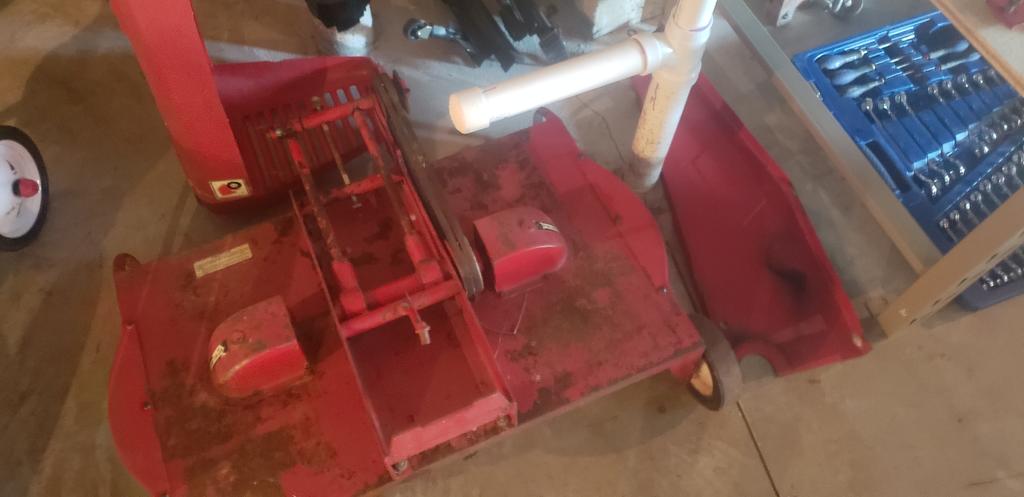

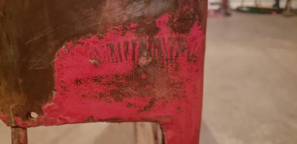

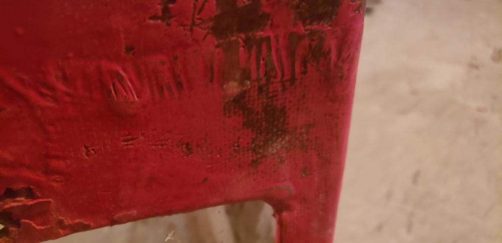

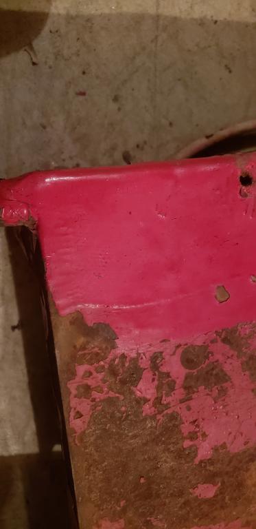

DerekMorrissey 18 #16 Posted December 20, 2018 (edited) I know it's been a while but I'd like to post an update I've been continuing the tear down process and have been learning a lot. I just got finished with taking the mower deck apart and have found some interesting patch jobs in the metal, could anyone let me now when these could have been used? I think that it possibly looks like fiberglass but who knows. Edited December 20, 2018 by DerekMorrissey Share this post Link to post Share on other sites
Elkskin's mower junkyard 1,117 #17 Posted December 20, 2018 9 minutes ago, DerekMorrissey said: I know it's been a while but I'd like to post an update I've been continuing the tear down process and have been learning a lot. I just got finished with taking the mower deck apart and have found some interesting patch jobs in the metal, could anyone let me now when these could have been used? I think that it possibly looks like fiberglass but who knows. Sand it down to bare metal. Go from there. If it was me I would cut out bad sections weld in new. Take ur time get it flat. Do you live in Indiana? 1 Share this post Link to post Share on other sites
DerekMorrissey 18 #18 Posted December 20, 2018 Just now, craftsmanmowerfreak said: Sand it down to bare metal. Go from there. If it was me I would cut out bad sections weld in new. Take ur time get it flat. Do you live in Indiana? Yeah that's probably what I'm going to do, I'm in ohio but the tractor came from Indiana 1 Share this post Link to post Share on other sites
Elkskin's mower junkyard 1,117 #19 Posted December 20, 2018 4 minutes ago, DerekMorrissey said: Yeah that's probably what I'm going to do, I'm in ohio but the tractor came from Indiana I got 2 62 models a 502 and 552 neither have original engines one was my dads and its a show tractor. The 552 has gotten a kohler transplant and will be repainted in spring and labeled has a 702 Share this post Link to post Share on other sites
DerekMorrissey 18 #20 Posted December 20, 2018 2 minutes ago, craftsmanmowerfreak said: I got 2 62 models a 502 and 552 neither have original engines one was my dads and its a show tractor. The 552 has gotten a kohler transplant and will be repainted in spring and labeled has a 702 Sounds great yeah one of the funny things I noticed was that this guy had a price sheet and if you look closely he checked 552 but then erased it and went back to a 502 1 Share this post Link to post Share on other sites
Elkskin's mower junkyard 1,117 #21 Posted December 20, 2018 8 minutes ago, DerekMorrissey said: Sounds great yeah one of the funny things I noticed was that this guy had a price sheet and if you look closely he checked 552 but then erased it and went back to a 502 That's odd. Sometimes I only seen it maybe once or twice but 502s were taken back to dealer to have electric start put on. I was going to transfer electric start to the h70 I stuck on 552 but looked into the charging system and decided against it due to chance of overcharging battery. That and lack of governor response compared to a kohler. Pretty bad when a 1958 k160 kohler that smokes on my 753 over powers a 7hp Tec. Those were my 2 reasons I swapped in a kohler. Now the 502 on other hand I got a 8hp Kohler magnum pull start engine and stuck it on it my dad loved it. Share this post Link to post Share on other sites
WHX?? 57,470 #22 Posted December 20, 2018 Thinking out loud here a PO may have not been a welding type of guy so patched it however he knew. Freak hit tho cut it out and shape and weld in new metal. UNLESS this is just going to be show, then fill in with epoxy, lots of sanding and paint. Do that right and nobody will know but us and we ain't talking. 5 1 Share this post Link to post Share on other sites
