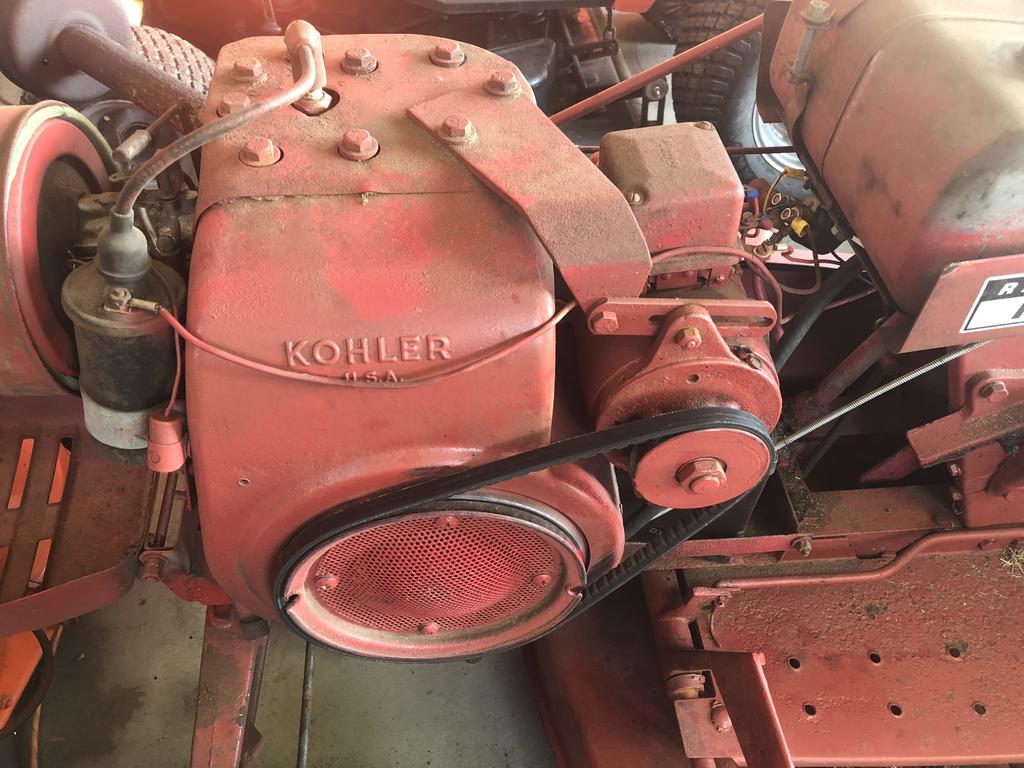

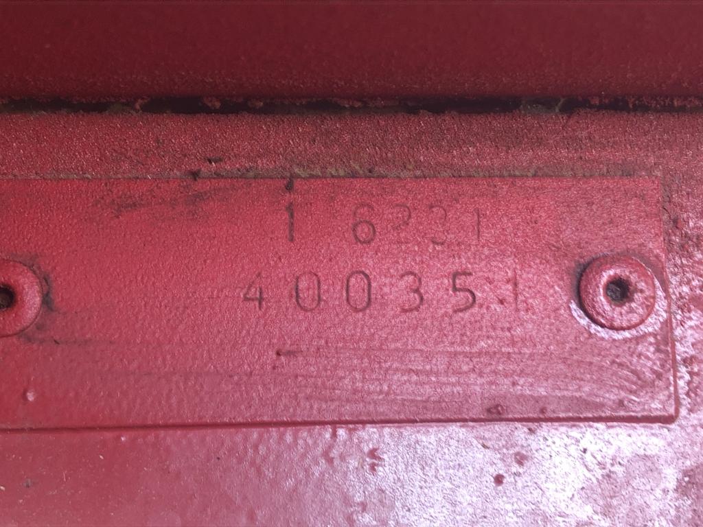

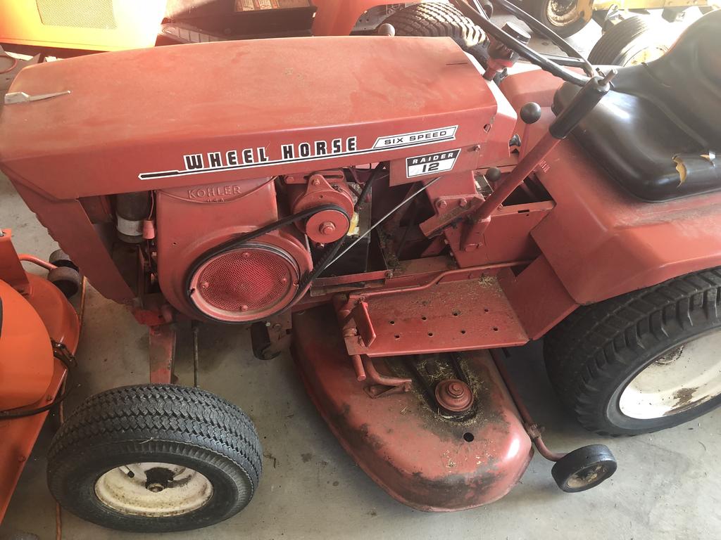

Preacher 6 #1 Posted August 14, 2018 I’m seriously confused. I recently purchased this tractor. I was told that it was a 1968. When looking at different models online, I couldn’t find a 1968 with a combination generator/starter on one. The Model and Serial Number tag is almost destroyed by painting over it. I can make out a few numbers. 1 6281 400351 Can someone help me identify exactly what this tractor is? Thanks and God Bless 2 Share this post Link to post Share on other sites
ol550 844 #2 Posted August 14, 2018 Your tractor is a 1968 Raider 12. The engine without the model tag will remain a mystery. Possibly changed at some point or a carry-over engine from 1967. 1 Share this post Link to post Share on other sites
gwest_ca-(File Mod) 12,006 #3 Posted August 14, 2018 Your model number is 1-6231 - an early 1968 model using a starter generator. Mid-year production switched to a Bendix starter and alternator charging system but the tractor model number stayed the same. That looks like a very original model. Click on the chart below Garry 2 1 Share this post Link to post Share on other sites
Sparky-(Admin) 24,640 #4 Posted August 14, 2018 I’m thinking this is what you have... 1-6231 1968 Lawn & Garden Tractor Raider 12 8-Speed Kohler K301S-4712B 12 Wheel 2 1 Share this post Link to post Share on other sites
WHX?? 55,050 #5 Posted August 14, 2018 (edited) 1 hour ago, gwest_ca said: Mid-year production switched to a Bendix starter and alternator Thanks for the clarification Garry. It was my belief that late 67 went to the Bendix with possibly a few carry over S/G's in early 68. @Preacher's Raider is the first I've seen with a S/G which makes it somewhat rare if original. Any tags on the engine Preacher? No matter what nice survivor! Edited August 14, 2018 by WHX20 3 Share this post Link to post Share on other sites

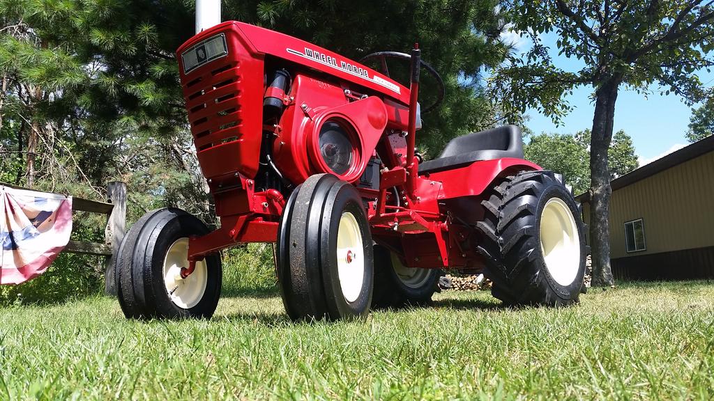

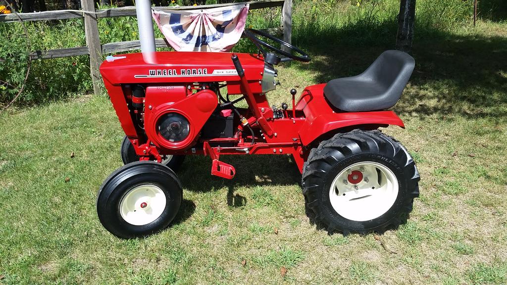

520HC 208 #6 Posted August 14, 2018 Yep 68 Raider 12 like this one 2 1 Share this post Link to post Share on other sites

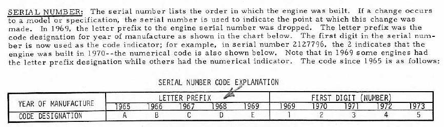

Preacher 6 #7 Posted August 14, 2018 (edited) This is the tag on the engine. But it’s only a 6 speed, unless you’re counting 2 reverse speeds. Edited August 14, 2018 by Preacher Share this post Link to post Share on other sites
WHX?? 55,050 #8 Posted August 14, 2018 (edited) Motor's a '67 with correct spec # Edited August 14, 2018 by WHX20 1 Share this post Link to post Share on other sites

WHX?? 55,050 #13 Posted August 16, 2018 Your BTW in your pic it looks like someone has got the wrong belt on the S/G. Yours appears to ride a little high on the pulleys meaning it might be a 1/2 width (4L) belt. Should be a 3/8" belt or 3L size. I should but don't know/remember the length. 1 Share this post Link to post Share on other sites
953 nut 64,143 #14 Posted August 16, 2018 I think it is a 3L-350, 35". Share this post Link to post Share on other sites
WHX?? 55,050 #15 Posted August 16, 2018 16 minutes ago, 953 nut said: I think it is So what you are saying Richard is when I go to TSC to get one I should get a 34, 35 & 36 incher then I'm guaranteed to have the right one?!?! 2 Share this post Link to post Share on other sites
gwest_ca-(File Mod) 12,006 #16 Posted August 16, 2018 Should use a belt that is not fabric covered. Raw rubber sides give a better grip. Starter/generator belt Kohler 10, 12hp Wheel Horse 1593 (3L x 34.4") - nla 7340 Gates .410" x 34.58" 36 degree 25-7340 Napa .410" x 34.58" 36 degree These last two are automotive belts determined by Kohler original numbers Garry 2 Share this post Link to post Share on other sites
953 nut 64,143 #17 Posted August 16, 2018 3 hours ago, WHX20 said: So what you are saying Richard is when I go to TSC to get one I should get a 34, 35 & 36 incher then I'm guaranteed to have the right one?!?! Like many others, I have the sleeves from various belts stapled too the wall in the shop so I can be sure to get the right belt. Also, like many of our older members I can generally remember stuff like that, but not always. Garry seems to have confirmed the 35". 2 Share this post Link to post Share on other sites

WHX?? 55,050 #22 Posted September 17, 2018 On 8/16/2018 at 6:01 PM, gwest_ca said: Should use a belt that is not fabric covered. Raw rubber sides give a better grip. Starter/generator belt Kohler 10, 12hp Wheel Horse 1593 (3L x 34.4") - nla 7340 Gates .410" x 34.58" 36 degree 25-7340 Napa .410" x 34.58" 36 degree These last two are automotive belts determined by Kohler original numbers Garry BTW that NAPA # is a 25-7350 belt, 7340 is the 34" flavor and a little tight. Share this post Link to post Share on other sites
gwest_ca-(File Mod) 12,006 #23 Posted September 18, 2018 For some model years you have to go to the Kohler parts lists to find the starter/generator belt and the one I used was 235312 for the 10hp-12hp used 1963-1968. Go to Gates and they replace Kohler 235312 with Gates 7340 or the Napa 25-7340 which are both primarily automotive belts. I don't have such a model to check it out. Garry Went through the numbers again and some have been discontinued with no replacements so started over. Starter/generator belt Kohler 10, 12hp 235262 Wheel Horse 1593 (3L x 34.4") - nla (Gates replacement 6735 3/8" x 35" 38 degree) 7345 Gates .410" x 35.09" 36 degree 25-7345 Napa .410" x 35.09" 36 degree 2 Share this post Link to post Share on other sites
