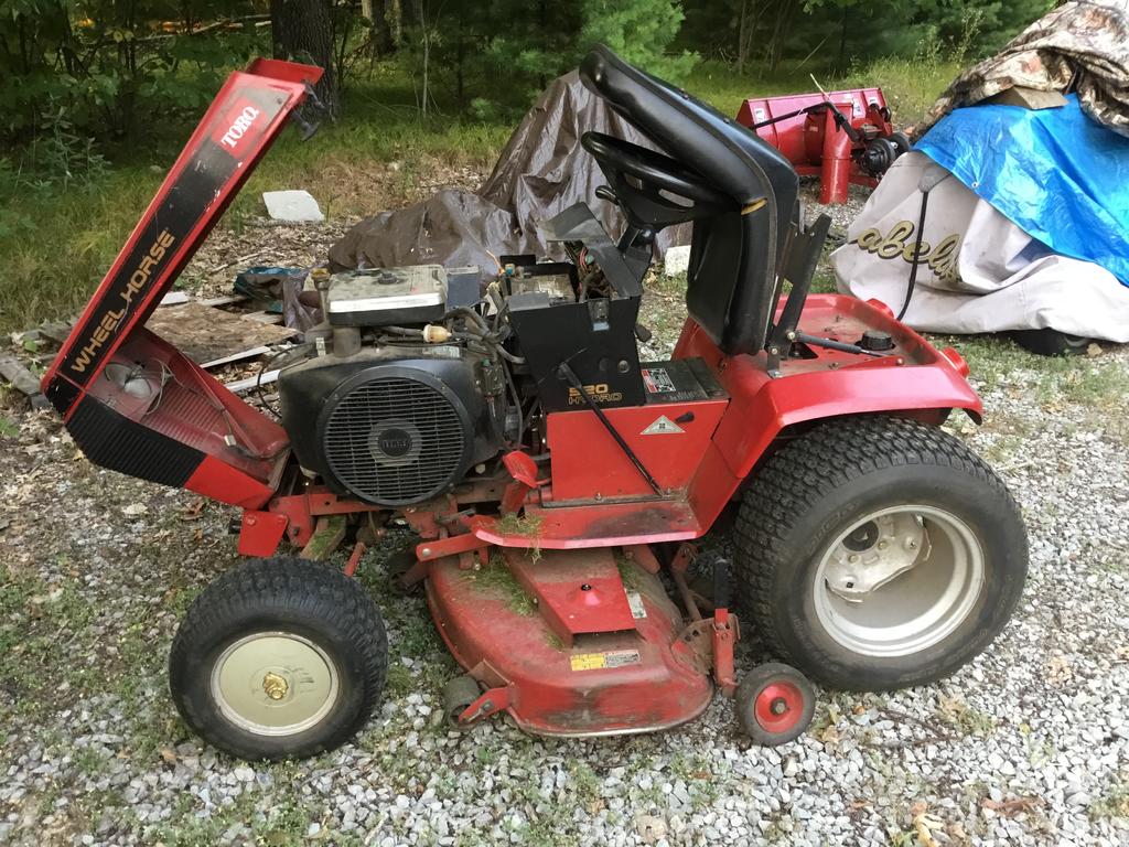

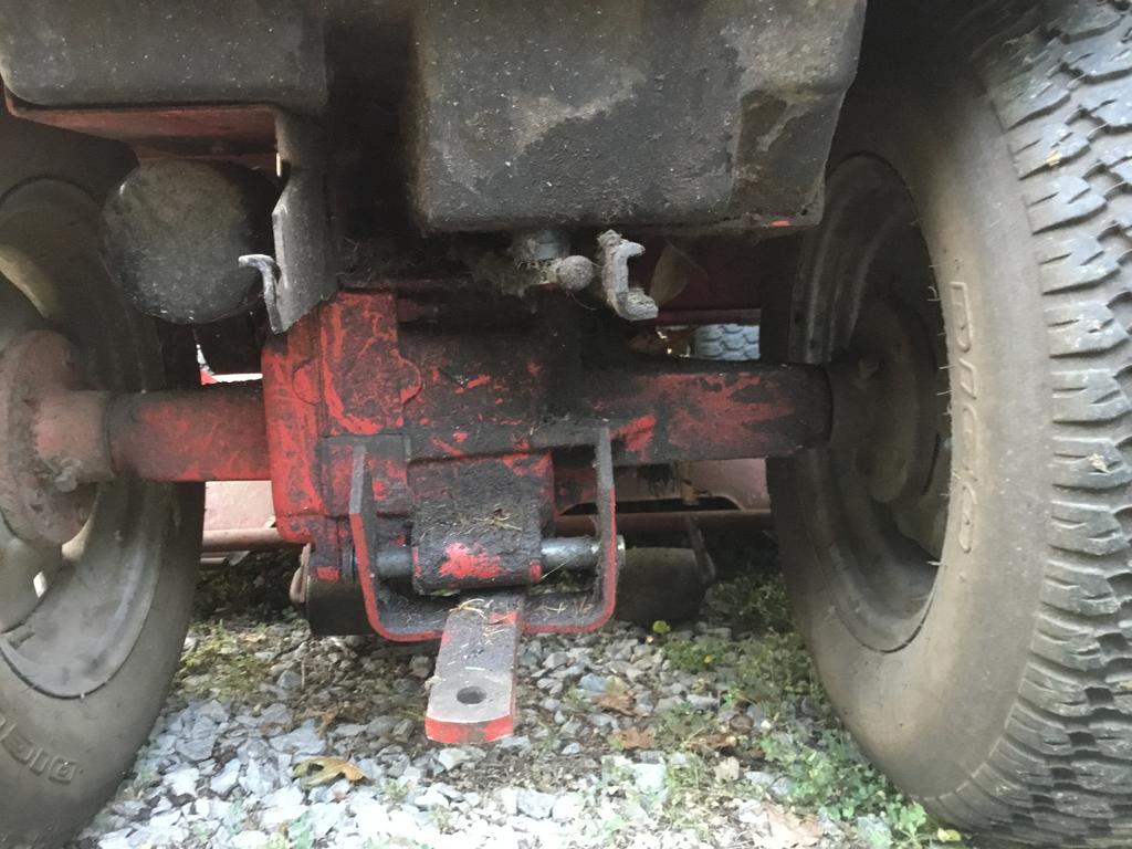

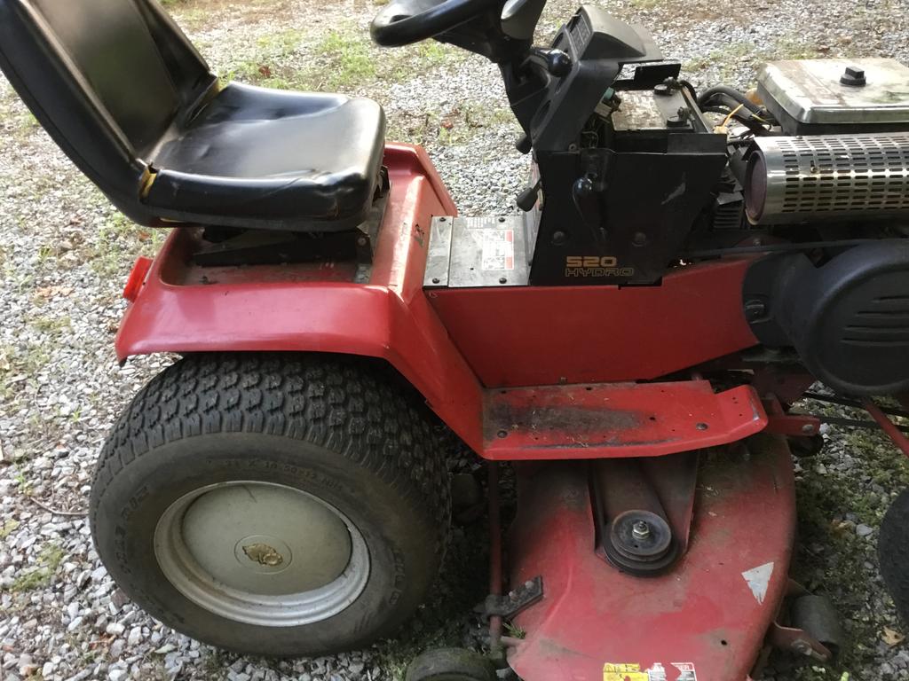

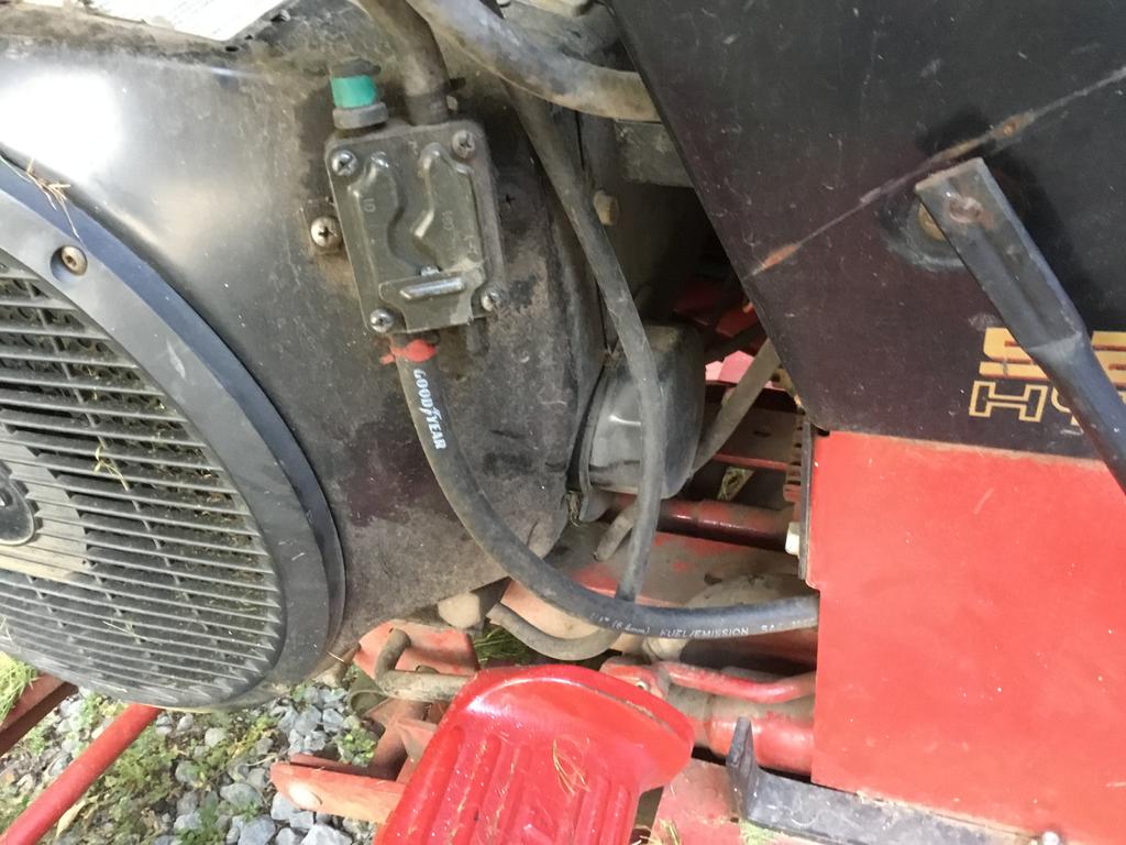

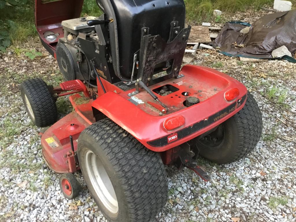

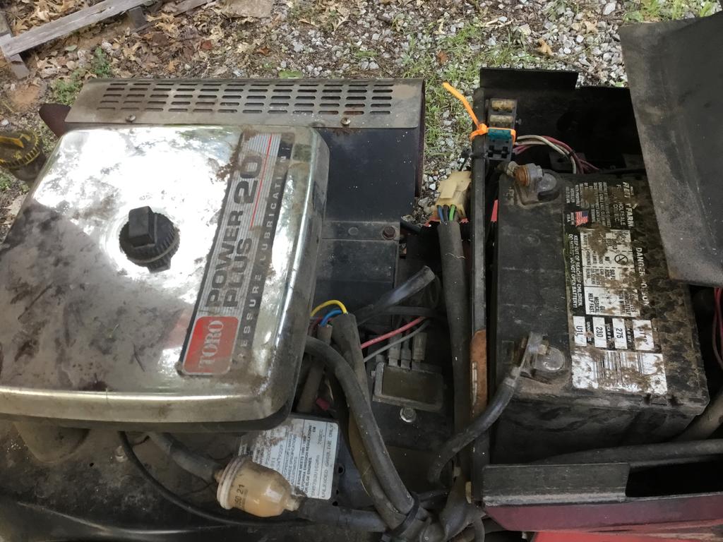

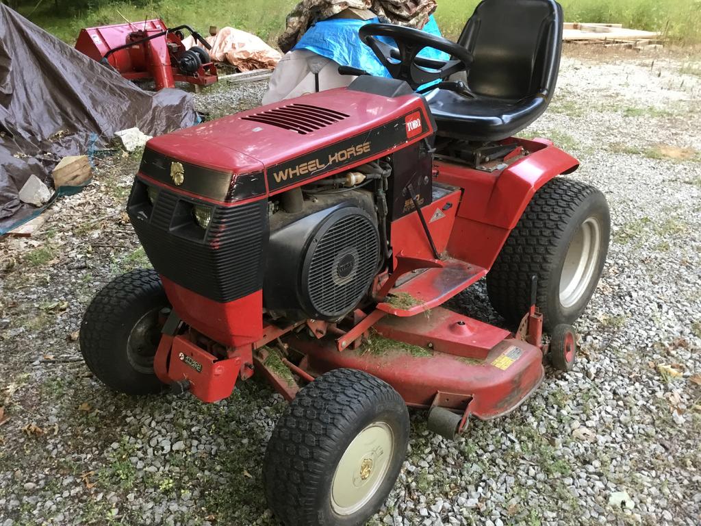

RJC1965 173 #8 Posted August 17, 2018 I bought it for $425. I need to clean up the engine and trans, change oil hydraulic fluid although they were clean and full. I did run and mow with it for a 1/2 hr and the hr meter was working so the 550hr should be accurate. See the pic below, I did get the deck spindle cover but am missing the discharge shut. Deck has new blades and one new spindle. In the up coming weeks I will clean it removing all the tins for engine and fenders for a hydro cleaning and adj the motion lever and fix the brake. Best part on this one is I only drove 5 miles round trip to get it. Thank you you all for your input it made the buying decision much easier. 4 Share this post Link to post Share on other sites

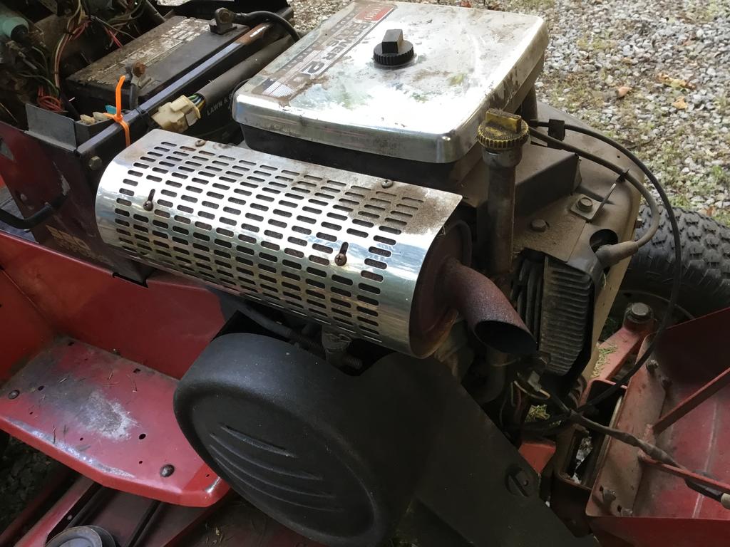

RJC1965 173 #11 Posted August 17, 2018 No rust on the air cleaner or the muffler cover actually no rust on the whole tractor just dirt and grease 1 Share this post Link to post Share on other sites

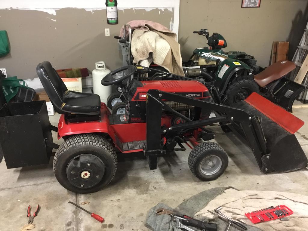

RJC1965 173 #12 Posted August 17, 2018 (edited) One other interesting note this is the second 520 I have and both previous owners said the lights don’t work and they don’t know why on both of these I just pushed hard on the toggle switch and they worked I also sprayed some contact spray on the switch and no problems. Also on my new one all the gauges work and the lights for the gauges also. Below is my other 520h with 650 hrs on it. Edited August 17, 2018 by RJC1965 4 Share this post Link to post Share on other sites
WVHillbilly520H 10,379 #13 Posted August 17, 2018 I have had several decks in the past few years and all but my bought new anniversary 520H are missing the discharge chute...looks like your new unit used to have a snow cab once upon a time probably why the footrest pad is missing, Jeff. Share this post Link to post Share on other sites
mmmmmdonuts 274 #14 Posted August 17, 2018 Great buy. Looks like a great tractor in decent shape. Share this post Link to post Share on other sites
WVHillbilly520H 10,379 #15 Posted August 17, 2018 Now you won't have to dismount that loader on the other to spin that 2stage I see photo bombing your new toy . Share this post Link to post Share on other sites
RJC1965 173 #16 Posted August 18, 2018 I was doing a little photo bombing lol wvhillbilly it was you I believe that said I need 3 520s one for the loader one for the snowchucker and one to mow with. Well I am 66% there. Haha 1 Share this post Link to post Share on other sites
