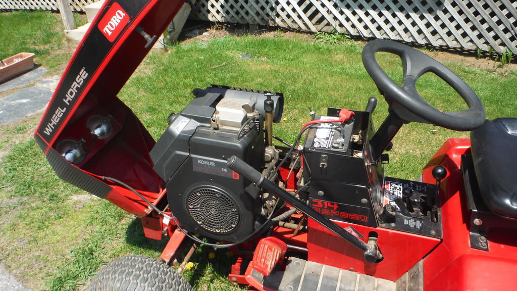

jeff lary 173 #16 Posted August 18, 2018 Yes it says 3-14-8 on the hood.... It has the Kohler engine and a yellow Kohler filter. I found in one of his tractor books, yes I found the original books I think? Where he wrote in pen that the filter in a (WIX) is a 51348. In these photos you cannot see the filter but it is out front down bottom. Share this post Link to post Share on other sites
bds1984 1,514 #17 Posted August 18, 2018 Jeff, don't waste your money on a Kohler branded filter. I have been using filters that fit Ford Escorts, Fiestas, and Focuses for years; I believe they cross reference to the WIX number you mentioned but much easier to remember the car equivalent. I believe what confused some members here is the engine you have is the new fangled Kohler Command instead of the K-series or Magnums of the older generations. I have a 315-8 with the electric clutch that is nearly identical to your machine. 1 Share this post Link to post Share on other sites
jeff lary 173 #18 Posted August 18, 2018 (edited) Yes you are right I was going to try the WIX number. I went searching the web and I found a bunch of the yellow Kohler filters part number : 52 050 02 at tractor supply $ 9.99. I will just go to an auto parts store and see if they can fix me up or maybe Walmart. I need a jug of oil too. I assume this takes close to a quart of oil? I just looked in the book it says with filter 4 pints? why not say 2 quarts? I will go back to the book to see if it says there. So what about the command series are they any good? Edited August 18, 2018 by jeff lary Share this post Link to post Share on other sites
bds1984 1,514 #19 Posted August 18, 2018 Any store that has oil filters will have one. I bought all that I could carry at Kmart for $.49 each a couple years ago. Better get two quarts of oil. So far I like the CH15 in my 315. I like how quiet and efficient it is but is nothing like my K341 when it comes to low end grunt. Share this post Link to post Share on other sites
clueless 3,427 #20 Posted August 18, 2018 7 hours ago, jeff lary said: Yes it says 3-14-8 on the hood.... It has the Kohler engine and a yellow Kohler filter. I found in one of his tractor books, yes I found the original books I think? Where he wrote in pen that the filter in a (WIX) is a 51348. In these photos you cannot see the filter but it is out front down bottom. Well that changes everything, forget about what we said about 30 w oil, your engine is not the old flathead. You can use multi weight oil 10w30, 15w30, 15w40, in it, just keep the filter, and oil , changed regularly. 1 Share this post Link to post Share on other sites
jeff lary 173 #21 Posted August 19, 2018 (edited) Ok,... well I bought some Rotella, SAE 30 yesterday. So go with multi viscosity now? I can do that I guess like I said I only run it in the summer April to October. Have to try to find a filter tomorrow, I went to Auto Zone and all they could do was order me a Motorcraft filter they had nothing in stock. So I will find a NAPA and try them,... nothing is ever simple. Edited August 19, 2018 by jeff lary Share this post Link to post Share on other sites
