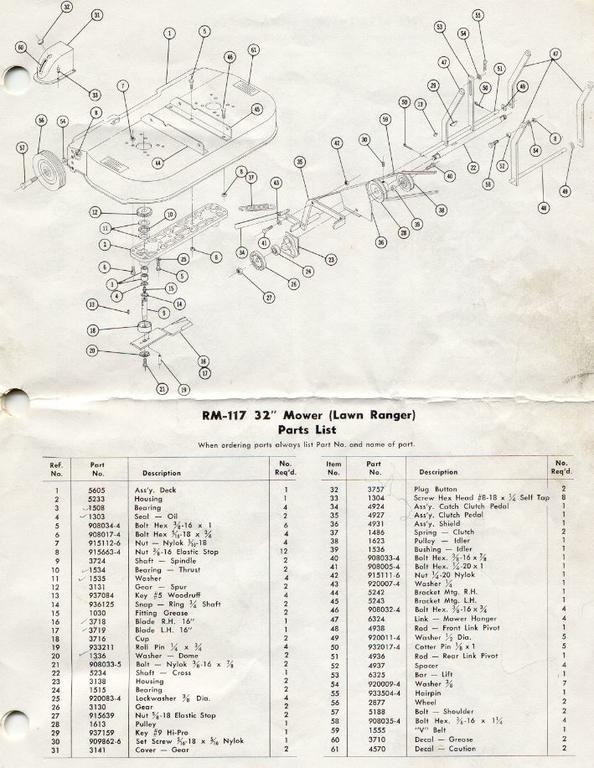

ol550 870 #5 Posted August 11, 2018 5 minutes ago, ol550 said: Keys are part #11 Share this post Link to post Share on other sites
MarkS 122 #6 Posted August 11, 2018 56 minutes ago, ol550 said: Keys are part #11 Thanks! Does anyone know what the dimensions of the key are. I want to try to find one local, so I can replace it tomorrow. Share this post Link to post Share on other sites

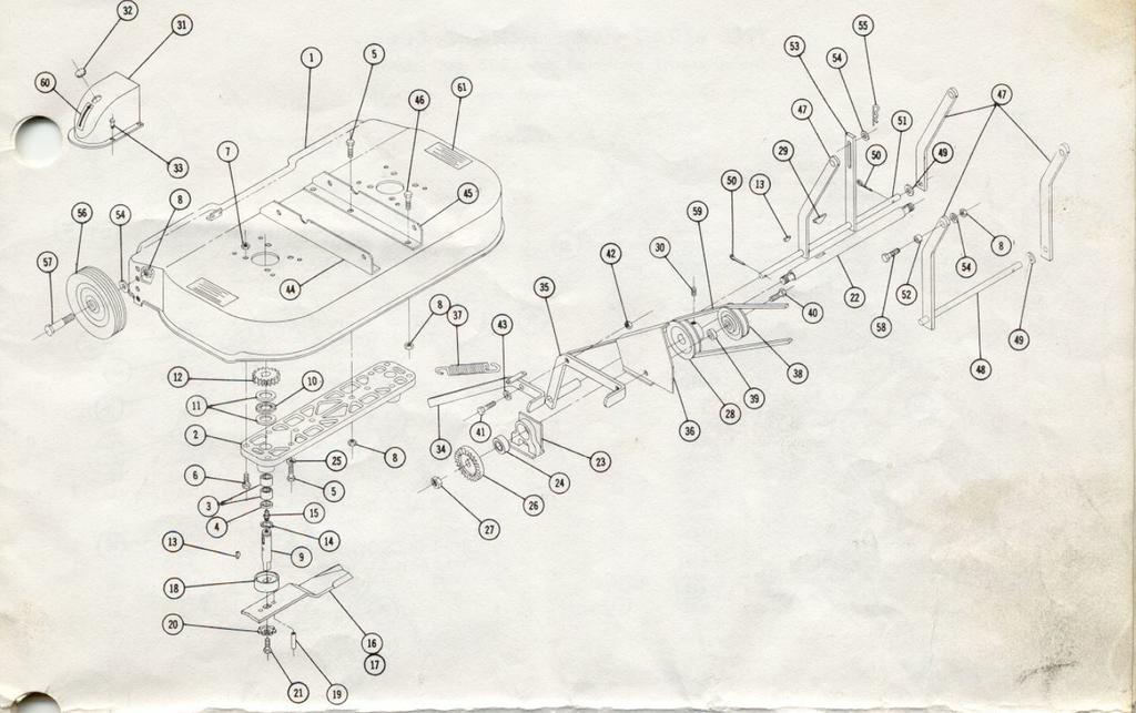

pfrederi 21,055 #7 Posted August 11, 2018 (edited) That is not the diagram for an Lawn Ranger Deck This is the correct one the Woodruff key is a #5 Edited August 11, 2018 by pfrederi Share this post Link to post Share on other sites

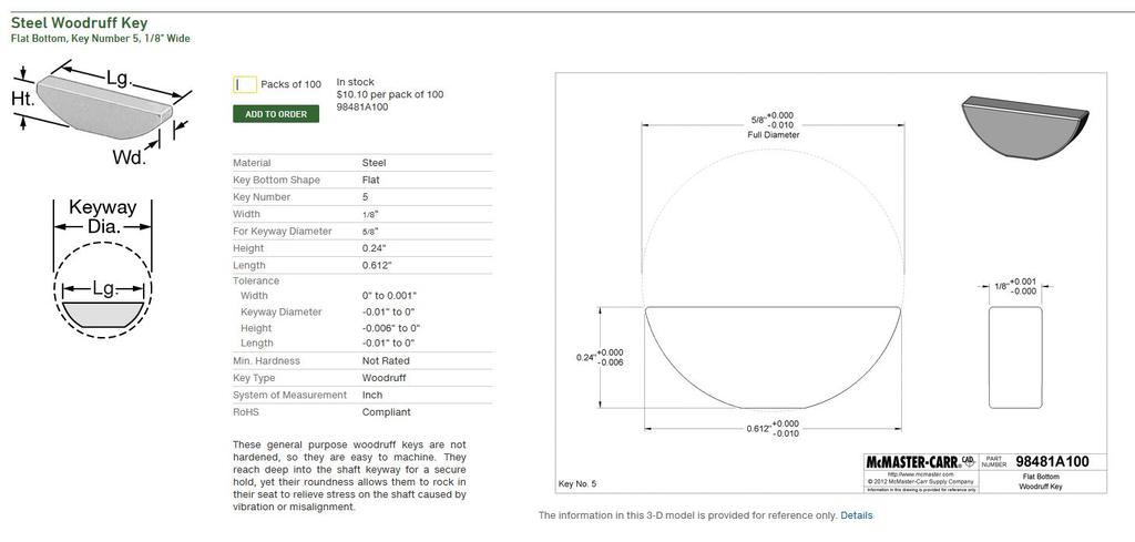

gwest_ca-(File Mod) 12,459 #8 Posted August 11, 2018 937084 is a #5 Woodruff key. Dimensions 1/8" x 5/8" but it will not be exactly 5/8" because that is the size of cutter that cuts the groove. The key will be .612" long. 5/8" = .625" Garry Share this post Link to post Share on other sites
