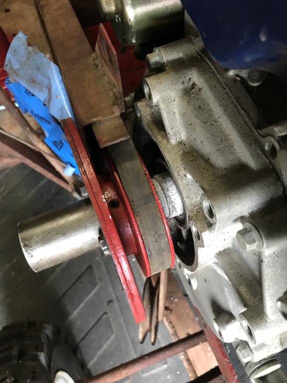

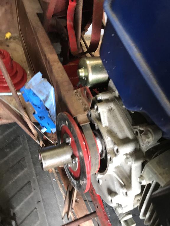

Jay1775 11 #1 Posted August 7, 2018 (edited) Hello all. last year I got a Raider 12 and it did not have a motor but it does have the PTO and it is complete. I do have a 11hp Greyhound motor used lightly I was going to throw in it for now and already have the shim for the PTO to fit on the shaft. I also built up the mounting plate to about an inch high to compensate the height of a K301 which originally came with the tractor. My question is, can anyone tell me how tight the belt should be with the new motor wether the clutch is depressed and when it is not? thanks for any help. Edited August 7, 2018 by Jay1775 Add pic Share this post Link to post Share on other sites

Jay1775 11 #6 Posted August 20, 2019 I know this post was a while ago however I figured I would let you know how I solved us the problem. Since the metal tap on the belt guard had already broken off, I used a roller bearing and placed a slot to adjust the bearing to the belt and it works like a champ. I will post photos hopefully later. Thanks again. 1 Share this post Link to post Share on other sites
