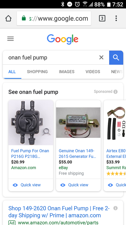

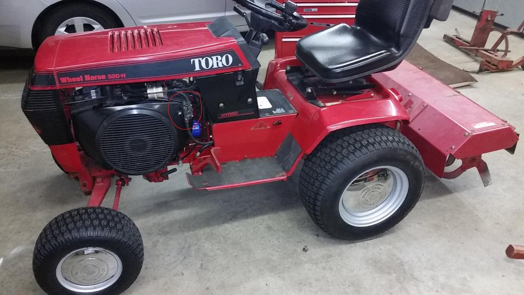

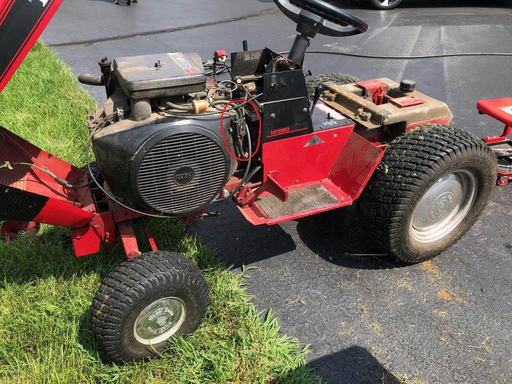

WHX?? 58,048 #6 Posted August 3, 2018 (edited) Some where in this computer I have a link to the OEM pumps but a lot of the fellas are going to electric ones. The OEM should have been mounted just above the oil filter on the shroud. A pulse line from the pump to the crankcase through a hole in the shroud. Pics are in order here, see if I can't find them. fuel pump circled in red https://www.ebay.com/itm/Vacuum-Fuel-Pump-For-149-1982-149-1544-149-2187-Cummins-Onan-Generator-Welder/282742282069?epid=1776923353&hash=item41d4c0d755%3Ag%3AON8AAOSwCMFaE~0A&_sacat=0&_nkw=onan+fuel+pump&_from=R40&rt=nc&_trksid=p2060353.m570.l1311.R1.TR6.TRC2.A0.H0.Xonan+fuel+pump.TRS0 Better One You will find more info in the manuals if you don't already have them. Edited August 3, 2018 by WHX20 Share this post Link to post Share on other sites

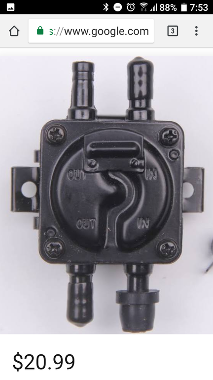

mikemc53 10 #11 Posted August 4, 2018 So the fuel pump (electric) is shot. Will not pump with power to it, at all. It was a replacement and someone had put it right over the spot where the pulse pump was. I haven't decided which way to go on replacement so I have a few questions. The pump that just died appeared to have been wired direct to the ignition - no fuse. It has, as does most electric pumps, one inlet and one outlet. If I replace it with an electric I will likely put it right where this one was but I will fuse the line. If I go with a pulse pump I am a little confused. I have seen them online and they seem to have two inlets and two outlets - not sure what to do with that. Also, the hole in the cover that goes to the crankcase, what would fit in there? I have worked on a smaller mechanical fuel pump on the C-81 but not familiar with these double line pumps. Share this post Link to post Share on other sites
pfrederi 21,145 #12 Posted August 4, 2018 The impluse pump has a fuel in fuel out and a line to the crankcase.The crankcase line carries the fluctuating crankcase air pressure to the pump diaphragm to make it work . The hole was probably for that line there wold be a fitting somewhere on the crankcase the line would attach to. (Hopefully plugged) Share this post Link to post Share on other sites
WVHillbilly520H 10,379 #13 Posted August 5, 2018 On the Onan, they look as though to have dual inlet/outlet but in reality they don't and as mentioned above on, the back of the block is the vacuum port for the crankcase to "pulse" the Reed valve to actuate the fuel flow, and Onan also has an electric version as well, Jeff. Share this post Link to post Share on other sites
