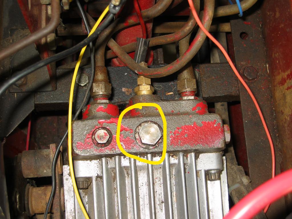

953 nut 68,782 #2 Posted August 3, 2018 If the lift works the pump is working. If it will back up OK the hydro motor is OK. Chances are the linkage or an internal valve (acceleration valve) is the culprit. Check out this manual and please let us know ho you do. 2 Share this post Link to post Share on other sites

pfrederi 21,095 #6 Posted September 26, 2018 Manual doesn't call for priming...but did you coat all the parts with oil before reassembly> Wouldn't hurt to open one of the ports on the top of the pump housing and pour in some oil. 2 Share this post Link to post Share on other sites

pfrederi 21,095 #8 Posted September 26, 2018 No the theory on coating is it seals them so they can suck fluid up through the system. I would pour oil into the pump run it for a minute then pour more in it will prime eventually...assuming the leak you mention is not extensive... Share this post Link to post Share on other sites
