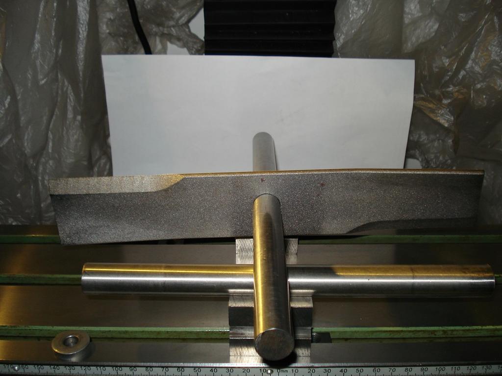

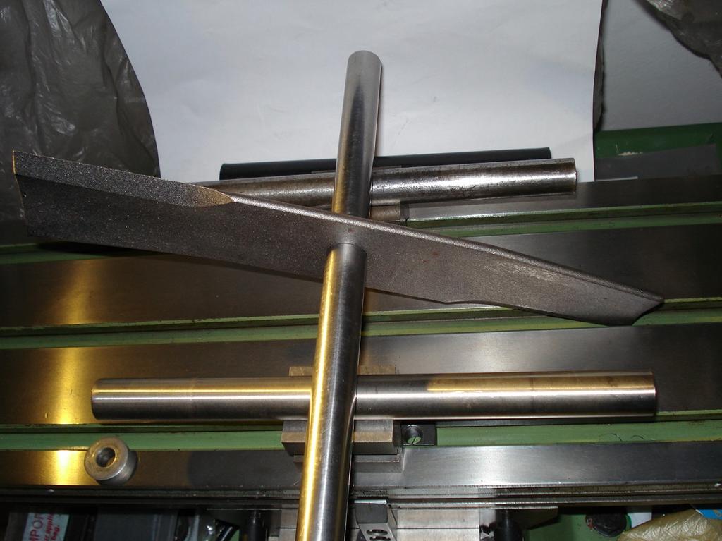

Anglo Traction 761 #5 Posted August 3, 2018 If you can find them, OEM Blades were what I went for (not easy where I am). One thing to do before fitting, is to check the balance. Even my OEM Wheel Horse blades were out and needed fettling- before- After- Share this post Link to post Share on other sites

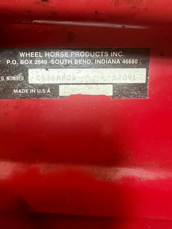

Wes P 2 #7 Posted June 4, 2023 On 8/2/2018 at 6:13 PM, gwest_ca said: 05-36MR03 This Deck and Tractor was purchased new in 1982. How could it be a 1985 Model? Wes Prater Share this post Link to post Share on other sites
gwest_ca-(File Mod) 12,451 #8 Posted June 6, 2023 What is the model number of the tractor? 1 Share this post Link to post Share on other sites
Wes P 2 #9 Posted June 6, 2023 The Model is a 310-8. I am a former District Sales Manager for Wheel Horse with responsibility for Oklahoma, Texas, Louisiana, Arkansas, Missouri and Kansas. This does not mean I am an expert on the products mechanically. In 1981 we had a special run of the 310-8 (steel rear fenders instead of the plastic fenders). I had my Dad buy this tractor at that time. I purchased the 3/4" spindle blades instead of the 5/8". I hope they work. Share this post Link to post Share on other sites
gwest_ca-(File Mod) 12,451 #10 Posted June 8, 2023 The information we have your 10hp tractor would be 1974-1977 C100-8speed with metal rear fender pan 1978-1979 C101-8speed with metal rear fender pan 1980-1984 C105-8speed with plastic rear fender pan 1985-1993 310-8speed with metal rear fender pan All the 36" rear discharge decks for the long frame tractors Mower DNA 1972 model 5-0620 replaced by 1973-1974 model 5-0621 1975 model 5-0622 1976 model 65-36XR01 1977 model 75-36XR01 1977 model 75-36XR02 1978 model 85-36MR01 1979 model 95-36MR00 (Blades up to this point have the 5/8" x 3/4" double-D center hole unless the spindle has been upgraded) --------------------------------------------------------------------------------------------------------------------------------------------------------------------------- (These decks used blades with a 3/4" center hole) 1979 model 95-36MR01 replaced by 1980-1982 model 05-36MR01 - Last year for bearings with 3/4" ID 1983-84 model 05-36MR02 - First year for bearings with 17mm ID unless older spindles were updated. 1985 model 05-36MR03 1986-1990 model 05-36MR04 1991-1993 model 05-36MR05 1993-2006 model 78305 1 Share this post Link to post Share on other sites
Wes P 2 #11 Posted June 8, 2023 gwest_ca above. It appears your information is correct! It looks like I am in good shape on the deck blades. In 1981, we had a special run of the 310-8. It was the first time we called the C-105-8 a 310-8. The 310-8 was specially priced. I believe it was approximately $2,100.00. in 1981 (I believe the C-105-8 was over $3,000.00). We reverted on the 310-8 back to the metal rear fender pan. It was a premonition of what was to come.At that time, there were really mixed opinions about the plastic fender pans. I worked for Wheel Horse for six years. This was the most fun I ever had working! I left Wheel Horse in 1983 to start a State Farm Insurance Agency. I regretted leaving when I left! I absolutely loved the company and I think they loved me! At that time, Wheel Horse was just a big family! I lost track of what was happening after that time. Toro took over shortly after. 1 Share this post Link to post Share on other sites
