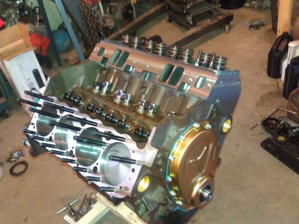

WVHillbilly520H 10,378 #13 Posted September 10, 2018 3 hours ago, Gmcgruther said: I'm usually building engines making 500 Horsepower to 950 plus Horsepower. That being said, is there afternarket connecting rods available and can the rotating assembly be balanced? I like my engine rotating assembly balance within half of a gram to quarter of a gram. A smooth running engine is always a happy engine. No, I don't plan on hot rodding this 10 Horsepower Kohler engine but I want my grand kids to say that my grandpa built that engine to last not to scream. Cool stuff like this aye? I dabble a little bit in that too. 2 Share this post Link to post Share on other sites
