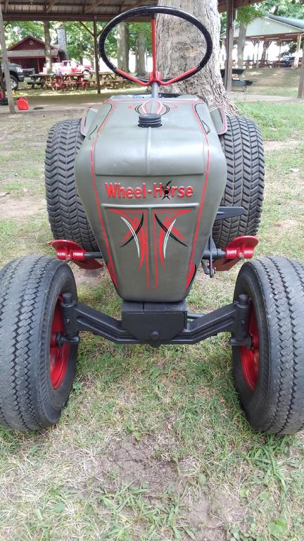

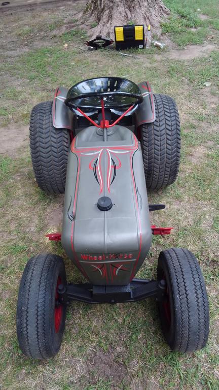

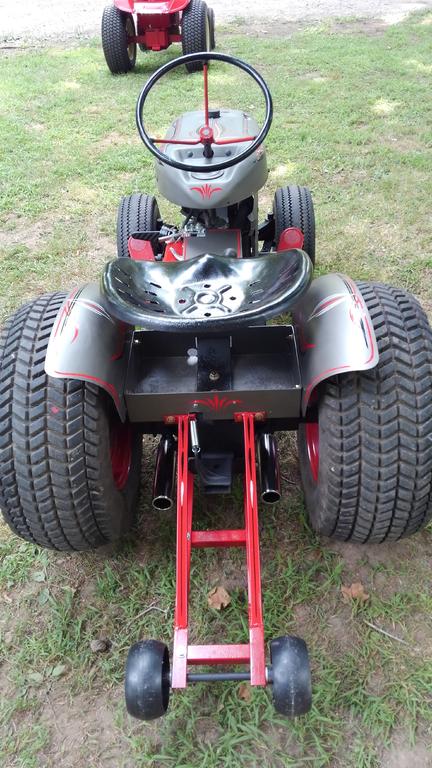

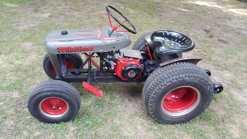

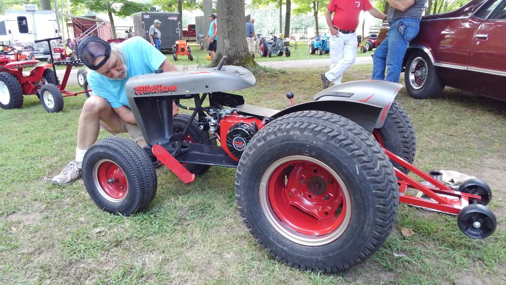

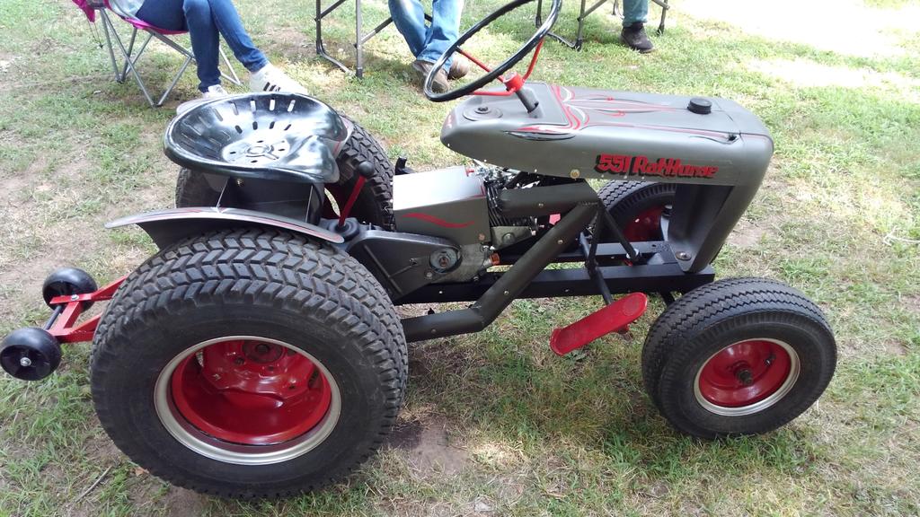

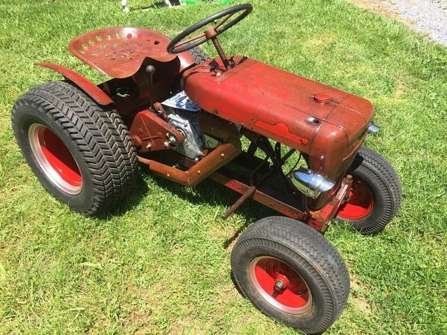

Tgtack 779 #1 Posted August 1, 2018 (edited) Thought I would share the latest work on the 551 Rat Horse. I picked this up from @dells68 at the PA show in June. It is a Rat Rod based on a 1961 model 551. It is powered with a 6.5 hp Predator engine. When I picked it up it was in a clear coat over rust. Pulled it apart and sandblasted it and repainted in flat black with blasted cast iron sheet metal. Repaired the head stand and restored it to it's original upright orientation which allowed the hood and fuel tank to mount in their original positions. Shortened the steering shaft to mount a three spoke deep dish lawn ranger steering wheel (hub bored to 3/4" dia), and shortened the shift lever. Fabricated a heat shield to cover the top of the engine and direct the hot air from the blower housing away from your right leg, and installed the Predator performance intake and carb jet. This past weekend it was pin striped by Rudy (out of Sandusky) at the New London Ohio FARM show. Am contemplating installing a flipped front axle to drop the front, and may drop the trans mount to lower the whole tractor, and replacing the black wheelie bar rollers with a new pair of red hub WH deck wheels. This fall will get a custom fabricated polished stainless steel exhaust pipe and muffler and a set of retro headlights. Looks a lot different from when it came home in June! Edited August 1, 2018 by Tgtack 11 10 Share this post Link to post Share on other sites
dells68 7,499 #2 Posted August 1, 2018 Glad you got this little guy Tim. It's nice to see someone else put their own twist on it. Very nice job!! 4 Share this post Link to post Share on other sites

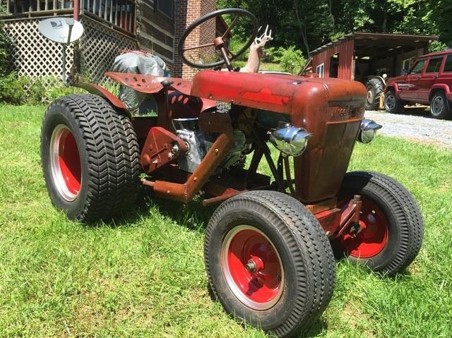

Achto 29,806 #5 Posted August 1, 2018 Looking awesome!!! The stripping is an excellent touch. 8 hours ago, Tgtack said: Am contemplating installing a flipped front axle to drop the front Here is one idea for dropping the front end. This method gave about a 3" drop on my Suburban. 9 1 Share this post Link to post Share on other sites
