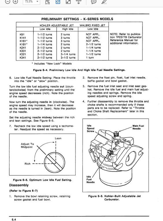

pfrederi 21,300 #3 Posted July 31, 2018 Here are the settings Carb cleaning has different meanings. To some spraying some stuff into the carb means cleaning. In reality you have to take it off the engine disassemble it and soak it. 1 Share this post Link to post Share on other sites
TC10284 124 #4 Posted August 1, 2018 1 hour ago, pfrederi said: Here are the settings Carb cleaning has different meanings. To some spraying some stuff into the carb means cleaning. In reality you have to take it off the engine disassemble it and soak it. Sorry - By this, I mean the carb was removed, all parts taken out of it, all jets blown, sprayed down with carb cleaner. I remember the float was stuck but it isn't anymore. Only other thing to be done in regard to cleaning is letting it soak. Share this post Link to post Share on other sites

pfrederi 21,300 #9 Posted August 1, 2018 Lacking a gasket is a big thing. Lots of air gets sucked in and leans out the mixture. Do you have a Kohler carb or a Walbro Fixed jet. You could make a quick gasket and see if that helps things. Use gasket material or a manila folder...NOT RTV silicone. 1 Share this post Link to post Share on other sites
TC10284 124 #10 Posted August 1, 2018 (edited) 12 hours ago, pfrederi said: Lacking a gasket is a big thing. Lots of air gets sucked in and leans out the mixture. Do you have a Kohler carb or a Walbro Fixed jet. You could make a quick gasket and see if that helps things. Use gasket material or a manila folder...NOT RTV silicone. It is a walbro. Here's a pic. It didn't come with one. I need to order one. There are three screws I can adjust. Edited August 2, 2018 by TC10284 Share this post Link to post Share on other sites
